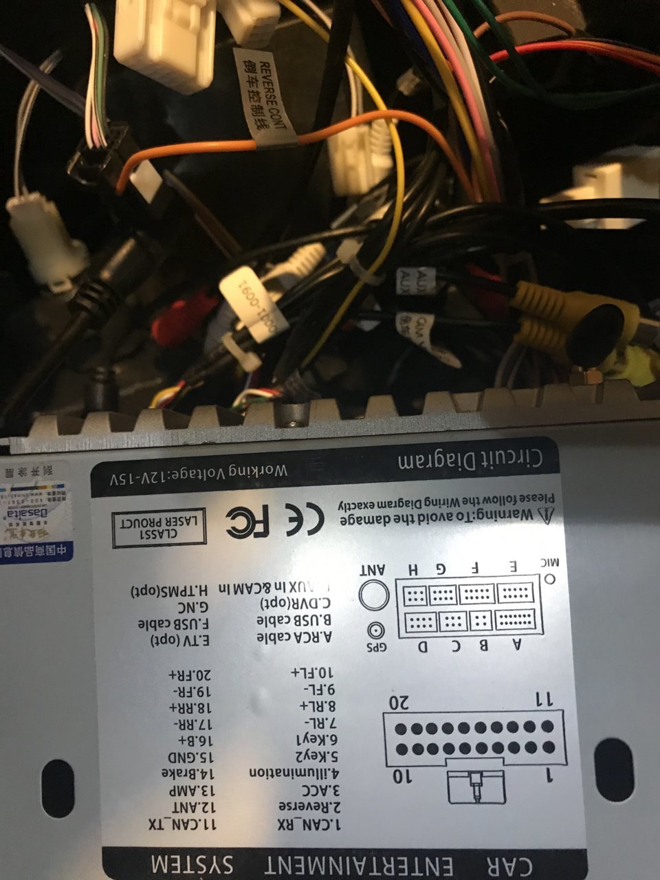

    So I have this wire that was capped off:
    Do i splice this into #2 on the canbus harness ?

    @minter66 is the capped off wire from the canbus harness? Can you test that wire to see if there is voltage when it is in reverse. If there is voltage, I think that will be your rear view power cable.
    I’m not 100% sure but just my recommendation.

    @minter66 or it could be that you need to splice a reverse cable from factory harness to that capped off wire so that HU knows when it’s in reverse.

    Well that was ridiculous. Had to pull passenger side kick panel to tap into blue wire of bottom most white plug, run small wire to orange reverse cont wire and now it works.
    So.Many.Wires
    Thanks for your help
