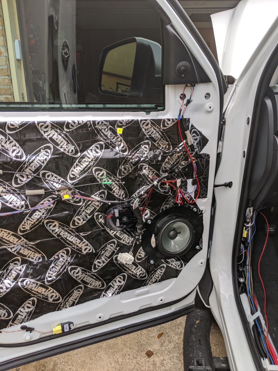

    A couple days ago I put the c2 650s in the front and c1 650s in the back doors. The clarity is incredible. I think you'll enjoy it :thumbsup:

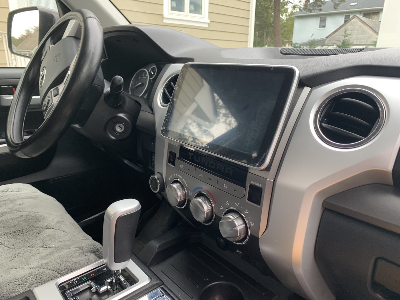

    Finally got it installed! Some issues with mic, external one was causing it so I disconnected it, so far they can hear me . It’s sounds really good with my speakers and dynaudio tweeters. Also add USB’s and Factory one as well 6E843474-4647-4310-9EFE-8FB85C9E10B4.jpg

    JL C1-650 components installed. Running on stock amp for a couple days. All I have to say is freaking wow. What a difference. Cant wait to hear it with the amp and subs installed.
