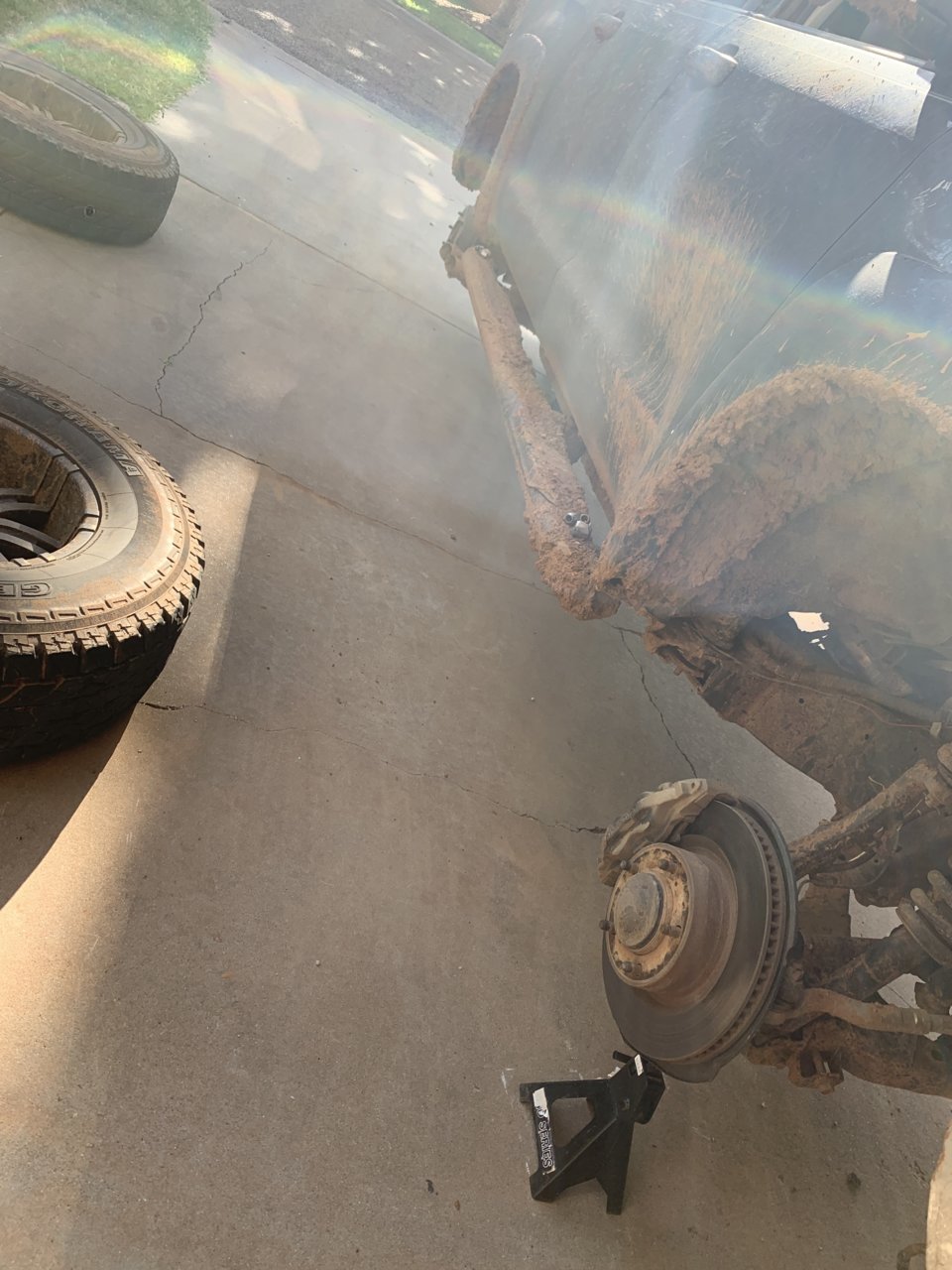

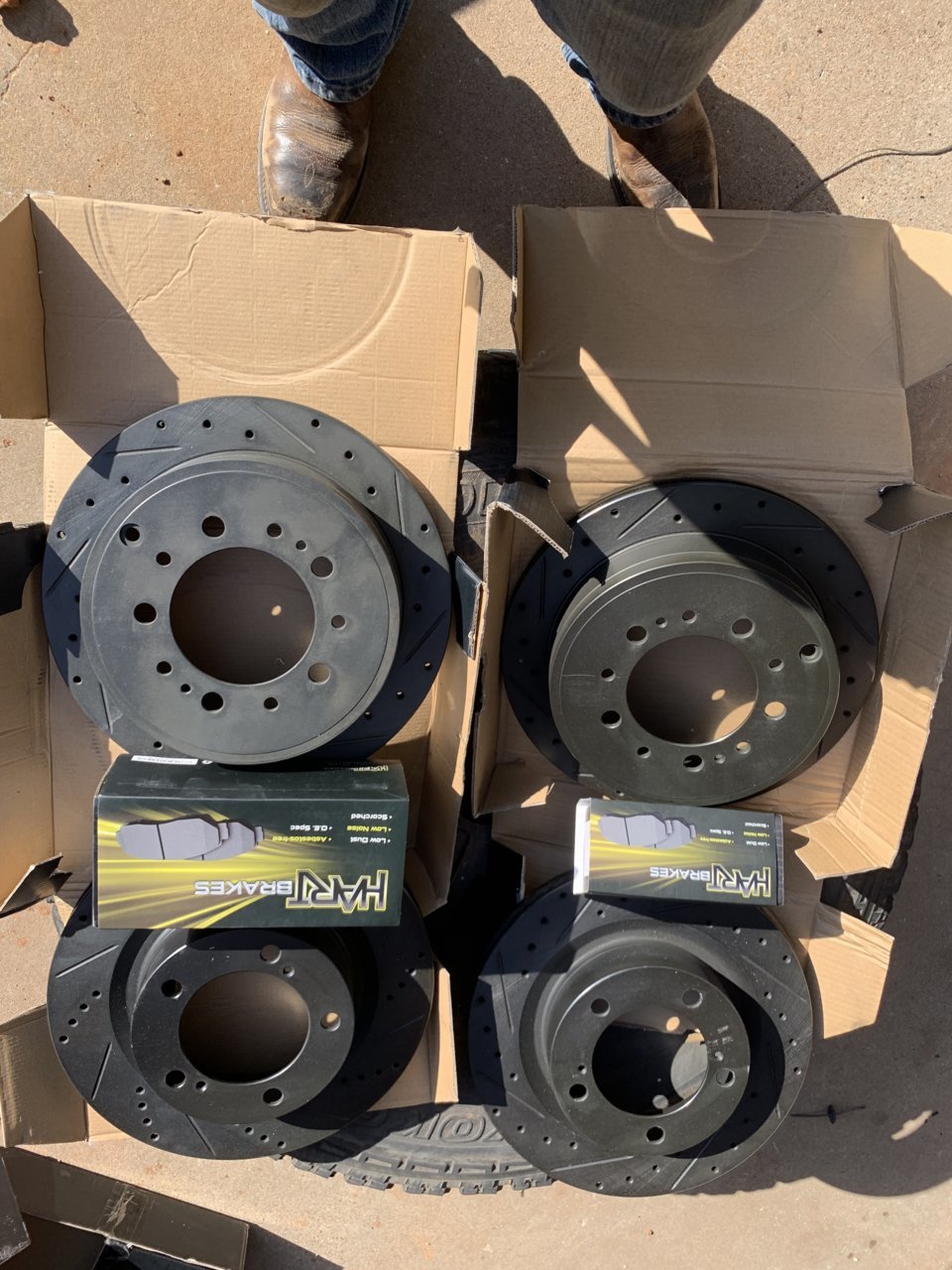

    Okay so hart brake kit is installed. Honestly for the price I’m impressed. I can’t tell you exactly but there was very little difference in the rotors
    For my records the mileage they got put on
    Unknown the brand and now I can’t find them but they were brand new when I got the truck roughly 60k ago
    Old stuff coming off (even with the mud this job wasn’t bad)
    Here’s the kit
    Came with shims but no springs or anything
    Everything on the driver front
    Don’t have a way to measure but the Hart’s were thicker by a little probably just wear on the original since they did have 137k on them bitC663650D-7560-4C48-900F-074CD0C992A5.jpg

    Driving felt the same no gain or loss in stopping power except at full brake that was significantly better
