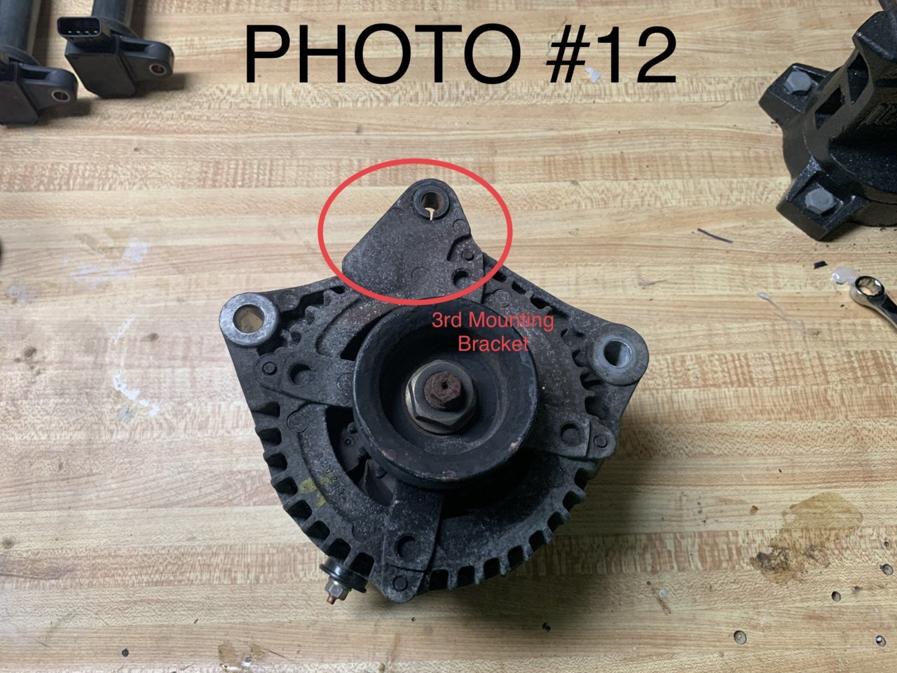

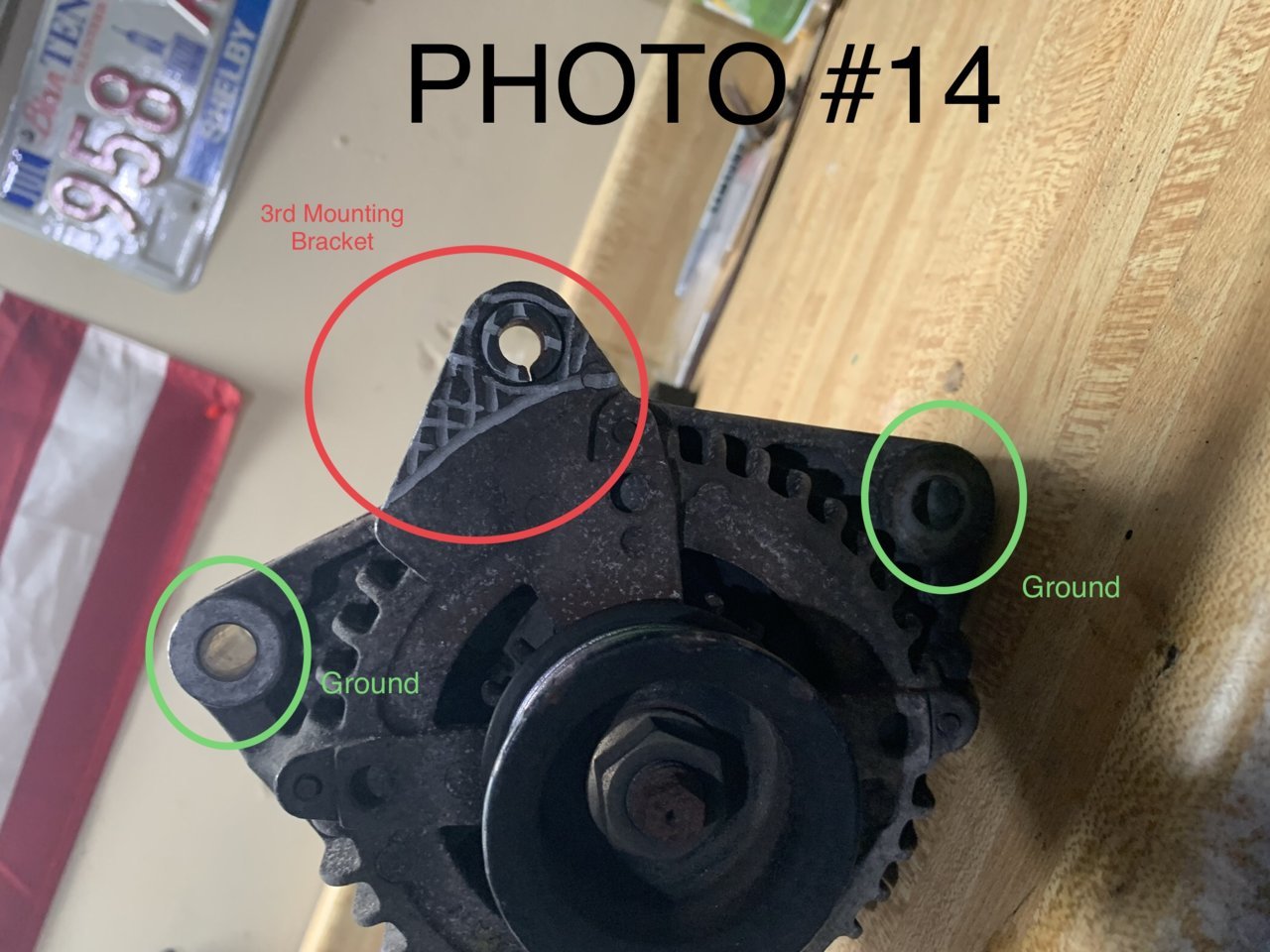

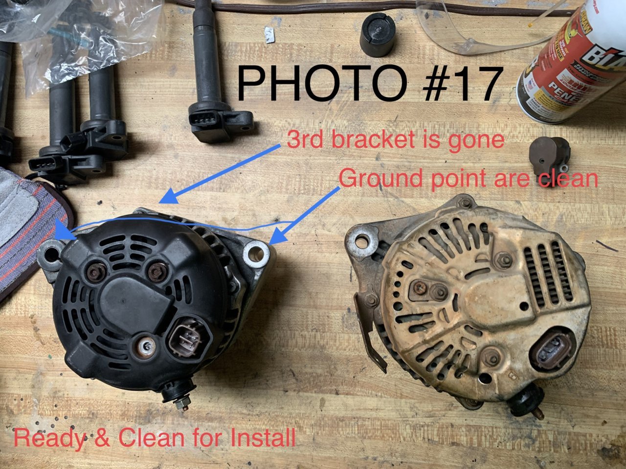

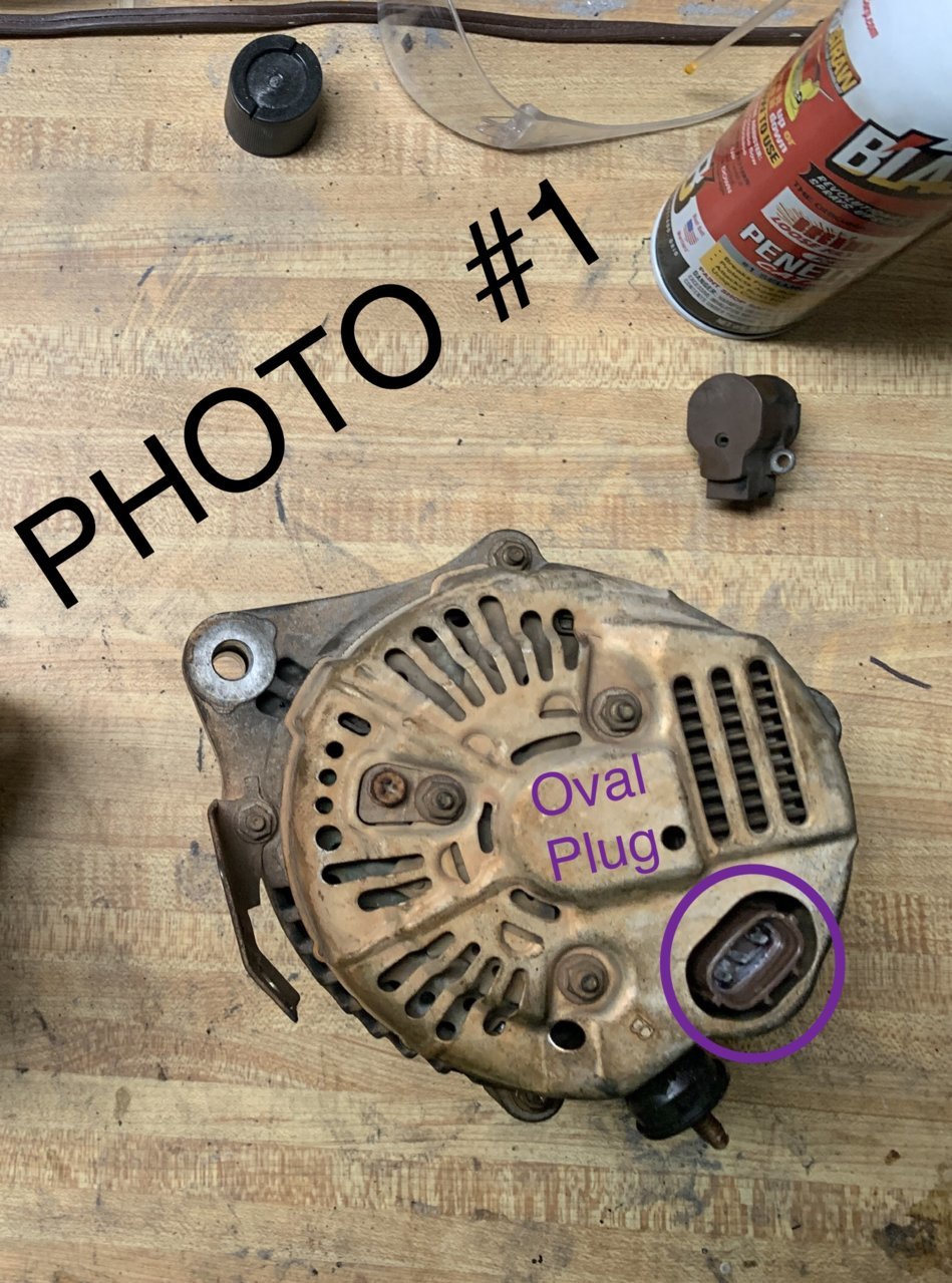

    According to the "big 3" post, yes. If you have the right tools, Dave's right, it's a no-brainer. But if not, I guarantee you'll be sinking an extra 20-30min into taking this ear off. If you don't have a band saw, you might be able to use a jigsaw w/bi-metal blade or cutoff wheel, but that's pretty tedious.
    Big3 post shows the oval connector'd alternator has 2 ears - note the ear directly across from the power post & oval plug, and the absence of one in between those two on the left right half: https://www.tundras.com/attachments...3/?temp_hash=9e892dd16715aba6074ef4858a3def96
    My 100A has three ears: https://tnstatic.net/attachments/upload_2022-1-30_21-7-39-jpg.693605/
    This is the ear you need to cut off: https://www.tundras.com/attachments...8/?temp_hash=9e892dd16715aba6074ef4858a3def96
    Alternate shot from the other side: https://www.tundras.com/attachments...4/?temp_hash=9e892dd16715aba6074ef4858a3def96
    Shot of what needs to be cut and how: https://www.tundras.com/attachments...0/?temp_hash=9e892dd16715aba6074ef4858a3def96
    Shot of it once it's cut off: https://www.tundras.com/attachments...8/?temp_hash=9e892dd16715aba6074ef4858a3def96

    @shifty` @daveeasa see the above quotes. I may not need to lop that ear off after all. Wonder if I could find an OEM stud for that hole.
    Also, Dave. In plain English: "Please send me an OEM 4 pin connector so I can repin my harness."
    Can anyone with a 2003 or newer tundra post up a similar picture of the alternator like I found in that quote?

    I'll try to get a picture of it on the truck but here's a 130a and 150a side by side if it helps.

    Yeah, I remember reading it may not be necessary and I'm not even sure if Jason lopped or didn't lop, I wasn't around whenever he put it in and I didn't get a good visual the couple of times I looked closer at it.

    That does help a little bit! Thanks! I've been screening youboob videos to see how the third ear is supposed to look. These are the "best" shots that I've found so far from a Double cab.
    Here's another screen grab from right before removal.
    Post removal, prior install. 3 mounting points. 3rd ear is stud with nut.
    Mid-Install.
    I think I could just stuff a long bolt in there with washers as spacers behind the ear. I'd really rather have that stud, and nut though...

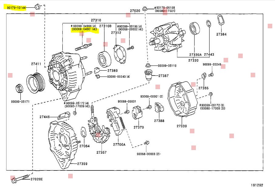

    I might have found one website I can use on the company pewter. Here's a link to what all these images are from. EDIT: This is a link to a 2006 Toyota Sequoia SR-5 4WD parts diagram.
    I've highlighted what I believe to be the correct parts.
    We'll start with the easiest to decipher. The nut flange. Part #: 90179-10144. Replaced by Nut Flange - Toyota (90178-A0089)
    Next is the stud... Part #: 90068-04001. Replaced by Bolt - Toyota (90068-04019). Not 100% sure thats the right stud/bolt combo.

    It's a one-piece unit, like a bolt with a nut in the middle, typical for accessory/belt kits on blocks. Used to deal with these a lot switching between different accessory setups on LS swaps, typically short end goes into the block. I agree, the diagram is weird. Here's the one from my 2006, it shows 90068-04019 (90068-04001 is the old part). It's a spendy ass bolt, and the nut appears to be 90179-10144 :

    I'll give an order to Serra/McGeorge, and see if its right when it gets here. Time will tell. I'd like to figure out what is the correct one so I can add this info to the Big 3 upgrade thread.

    Just placed an order from McGeorge for Nut Flange 90178-A0089 ($1.97), and Bolt 90068-04019 ($12.80). Total with economy shipping was $25.91.

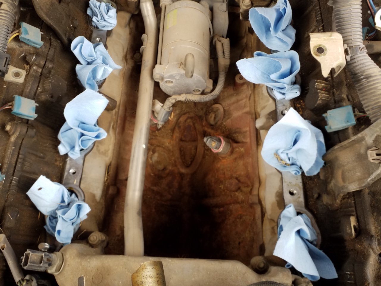

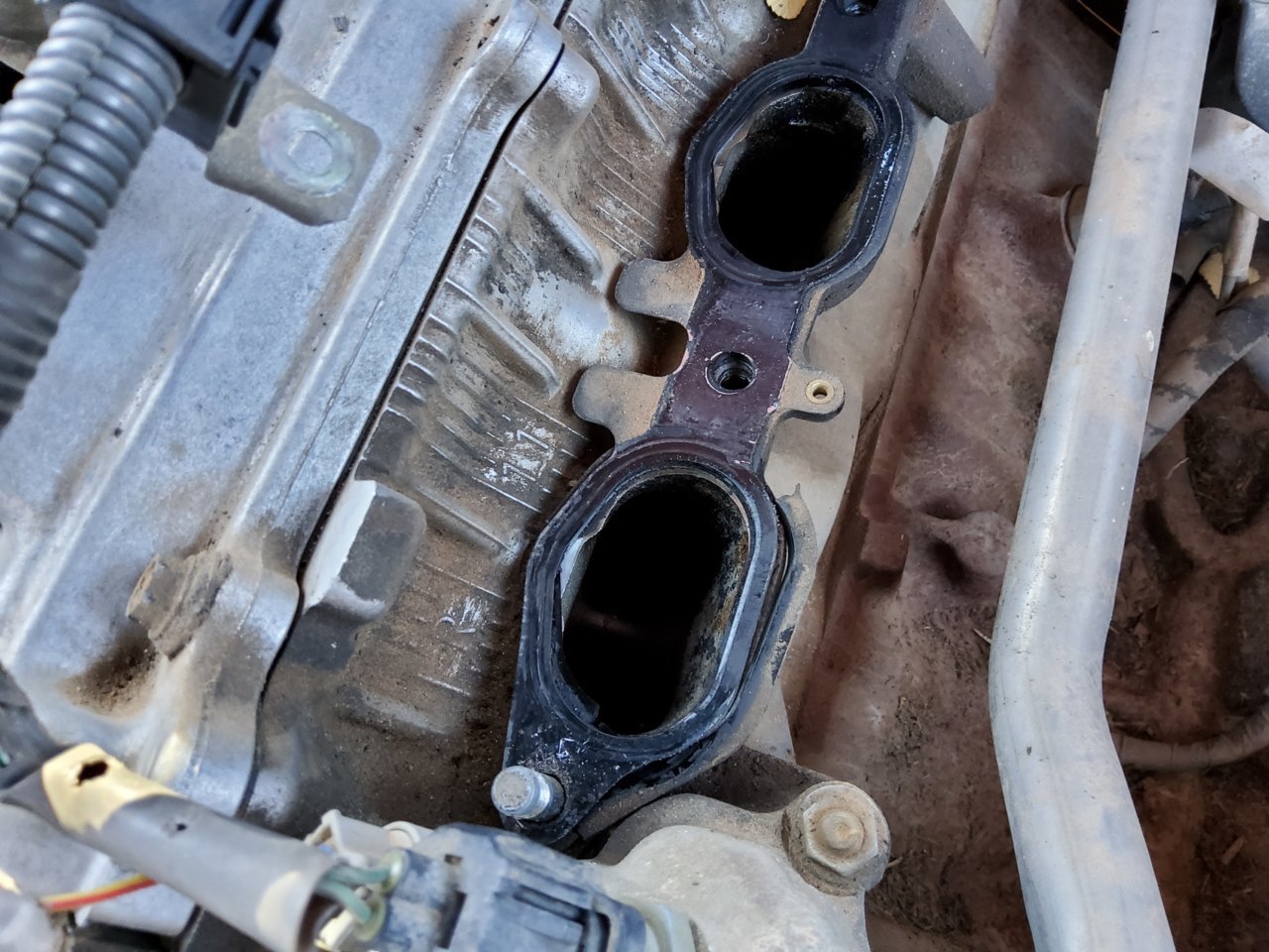

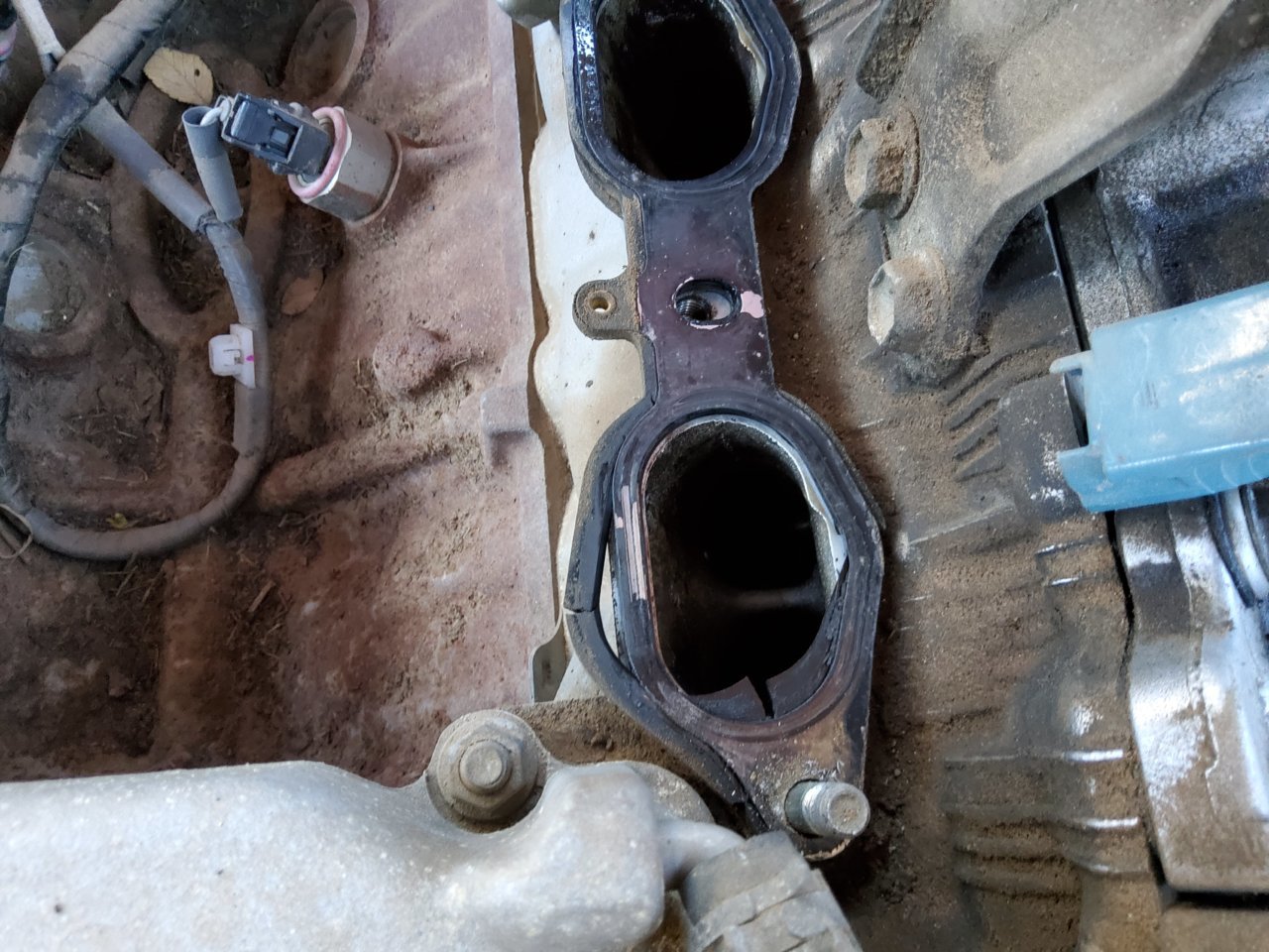

    After looking at pictures of my engine block with everything off of it... I'm drawing a blank at what that stud/bolt is for other than mounting the alternator... I don't see a seam like it's holding anything on there, or keeping a seal in place...
    Possible seam above the bottom blue line...
