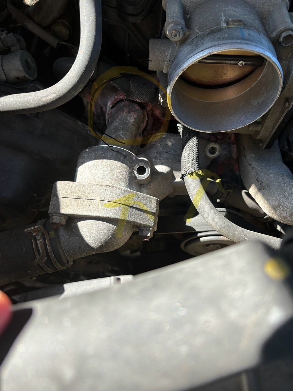

    Anyone know if there's more than 2 bolts holding the bypass pipe housing on behind the t-stat housing? I'm trying to get to the o-ring, thanks in advance.

    There shouldnt be, but there should be gasket maker/FIPG as well, so its likely "glued in" by that. Speaking from experience with my 1UZ.

    Two bolts, one long one and one short one. Just did this today. Thought it was my water pump so did pump and timing belt, but ended up being just the o-ring on the bypass pipe (through the valley). What was odd is that it wasn't leaking out the back of the valley (near transmission) like most people report. It was leaking down the side of the block behind the alternator. As such I thought it was the pump seal... but it was just the bypass o-ring. :-(

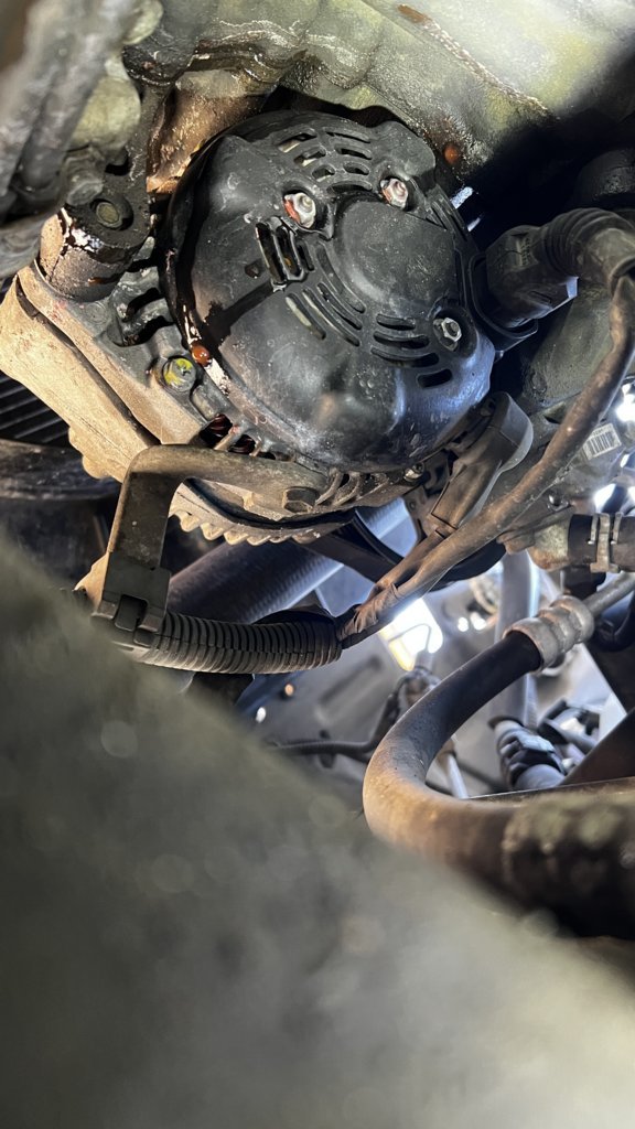

    I think that's what's going on with mine. Was able to trace the leak to the backside of the thermostat housing. Coolant on the backside of alternator as well.
