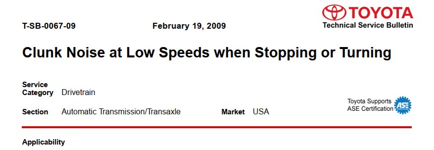

    • Driveline "clunks" when stopping and going: For 4WD trucks, you probably aren't lubing your driveline every 5k-10k miles as needed, see this reply (PS - this zerk requires special attention, see reply #4). For later-year 2WD trucks, there's a TSB out, the tranny crossmember can crack over time, then bolts loosen & fall out. Typical symptoms are clunks when turning, stopping, going. There's a specific TSB for the 2WD tranny mount problem, but it calls for replacing the crossmember, which many think is overkill unless clearly cracked (example here). If not cracked, retightening with a non-permanent thread sealer has worked.
    Looking at that TSB for 2WD, while it's focused on later years, it's worth looking at your crossmember - but I suspect your problem is your rack bushings:
