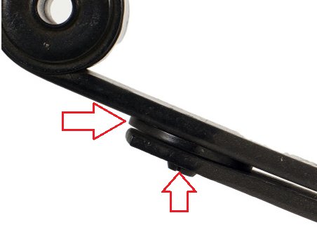

    I did not. This was the answer. While I had the leafs (leaves?) separated I took a putty knife and put some moly grease between the leafs too. Popping is gone. Thank you!

    Your OEM leaf springs should have little keyed plastic spacers between each leaf. I can get the part number if you need it. Are yours missing? These things, like a plastic circle with a round nub in the center that seats it in the spring. Supposed to cut down on rub and clank.

    Yes, I replaced these with some that I 3d printed, but I think the material I used was too soft. When I greased between my leafs, I also replaced these again with these Dorman 924-070 https://www.amazon.com/dp/B00C1CECGS. Not sure if the grease did it or the new silencers…but I’m happy. I did notice that one of my leafs was was kind of out of line with the others, but I do have the leaf spring rebound clips and they look in tact and in good shape.
