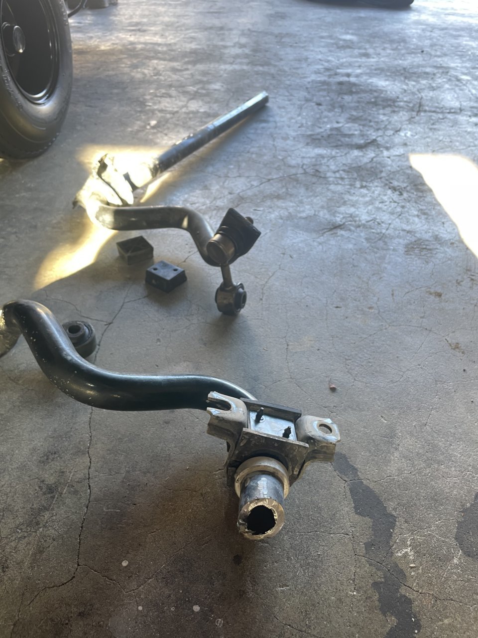

    I had a clunk and it turned out to be the sway bar. Removed it, clunk gone.
