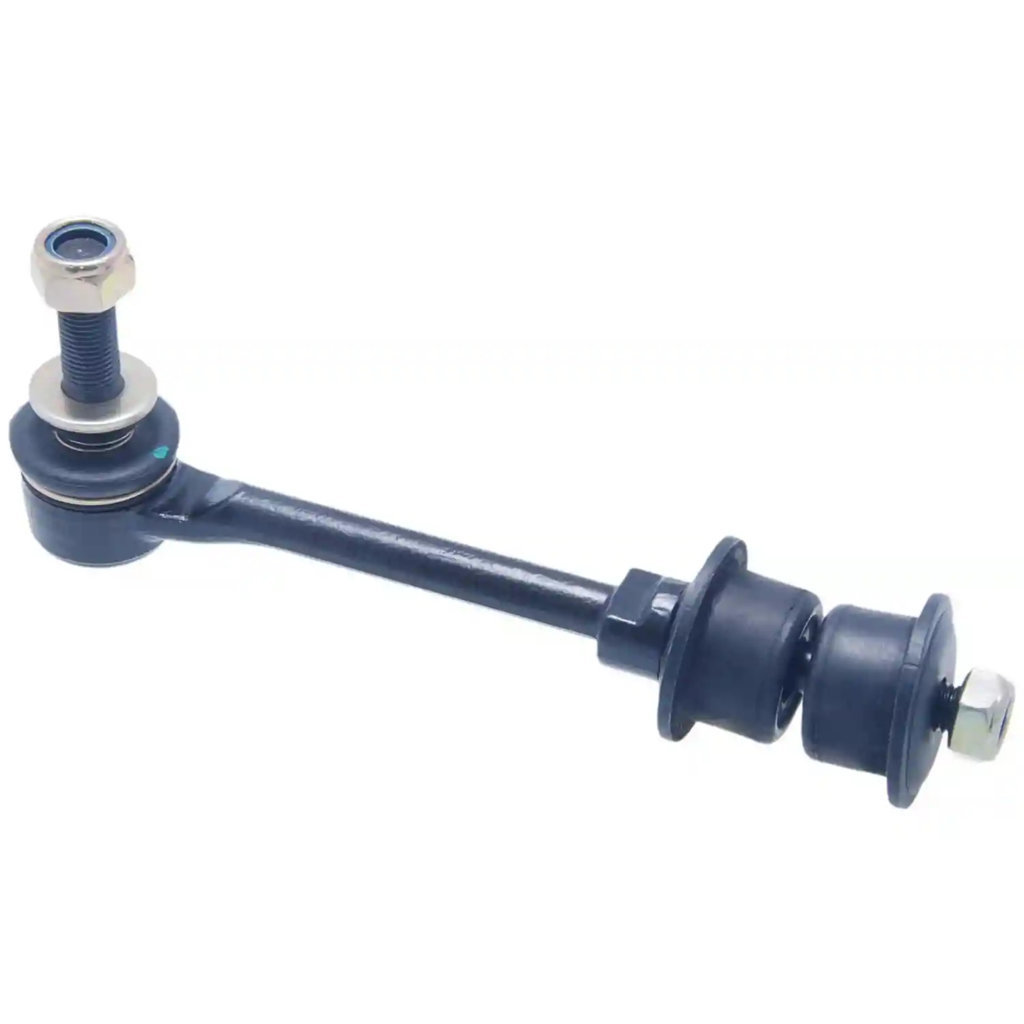

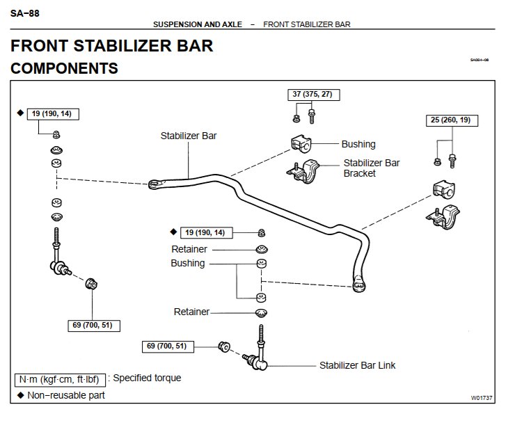

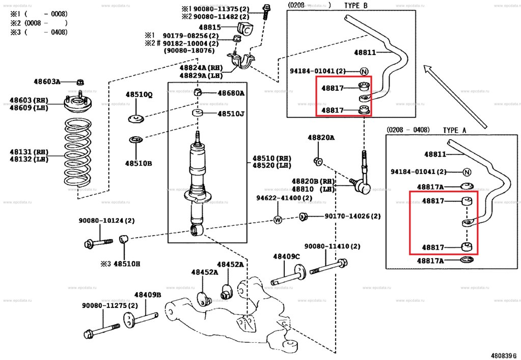

    Thanks for the help. I’m having a hard time using the EPC. I have read the howto several times and I still struggle with the finding the right parts. I think the Toyota parts catalog system is super outdated and needs an overhaul.
    I found that page by searching google images for a correct match and used the part number to find the lowest price on the autoparts.toyota website.
    So I just need to buy the top and bottom sway bar bushings parts 48817-0C010 for both sides a total of 4?

    If you just want to replace the rubber bushings, yep. I believe there are 4 total.
    EPC navigation isn’t “easy”. But it helps if you just think, “which of the 4 logical categories would it be in?” And click the category. Then either use the pictures or the words to guess the right spot. Most things can be found within two levels of clicking. Bigger category, then smaller category. Some parts like fuel delivery components can be a bear. But most are pretty straightforward.

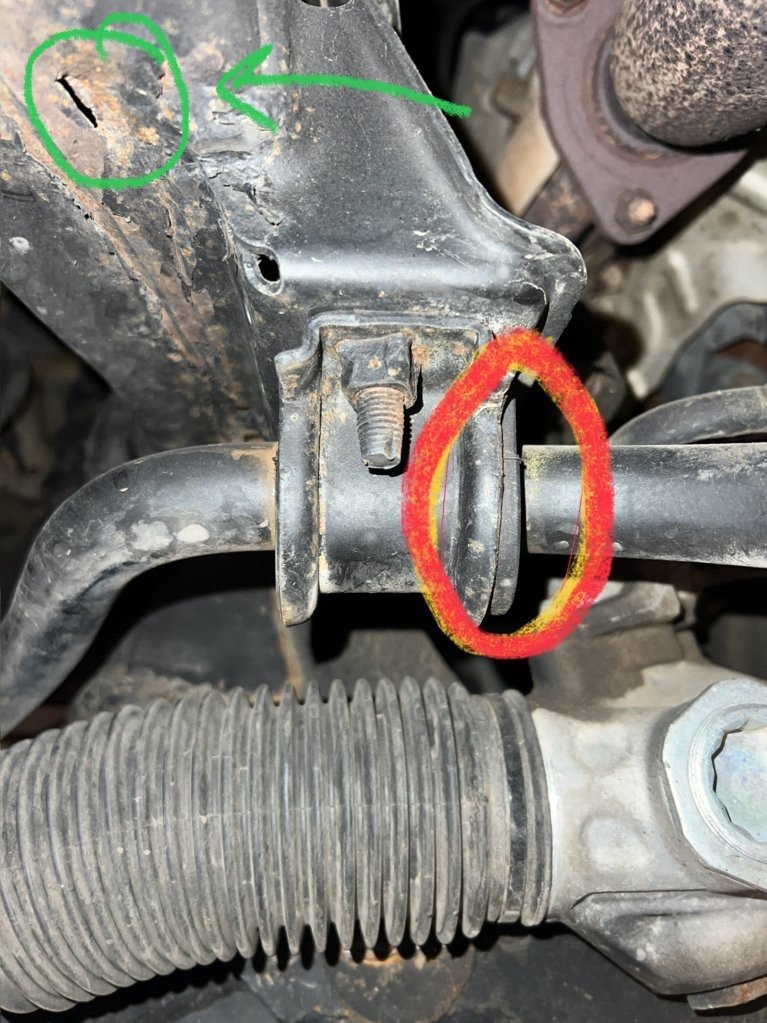

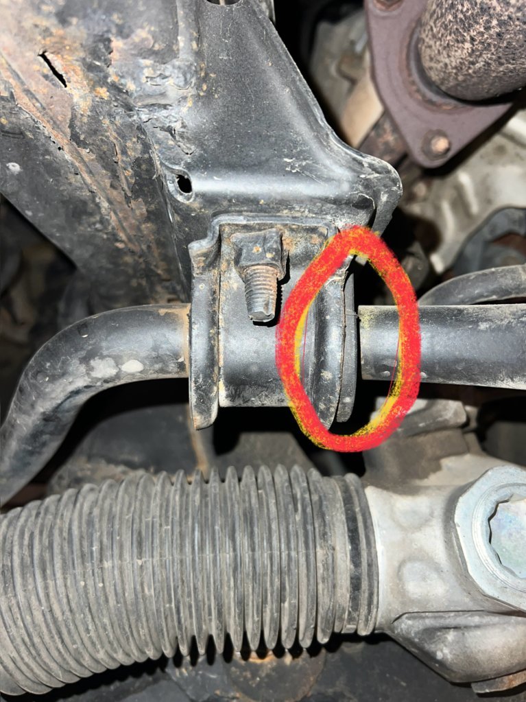

    It also looks like one of my stabilizing bushing for my sway bar is not centered. Should I just loosen the two bolts and recenter?

    Come again?
    You should never need to replace the entire swaybar, unless it's rotten.
    For the links, same as anything else - got play? If you unbolt the top bolt from the swaybar (ideally with truck on the ground or jacked up just enough so there's no tension on that top nut), the swaybar link shouldn't just flop around, if you jiggle by hand, it shouldn't show signs of play or rattle, threads should look OK, link shouldn't appear bent, and it shouldn't feel crunchy or gravely when pivoting the link around.

    Couple things. What’s up with this and how much more is there? Is the rest of the frame in good condition?
    And these struts are trash. Trash springs and low quality shock with poor dampening characteristics. The loaded billies are a good plan. You’ll get new springs and quality dampeners.

    That’s a good eye, I didn’t see that at all. After the ground dries, I will spend some time underneath to examine and thoroughly examine the frame. This truck was a gift from my Dad. Since he has been working on cars for 50+ years I made a bad assumption about its health.

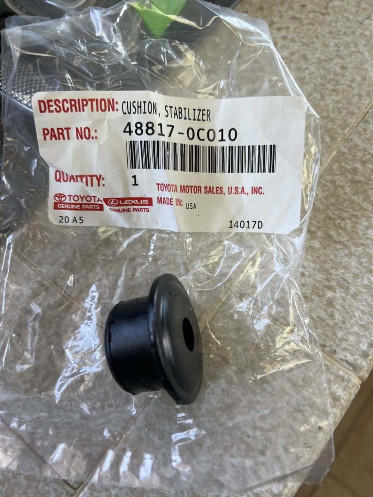

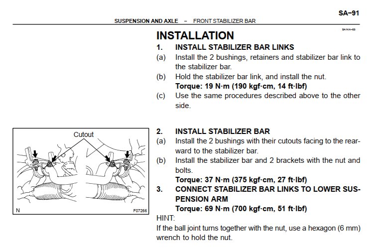

    Yes the struts are pre assembled. I have a 3/8 craftsman torque wrench, but it only goes to 75 foot pounds. I’ve been watching numerous videos on Removing and installing the front and rear.

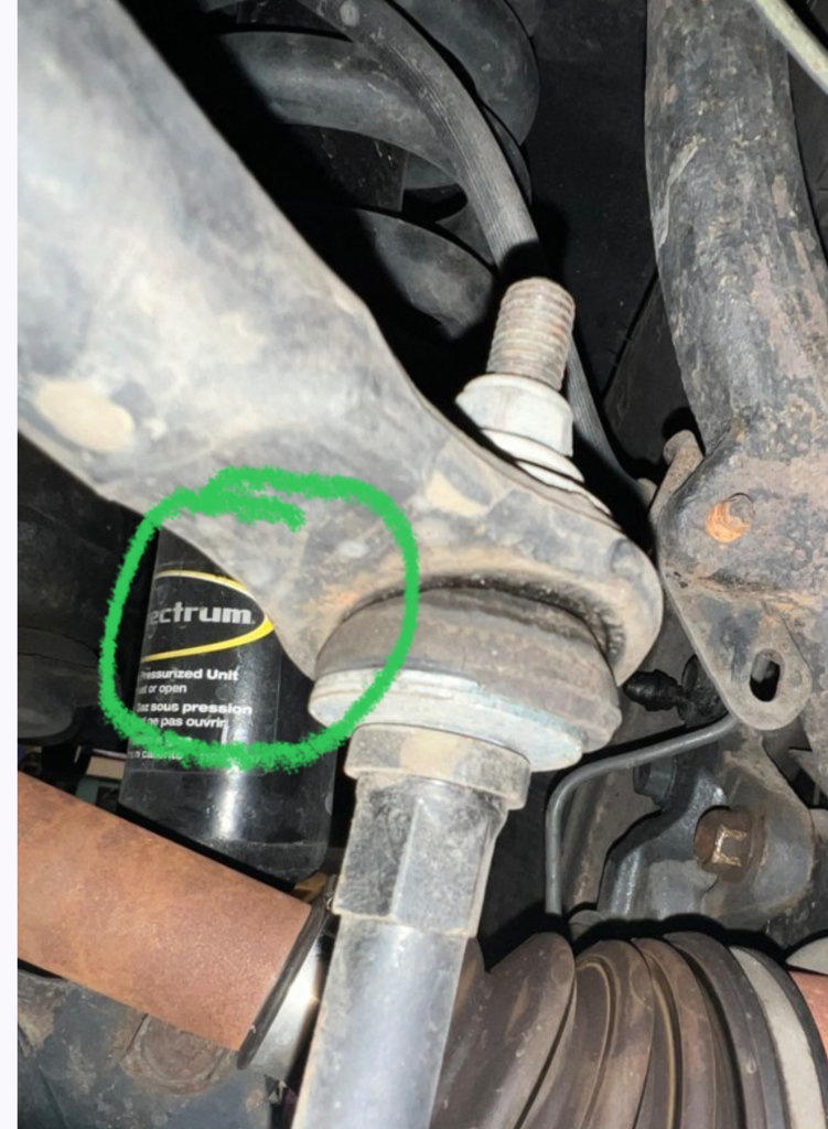

    I picked up the end link bushings from Toyota. For some reason they don’t look like the same ones as stock.
  26. Feb 20, 2025 at 12:46 PM
    #56

    Sorry if this is a little off topic, and maybe OP has already solved the problem, but could there be a wheel bearing issue that doesn't show play?

    Those are the right ones, perhaps your "stock" ones had been replaced before? Orientation is as below

    I agree, thanks for the picture. Are the washers missing on the photo?

    Yes
