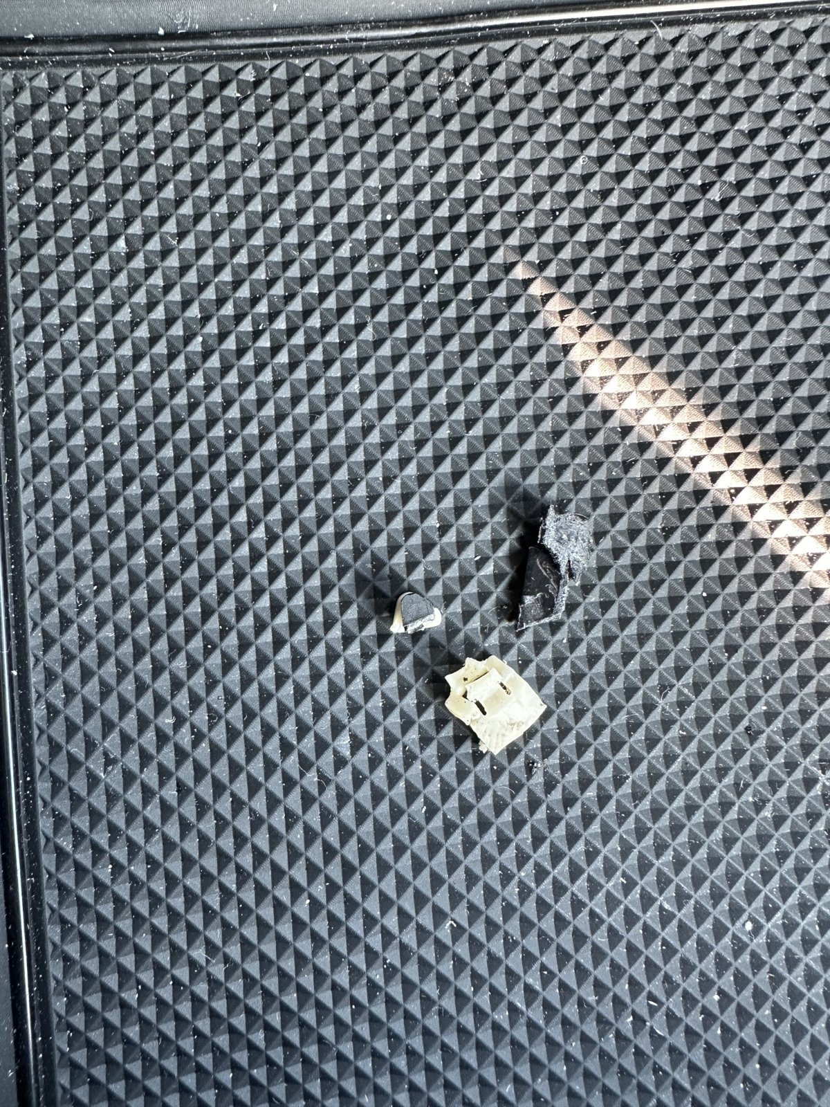

    There is definitely a metal clip that fits into the roof tab….here is the clip after it was cut from the tab…good luck hope they solved the issue. IMG_1879.jpg

    The noise “appears” to be the clip or glue shrinking in cold weather and rubbing I side the tab.
    In order to bend the tab, you must first cut off the clip. (The tab holds the clip that is glued to the windshield)

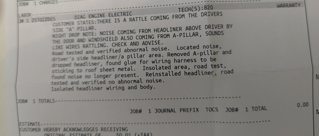

    ***UPDATE*** My truck went in to the dealer this morning. I got a call about three hours later saying it was finished. NO MORE NOISE!!!! Looks liked they added some insulation according to the invoice, as shown below.
