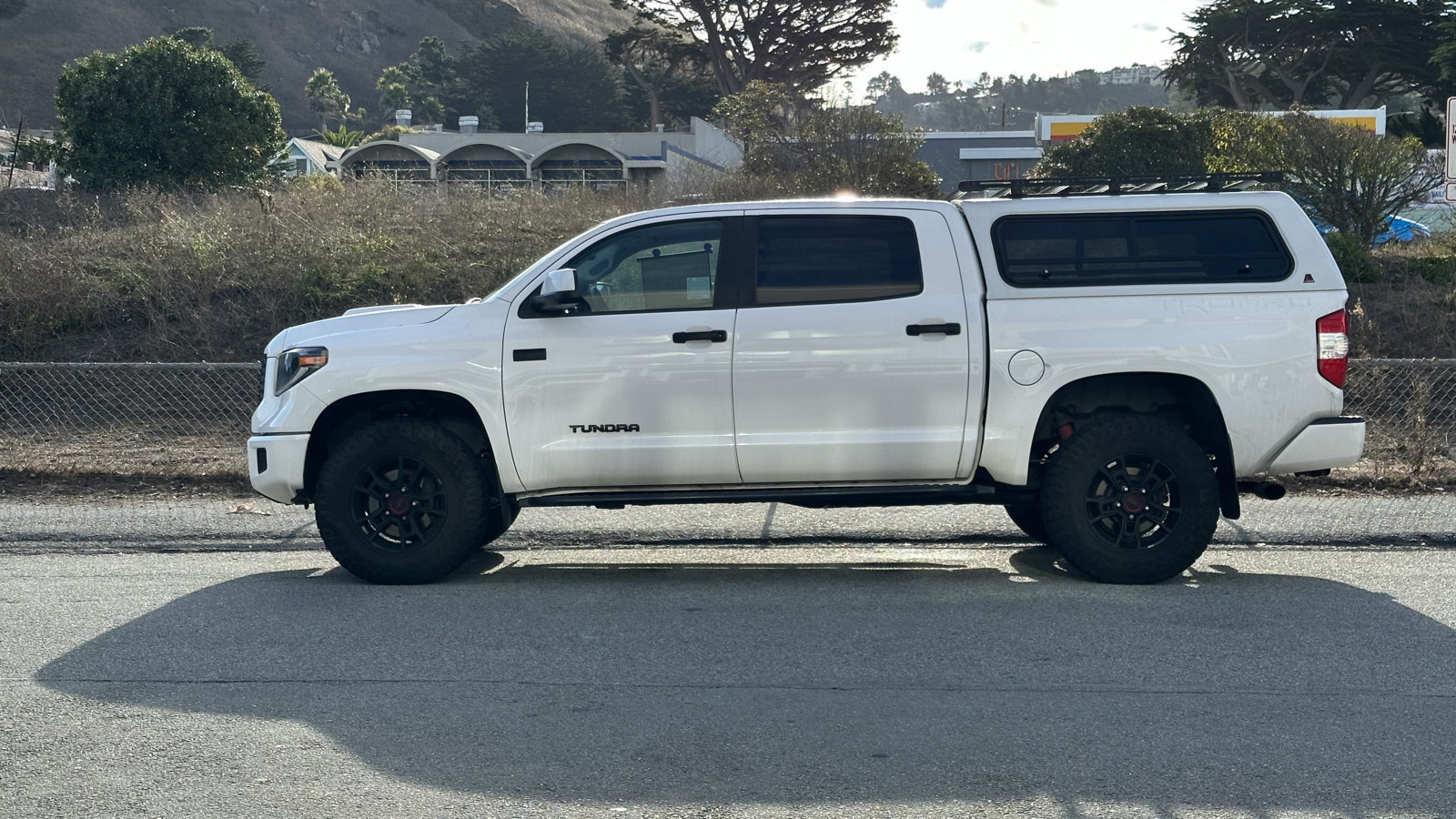

    Hey @BillyB

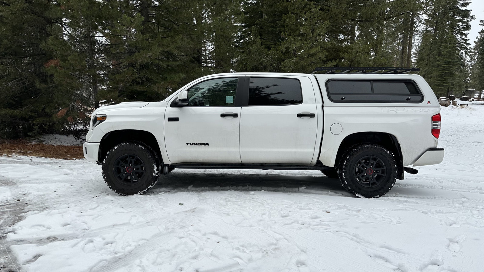

    Yes I did just get them installed, I got a couple pics before it got dark, will get some more.
    Eibach Springs
    285/75R18 Duratracs (35x11.2)
    NO UCA, aligned just fine
    The Eibachs are 650lb springs vs the Fox's 600 and ride nicer.
    Eibach Springs + OME Leafs is a zero spacer lift option for the Pro Shocks. Westscott, Coachbuilder, and ReadyLift are all spacer lifts.
    Has about a 1" rear rake which I like because it levels out when my dogs are in the back.

    I bought a SPC uca, still contemplating if I would use this for the Eibach spring lift. I would just sell the SPC if I could get away without it. What made you not use any UCA mate?

    Pacifica, CA
    I didn't worry about rubbing because I'm running 285/75s which are 35x11, if I was going to run 35x12.5 I would have. Shop said there was no problem aligning, was easy for them.

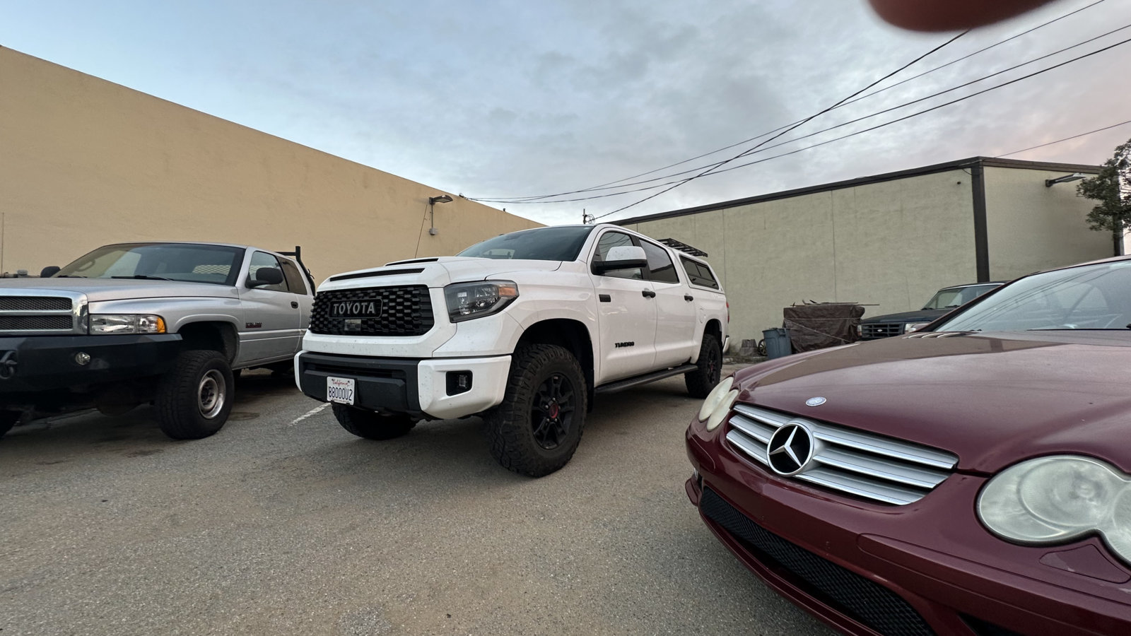

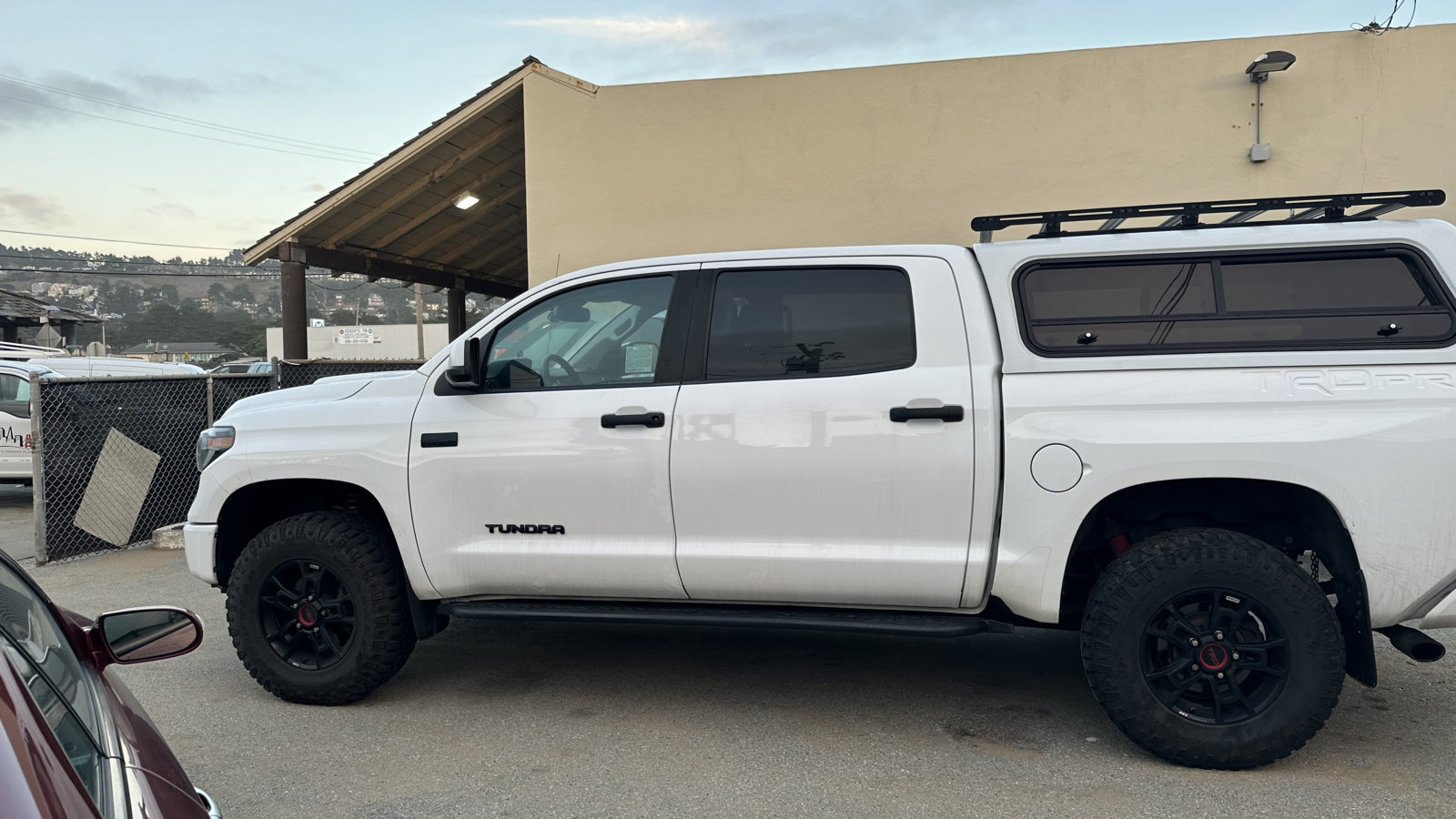

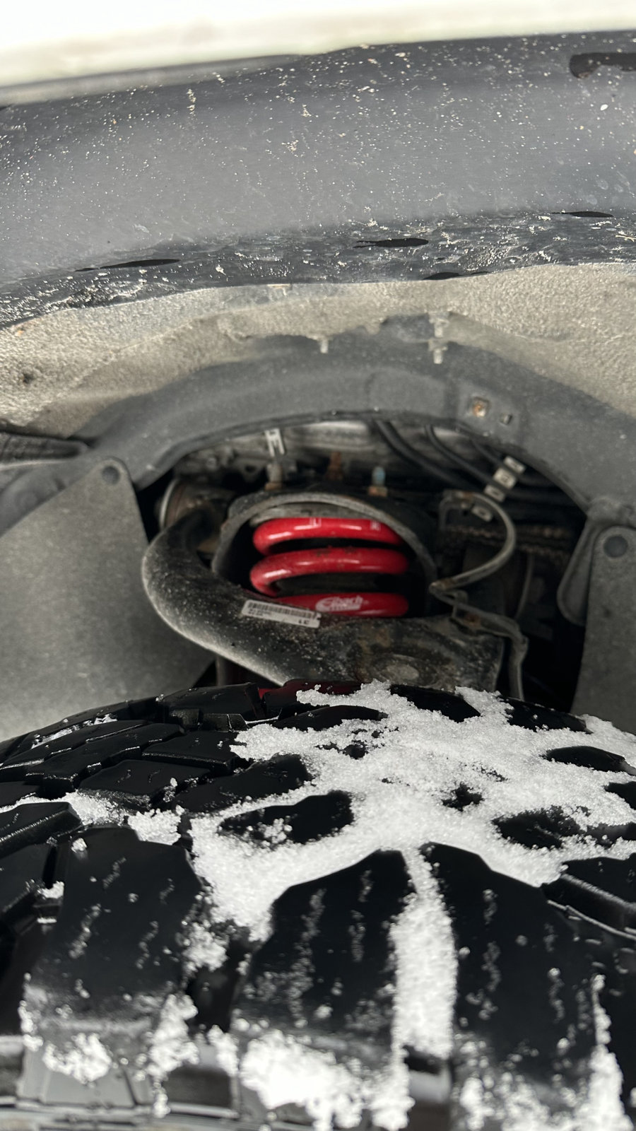

    Some more photos showing front lift with Eibach Springs
    This is with only the OME Dakar Leafs installed and stock front. I did these myself and was enjoying the rake for a while.
    With the Eibach Springs + OME Leafs, can see the front end is lifted.
    With Eibachs + OME Leafs again
    Shot of the springs

    998
    How much more of a lift did you end up getting after the eibach springs and do you have hub to fender measurements by chance??

    Pacifica, CA
    Front driver and passenger is 24 1/4in
    Rear driver and passenger is 26in (w/ OME springs)
    Half tank of gas right now
    I don't know what stock is, didn't measure before lift

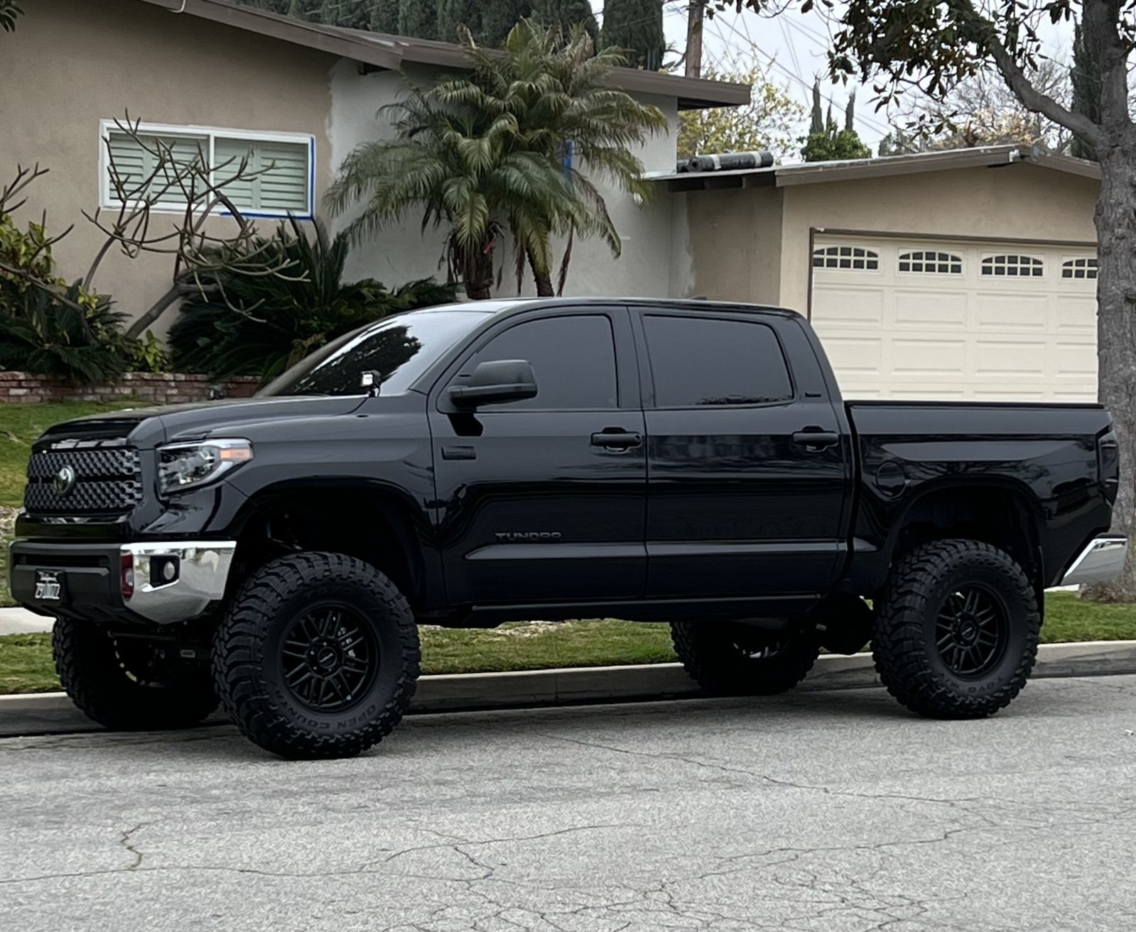

    - Carven Type R Exhaust - TRD LED Headlights - (2) LED Ditch Lights Mounted on Hood - Cali Raised Ditch Light Brackets - (2) 42” LED Light Bars Behind Grill - Cali Raised Hidden Grille Mounting Brackets - AJT Interior Chrome Delete - AJT V3 Shift Knob - 8" ReadyLift w/ Bilstein 5100's (all around) - 18" Raceline 948B Split Wheels - Toyo Open Country MT 37 x 13.50 R18 - Amp Research Power Steps
    I have the ReadyLift 8” with 5100’s all around, love the ride. Toyo Open Country 37x13.50
