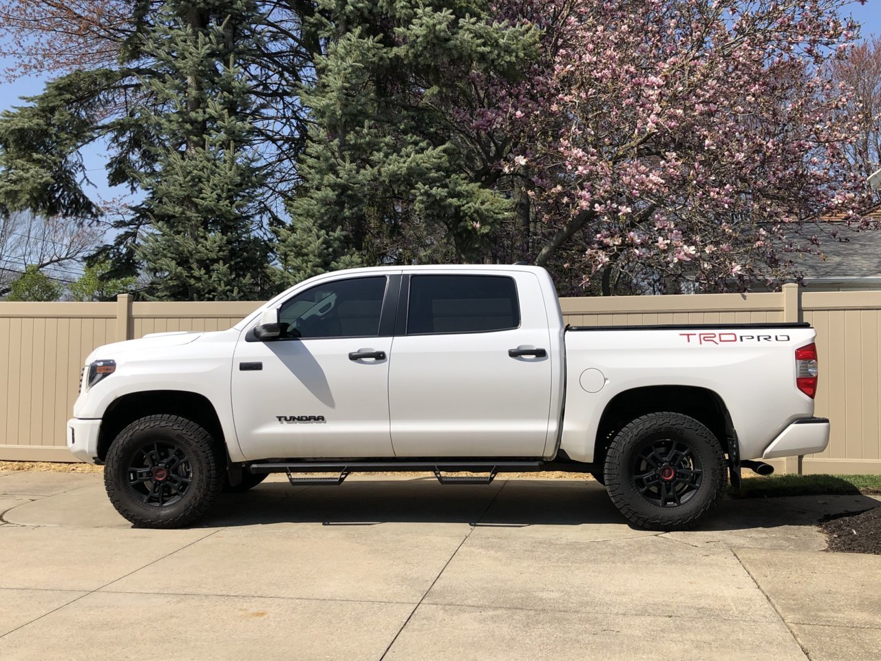

    Installed Westcott front yesterday. I have CB +2 shackles in the rear right now. I have a set of +3 shackles ready to install but I kind of like the look as is. I’ll have to hook my boat up and see what happens….
    S-Q-U-A-T !
