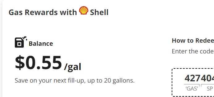

    Just noticed something else cool.
    I saw someone post online they'd give you 35¢/gallon off your next fill-up if you link your Advance Auto Parts SpeedPerks account (which is free) to your Shell Rewards account. Thing is, I didn't have a Shell Rewards account officially, Advance Auto somehow had my phone number registered in Shell's system but not tied to an account.
    So I figured "WTF", and setup a Shell Rewards account. Then linked it back to Advance Auto using the number Advance gave me (427 with your 10-digit ph#) and they actually gave me my 55¢ off my next fill-up. Hell yeah!
    DJenerated likes this.

    2.89 a gallon!!!!!!! Wow that is dirt cheap!! That’s cool I’m almost at 5$/gallon
