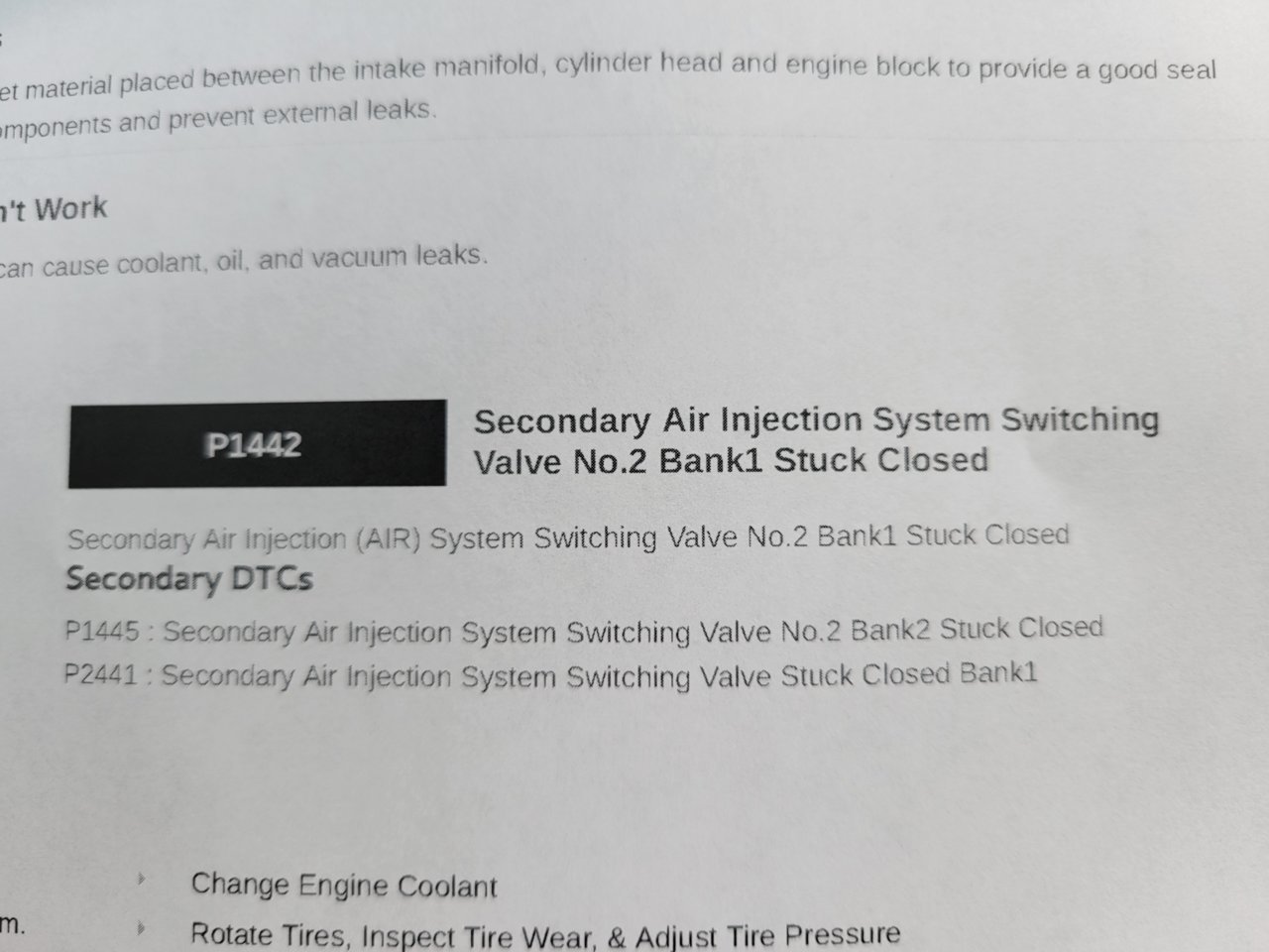

    I guess this is the culprit.

    Common issue. Fixes are out there, all involved. Bypass the SAIS is the most common solution it seems. Cheaper and less likely to cause issues in the future.

    The Fix Finder report was saying I need to replace the intake manifold gasket.

    Damn, I forgot you 05-06 guys have that useless SAIS system for emissions.

    OP, Hewitt bypass will save you tons of money on the SAIS issues

    Yikes, this is what nobody with an '05+ ever wants to see. I loathe the day when this hits me too.
    Uh, yeah. About that. SAIS pump is under the intake. So technically, yeah, you'll need to replace the intake gasket. The pump itself costs a few hundred bucks when I looked a couple years ago ($450-550?). Install roughly involves removing the intake manifold and all that's involved with that, pull the SAIP, install new SAIP, install new intake gasket, OEM because aftermarket sucks, then bolt it all back together. Not a fun job. But you'll be paying a shop $1k parts and labor, or a stealership twice that.
