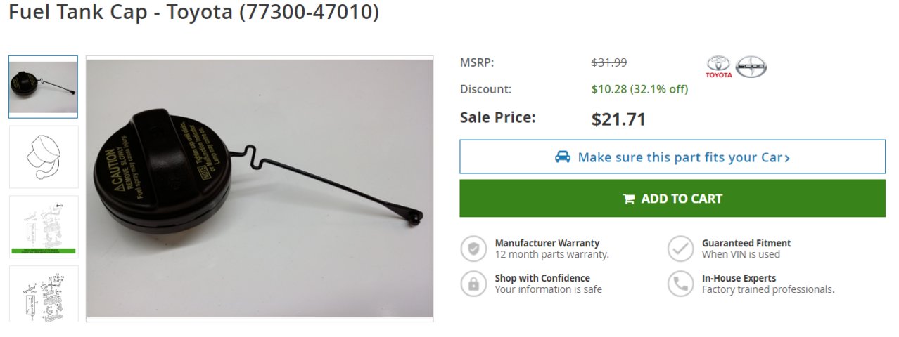

    Toyota Parts website not working - any other suggestions?
  10. Nov 10, 2022 at 7:37 AM
    #40
    shifty`
    Jun 20, 2020
    #48239
    29,445
    ATL
    '06 AC Limited V8/4WD
    Dunno what to tell you, it's working for me when I click the link - maybe you've got an ad blocker on your computer and/or network that's not letting the forum link jump?
    You can also just try copy-pasting this website address into your browser: parts.toyota.com
    In the search box, copy-paste this part number into the search: 7730047010
    Then pick a dealership to order from, to see the final price, and order.
    If you don't mind paying $30 plus or minus a couple, you could also hit up any local dealership and give them that part number, they'll grab it for you.
    I can't find any other online retailers selling this part legitimately. But if you can't hit that website, McGeorge Toyota's website is another folks on this site use: https://parts.mcgeorgetoyota.com/
    It's only $21 there but you gotta pay tax + ship, so maybe close to a break-even on local pickup.

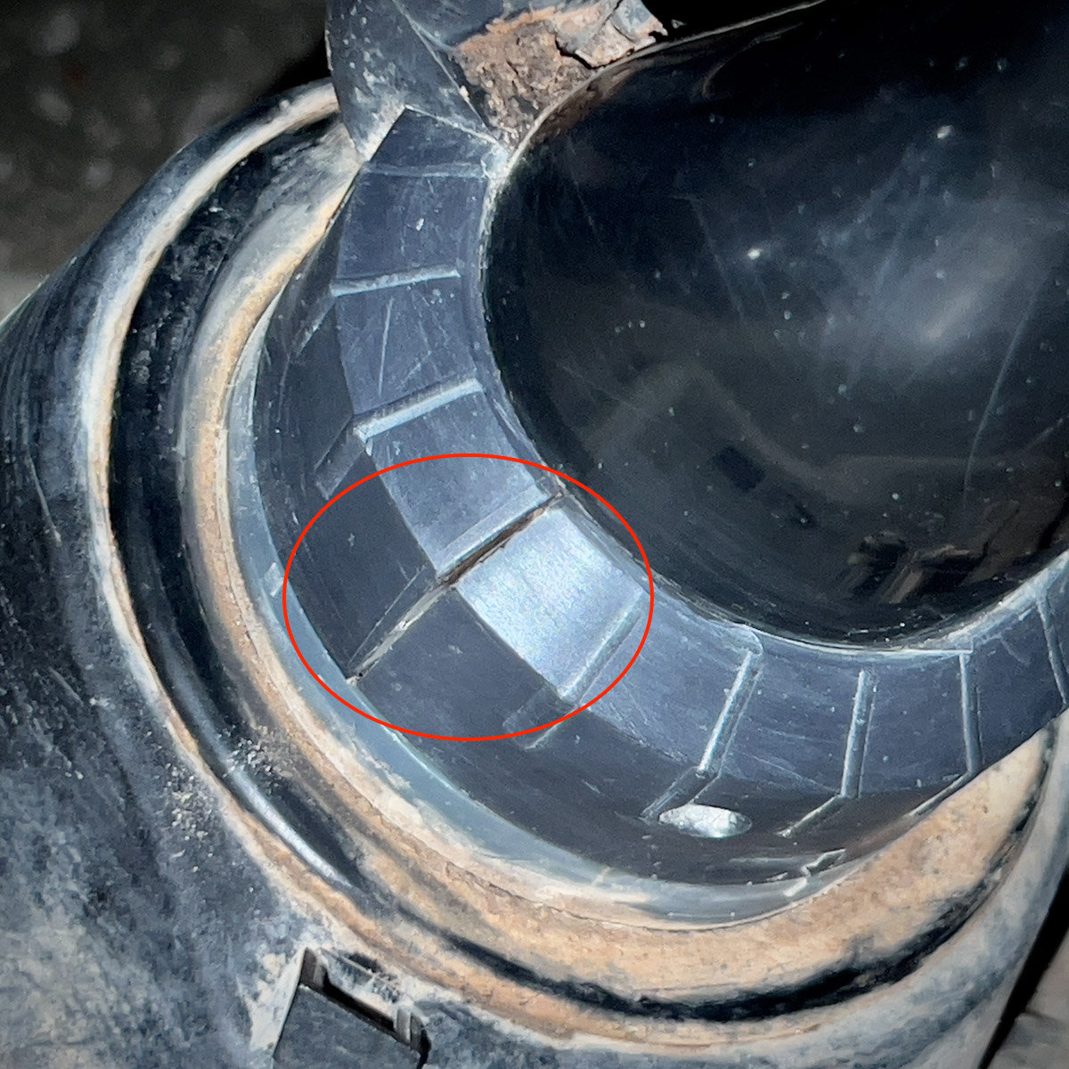

    Apparently not. I recently had the P0442 CEL come on on my 2003. Cranked the gas cap tight to be sure and cleared the code. The next time I filled up with gas I thought I saw a drip, but thought most likely it was a pre-existing gas station asphalt stain. Filed it away as a data point tho.
    Sure enough, the CEL came back on. Crawled under today, saw what seem to be cracks in the fuel filler neck. Looks like my VIN is in the TSB range, and I don't think the PO replaced it, but I'll check better in the morning.
    Since I'm leaving on a 1000 mile business trip and this code doesn't seem to be life or death, I'm wondering if I should a) just ignore it, or b) put some JB Weld plastic bonder on the cracks. Or gorilla tape...?
    Aside: wasn't sure what MIL meant in this context, had to google to make sure it wasn't "Mother-in-Law" as in, "that damn engine light on my dashboard is as annoying as my mother-in-law".

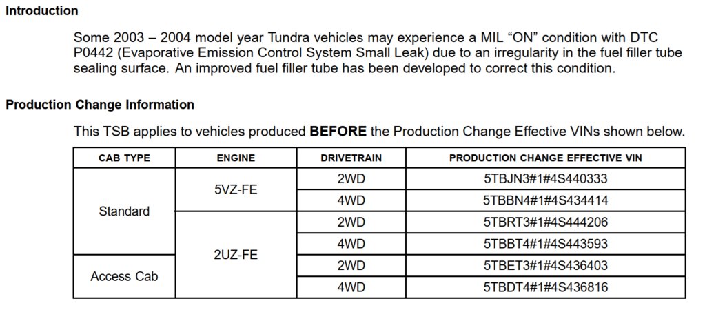

    FYI....T-SB EG019-03 mentioned earlier in this thread, which affects certain 03-04 SC(standard cab)/AC(access cab) Tundras, was superseded by T-SB-0003-11 on 01/05/11.
    T-SB-0003-11 attached....

    If you have a rattle can of Flex Seal and it's easy enough to get the neck outta there, you could hit it with that also. If not, just wipe it down with alcohol and hit it with rubber cement on a brush. EVAP being what it is, it'll want a sealed system, I don't know that it'll really affect you much.

    Is this a crack, or just an intentional gap? And if a crack, would this be something that could cause the P0442 code?
    (I realize that without removing it for inspection there are potentially cracks elsewhere, too.)
    Didn't have Flex Seal, but I did clean it up, wiped with alcohol, and put some JB Weld plastic bonder on (yes, that is JB Weld...) and worked it into the crack. Will try to remember to report back if the CEL goes out.

    I love when it gets worked into the crack.
    Anyway, I can't tell if that's intentional or not. The fact there's a seam from a mold perpendicular to it nearby, I'm struggling with why you'd have a seam in your mold right next to a split, which makes me think that's potentially a crack. But without seeing pics from another '03-'04, I'm not confident in saying.

    Your truck year has a TSB out for this specific problem. More information is in the megathread. Here's the pertinent text from that thread, download the TSB and follow its instructions to fix with the updated part:
    Cracked fuel filler neck TSB for 2003-2004 trucks. See here. Causes P0441, P0442, P0446 codes.

    TSB just means Toyota is aware of an issue, it's a technical service bulletin which defines some work they recognize as being necessary due to a condition they've encountered as "not just a one-off fluke". If you catch it in the warranty period, I've had them do the work for free if it's a component that's typically covered under warranty.
    For the Effective VIN, I either get this right away or I don't.
    IIRC, the value of the "#" doesn't matter, I think the first one, digit 7, is for the model type, and the other in position 9 is a 'check digit' to validate the full VIN#.
    The last 6 digits of the VIN is the sequence of trucks produced that year, and 2 digits after the "S" is the last digit of your year. Like, from that chart, if you have a 2003-2004 truck that's a "STANDARD CAB" or "ACCESS CAB", and the last 6 of the VIN is 440333, and the last 6 of your VIN is a lower number than that, you're impacted. Basically they're telling you, in that change chart: If your truck was made BEFORE that VIN sequence number (the last 6) and the other parts of the VIN match, you're impacted.

    Thanks shifty. Definitely not under warranty lol. I have a Crack very similar to the one Posted above. I'm going to patch it and see what happens.

    I had the code once myself, thanks rubber-eating rodent... Of course this was on top of the hose, took a minute to find it.
    Glad you got yours figured out

    Was the code 0442? That doesn't exactly look like a small leak lol. I patched what I thought was my leak yesterday. Truck passed inspection but 0442 code came back this morning. At least I got another year to fix it :)
