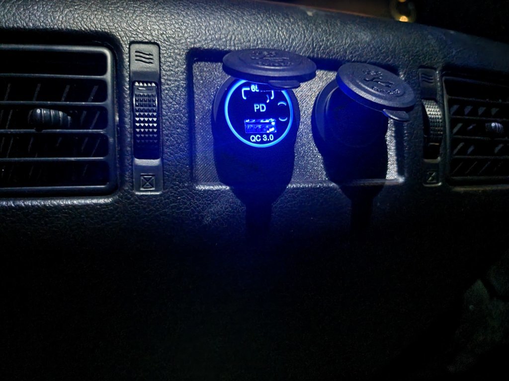

    All the 12v sockets suck, even after adding adapters, i can never get a fast charge. I ended up buying a new plate, off this forum to add 2 of the 12v sockets and added my own bigger wire. the factory wire is really, really tiny. Now i have 2 fast chargers in the back for the kids

    the plate where the OE outlet mounts, that is a bolt on plate. When you take apart the back of the console (pretty easy) you bolt the new one, which you can get with dual outlets. Message @Chelly and he sells 3d printed ones for like 35 bucks shipped. And then get some outlets from Amazon, Amazon.com: USB C Car Charger Socket 12V USB Outlet 2 Pack: Newest Aluminum Metal 78W Dual USB-C PD 30W and 18W QC3.0 Port Multi USB Charger Outlet with LED Voltmeter Power Switch for RV Motorcycle Boat Marine : Cell Phones & Accessories so you can have the usb and usb-c. I used bigger gauge wire, from amazon also and ran it to my add on fuse block kit. When you take it apart and see the harness for the 12v outlets, u will know why the charging sucks
    there are a couple write ups, DIY: USB Replacement CIG outlet | Toyota Tundra Forum that show you how to take it apart and wire.
