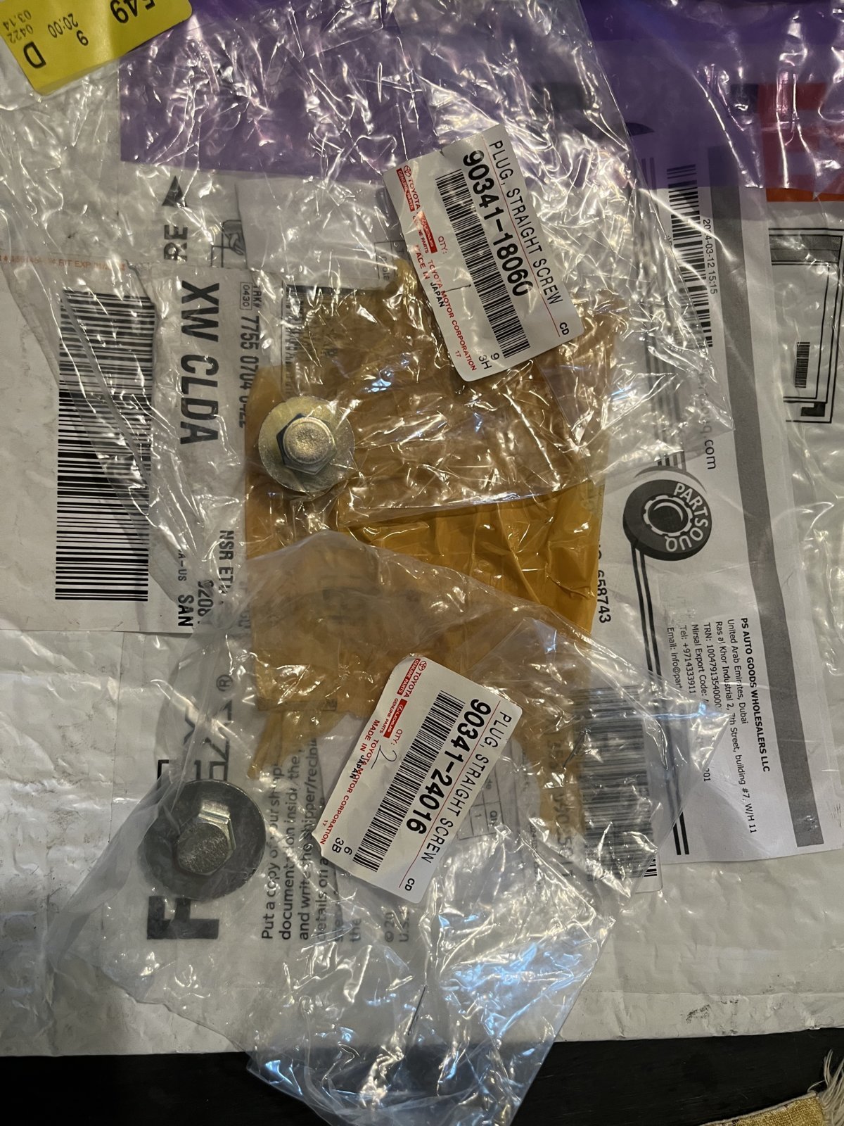

    Update on this:
    Parts came in today fresh from Dubai

    I just hope you have better luck than I did getting the lower drain plug out...be careful.

    I went with the Kaon offering this time around for my drain plug, it'll be here next week. I got a lookalike "Lexus" part on scAmazon last change, and it's created an unholy headache for me to try to remove, as the protruding 14mm bolt head just kinda sharded apart into metal flakes. But it's hardly the economical choice at $35AUD. I was tempted by their fill plug which is equally incredibly beefy, but since I don't have trouble removing the full plug I decided to keep the Lexus part I have (different, genuine supplier for the fill plug. Just got unlucky on the drain.)

    Ordered today from PartSouq, good price. Thanks for providing good info!
