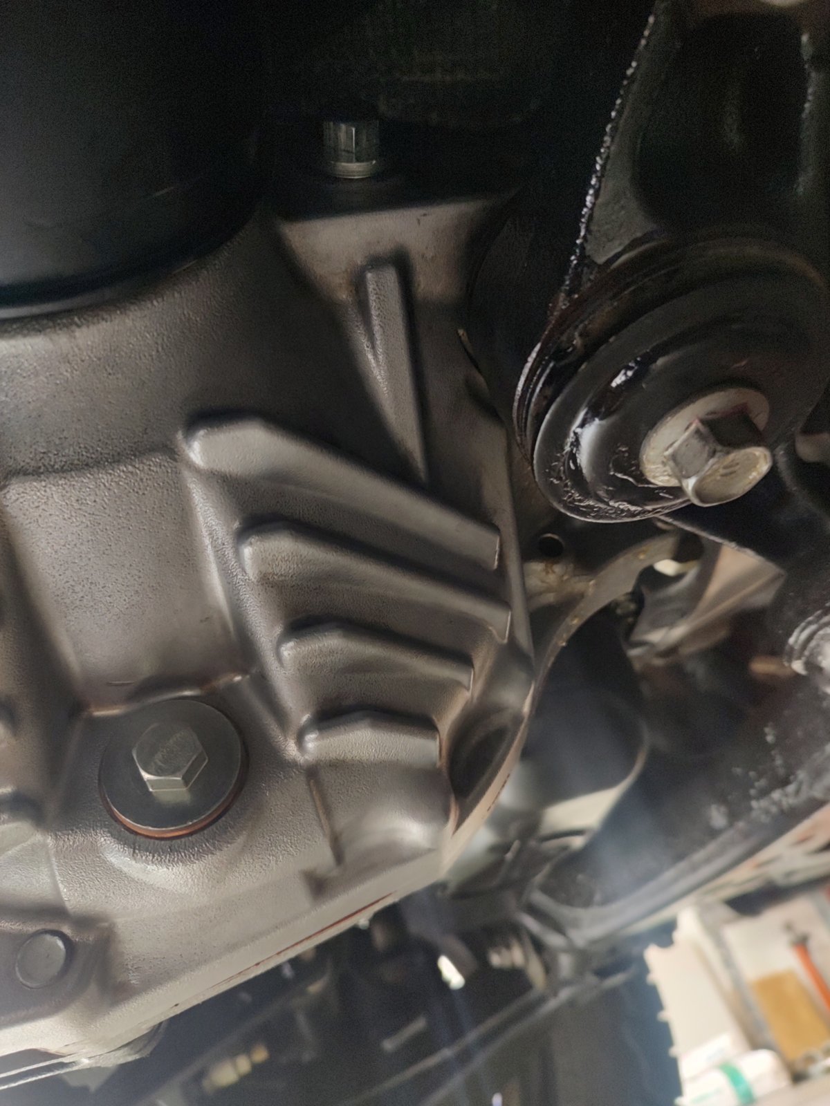

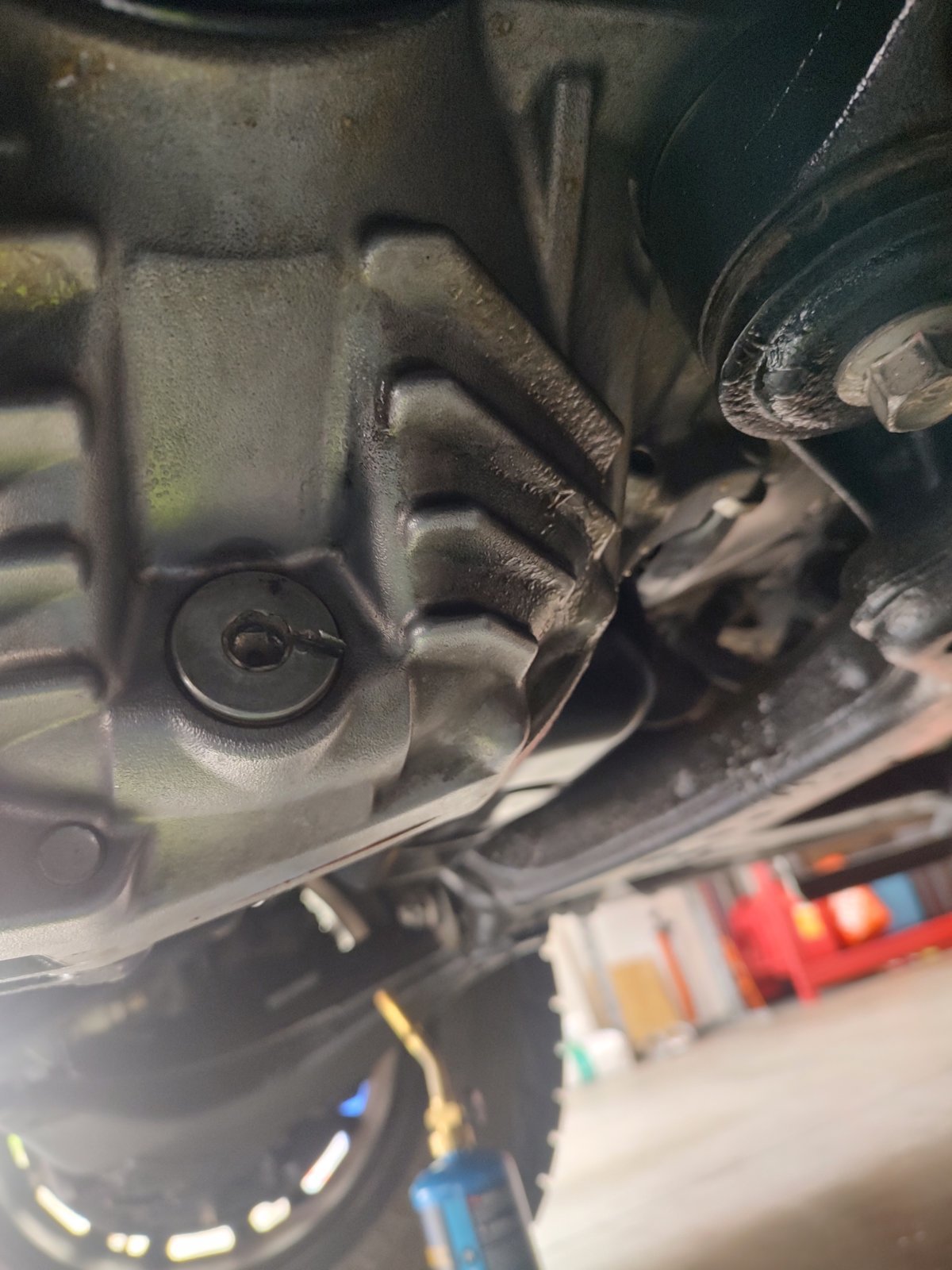

    ^ This is how I removed mine. A little, just a little, heat from a propane torch, then turned a can of electronic duster upside down and shocked it with cold. Then a sharp punch and a hammer along the outer radius of the plug.
    I didn't remove material, I made a little pocket with the punch and walked it out.
    ZappBrannigan and coldcanuk like this.
  13. Mar 10, 2024 at 8:36 AM
    Mr Badwrench
    Mr Badwrench New Member
    Jul 20, 2018
    #17205
    1,451
    300 hectares on single tank of kerosene
    Or this... this is probably more "sure fire"

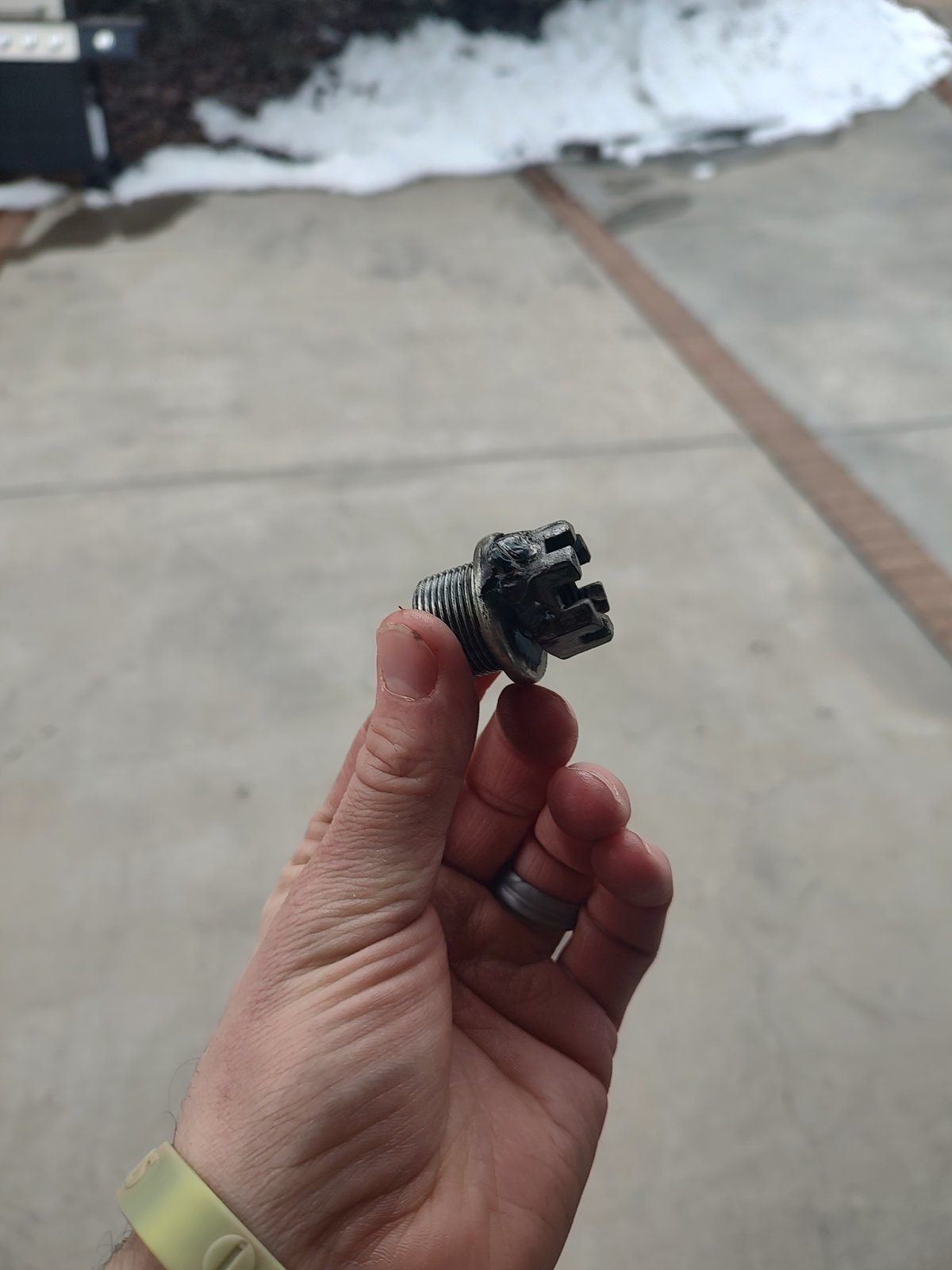

    So I went to a local welding shop and had them weld an old castle nut onto it. Well spent $20 (even tipped the guy another $20 because he really saved my bacon).
    Kinda looking forward to the next front diff drain and fill, now that I've got the Lexus plugs in there.

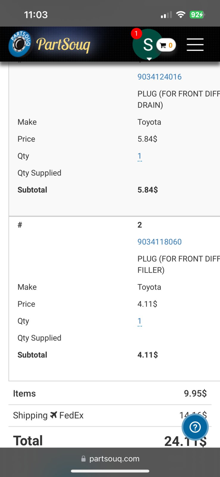

    Lexus plugs:
    90341-24016 (drain)
    90341-18060 (fill)
    *You won't be able to order them from your local Toyota dealer or typical online Toyota parts retailers (strangely enough). And I found them to be most affordable at Partsouq.com (even though they ship from the middle east).

    Did you order washers as well?
    2mchfun likes this.

    1,462
    San Diego,CA
    2013 CM 5.7L 4x4 SR5 Super White
    Ordered
    Couldn’t resist the price…thanks!
