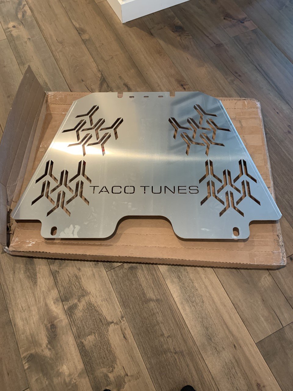

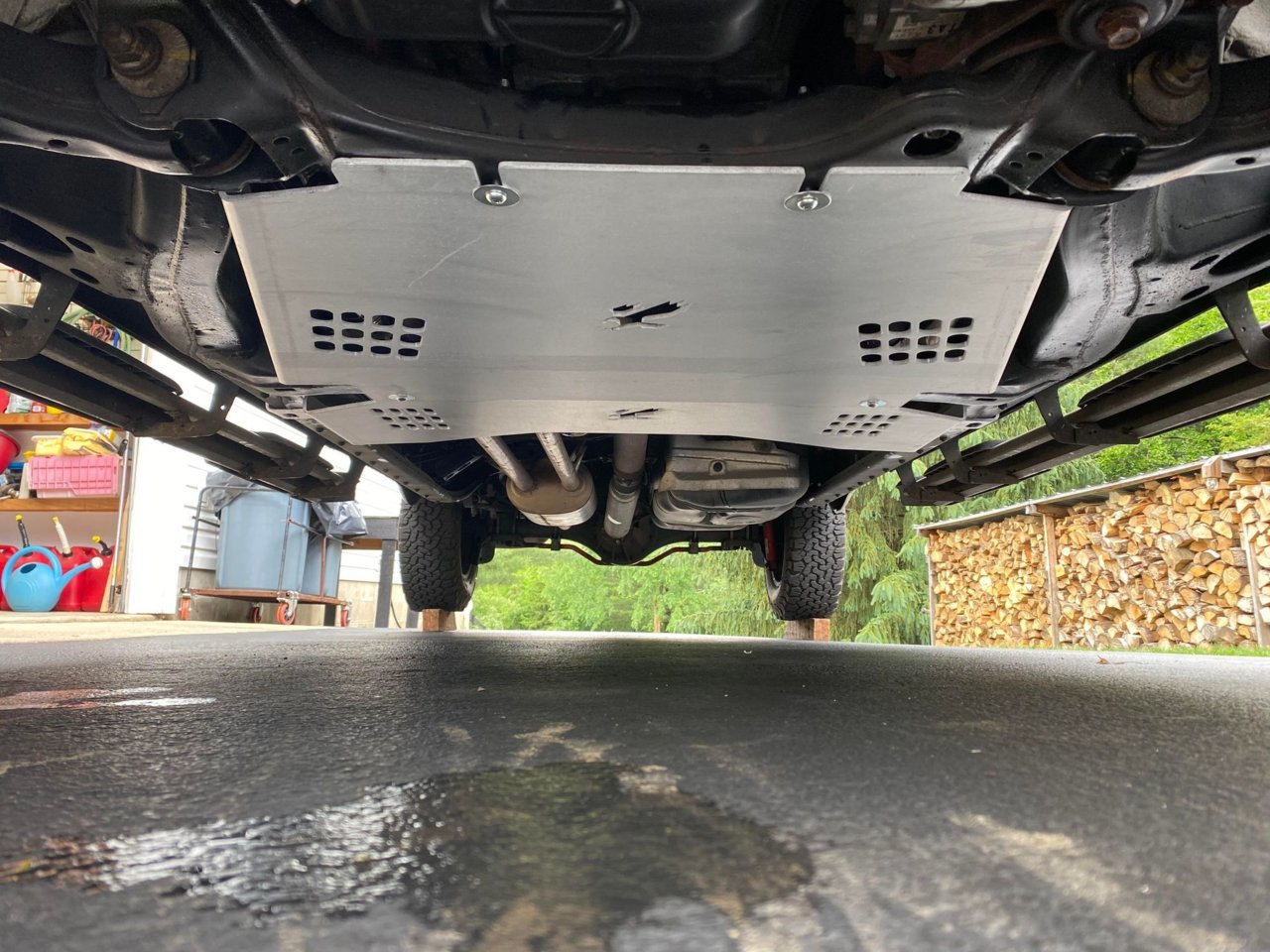

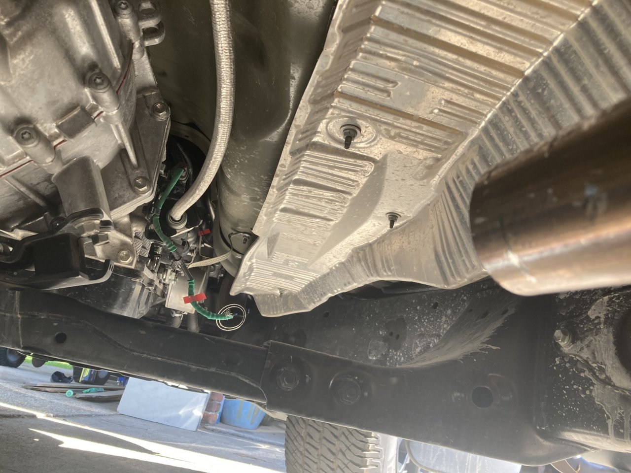

    I just installed the Taco Tunes cat shield. It came quickly (1 week) and was easy to install. One item was that the if you have a TRD skid plate you may need another person to tighten the security screws/socket (which is why I included the screenshot of someone installing it with a skid plate. Honestly this brings me so much piece of mind.

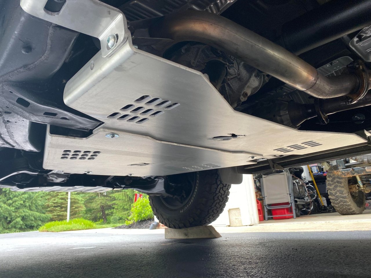

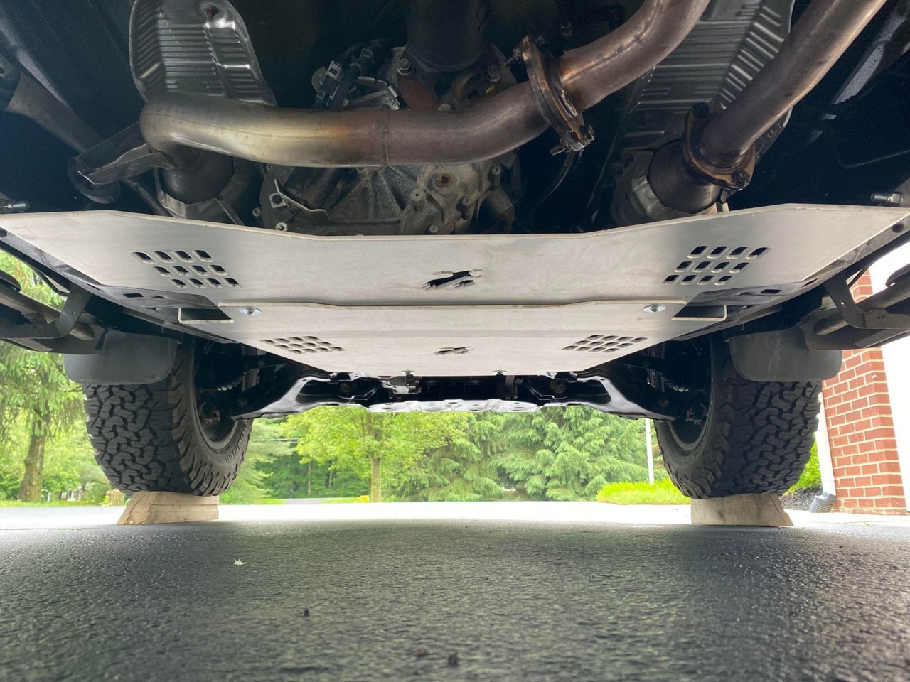

    I have had way to many burrito's to get under the truck and do any work. I put it in 4LO and drove it up on some wood blocks I use to park the Jeep on when I am power washing it. Pretty easy install. I have a 3/8 Milwaukee impact that REALLY helps. What a game changer it is...
    Plates look great but now I want the matching engine skid.... I pre soaked the exhaust bolts in preparation for my Dirty Deeds exhaust. I may have to drop the rear plate to get at exhaust bolts on the passenger side but that will be pretty easy.

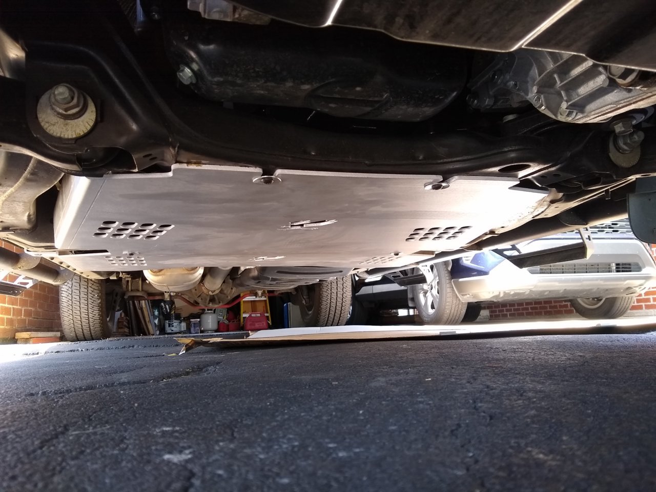

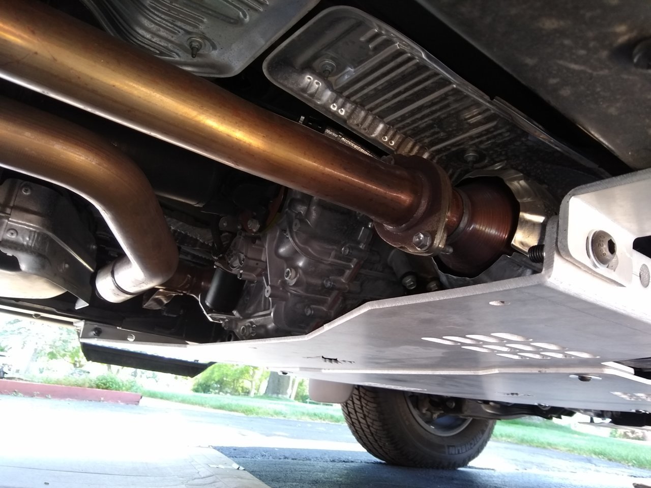

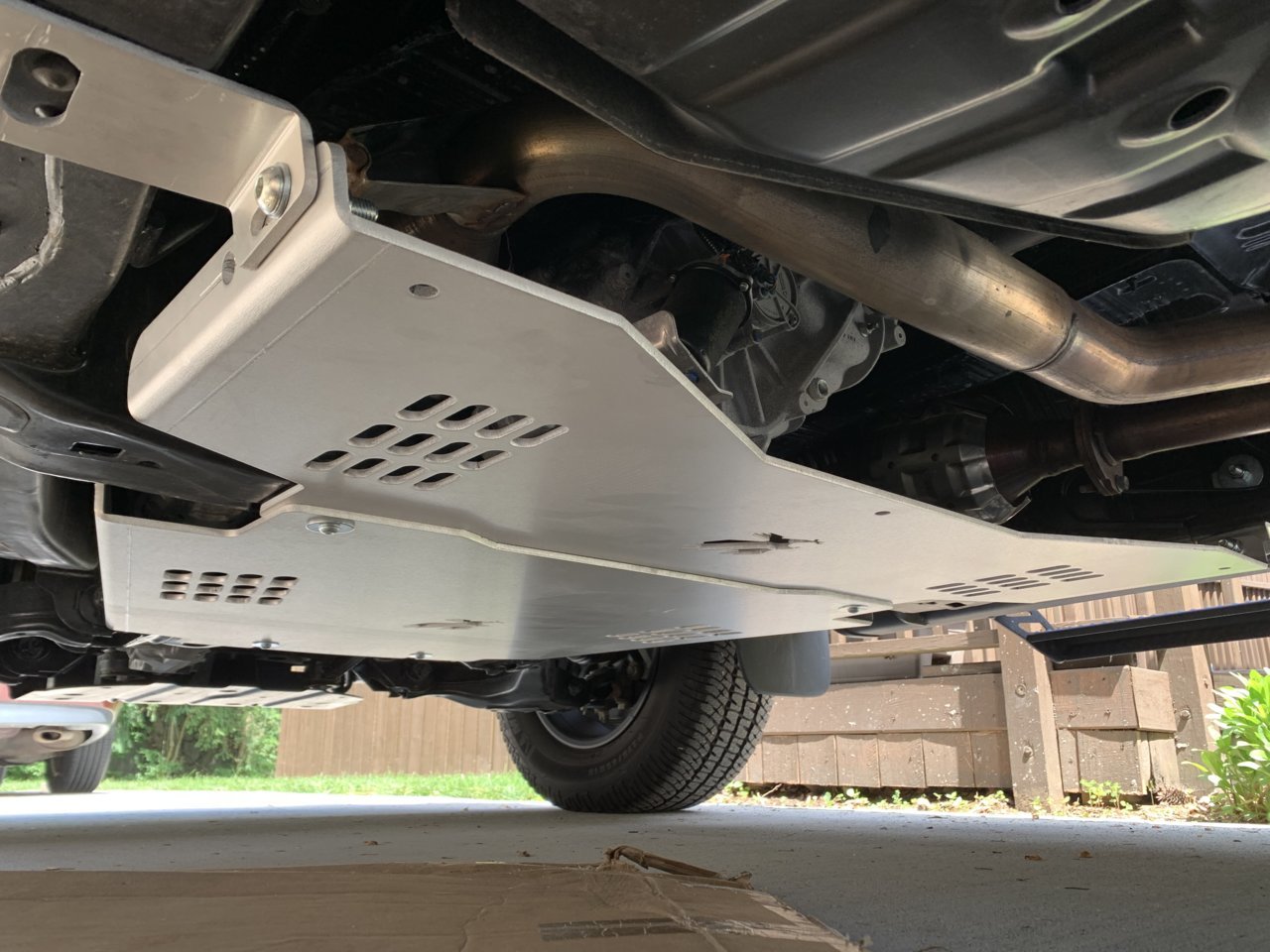

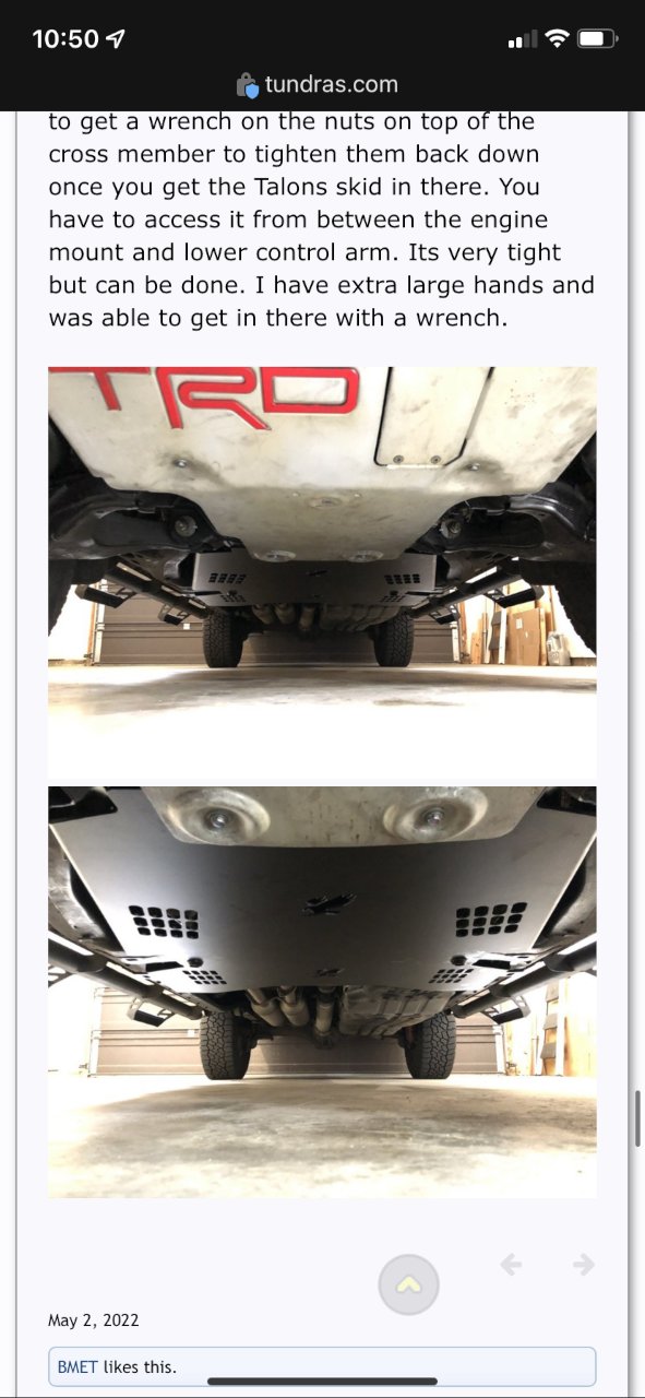

    Just installed the Talons Garage front and back shields today. What a clown show. I'm one of those guys that really needs to just pay someone. A reasonably intelligent, organized and cable mechanic with the proper tools could probably do this in under an hour. It took me much longer :anonymous: I'll spare everyone the details.
    Ordered and shipped the same day but UPS had some kind of problem so delivery took about a week. First impression was 1/4" is a really solid piece of aluminum. Total weight for both sheilds is about 40-45 lbs. I purchased the security bolts and have to believe these plates would be a real bitch to remove.
    After install, I'm not sure I would order the back plate if I could redo. The front plate totally covers the front of the back cats and it looks like it would be difficult to get a saw blade in front of the rear hanger on the back cats.
