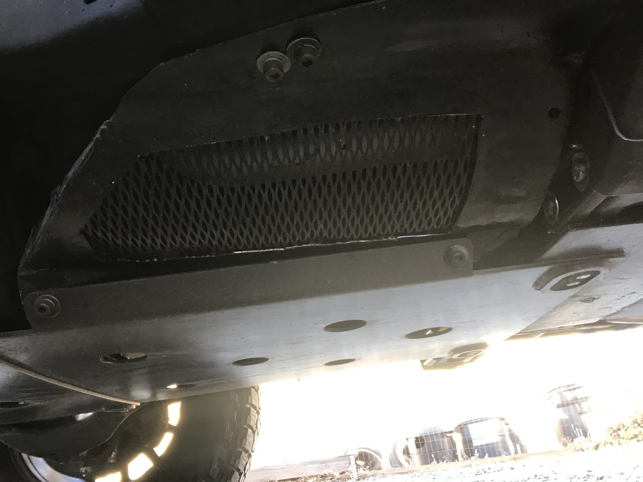

    I used some thin nylon washers between the frame and skid plates to prevent any potential noise.

    Do you hear any noise from the expanded metal?

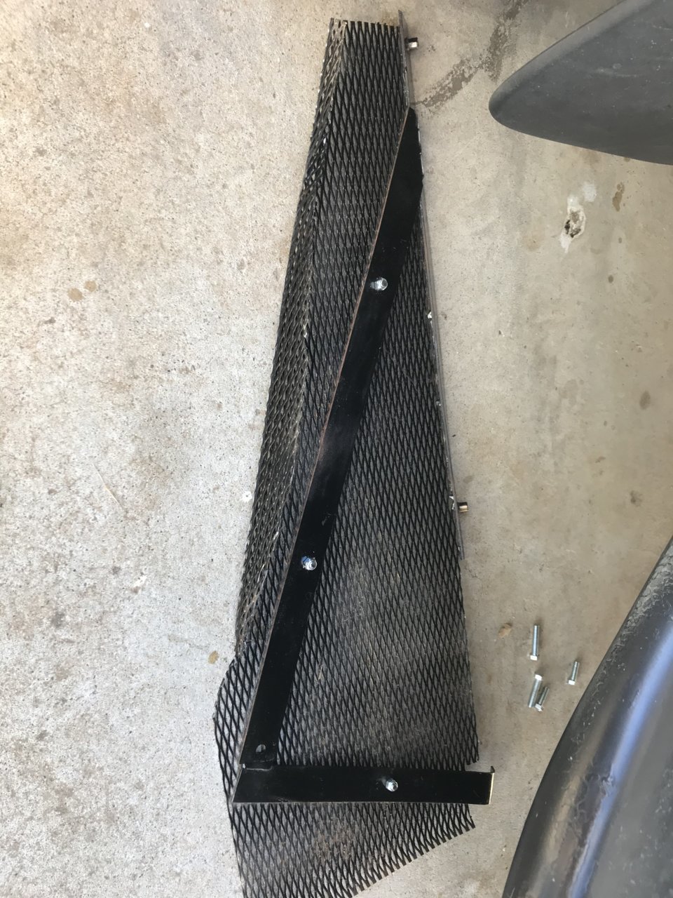

    I used nut certs on the skid plate attachments, and then for the bolt that runs into the trans crossmember I just welded a nut to some flat stock and slide it into a opening on both sides of the crossmember. The other bolts are there to reinforce the attachment of the expanded to the frame I made, just incase someone really trys to yank on it.
    No noise yet. I was careful to roll the edges up on the floating part of the expanded just shy of the frame rail.
    For my FJ I ended up building some out of some scrap sheetmetal and leftover scraps of the expanded steel fom the tundra build. Looks ugly but the price was right, and ugly, sharp and rusty should help deter thieves.
    I wanted dirt cheap and to not be to upset if some thief destroyed them. This way I can replace them for under $100 and in a couple hours.
    Any steel fab or welding shop can build you a custom one.

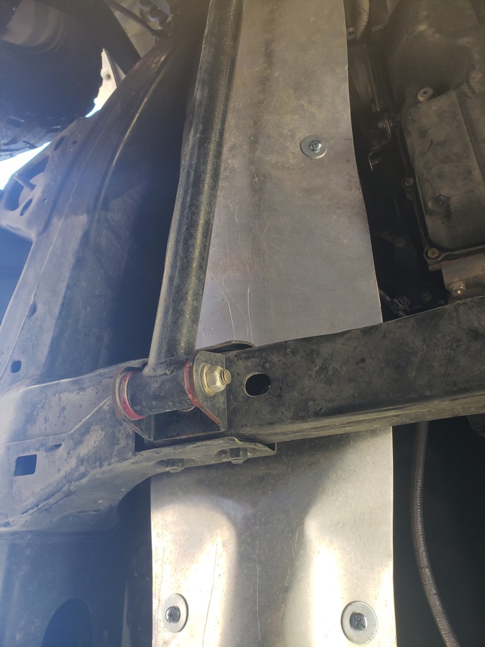

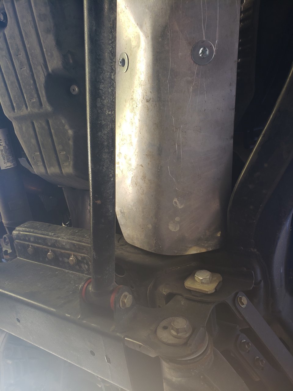

    This is my temporary sheet metal solution until I get some security bolts. Converter thefts have been on a rise lately, and the Desert Eagle skid plate will not work with my Pro Comp lift. Someone with a Tundra got theirs stolen at the movie theater I take my boys.
