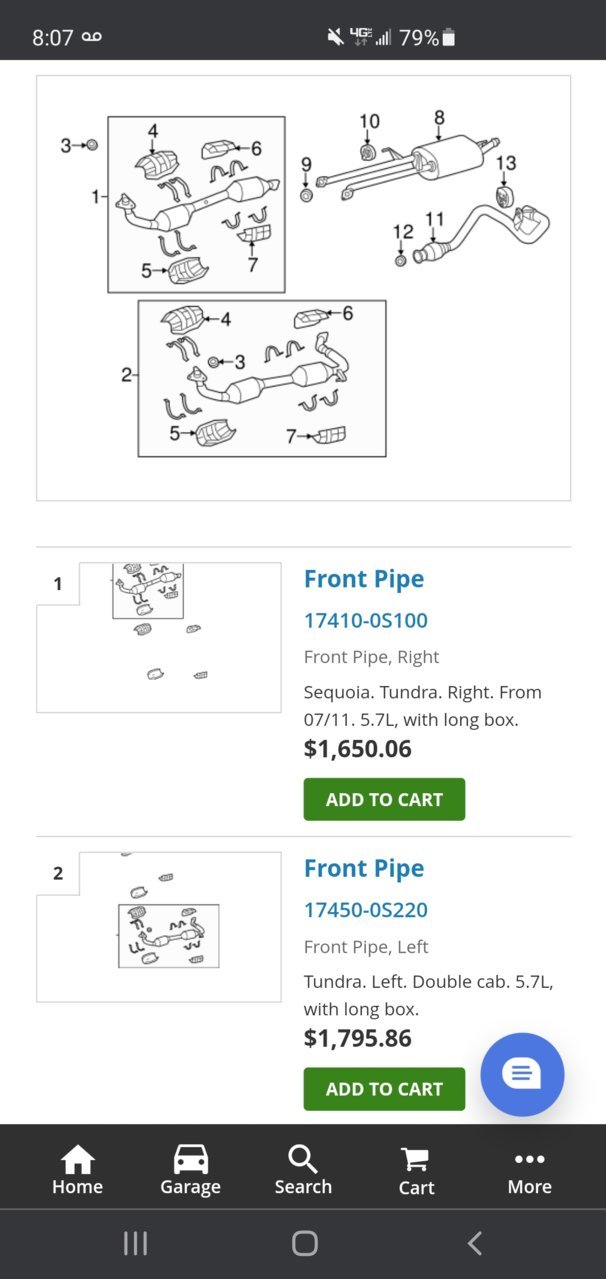

    Not hard at all Desert eagle send you new hardware real easy install

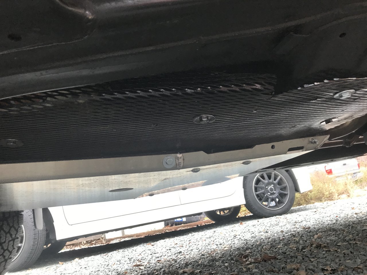

    I did. I just used some expanded steel, flat bar, and square tubing. I left all the edges unfinished so if they try to mess around with it their hands will get shredded.

    Any welding or fab shop could easily add wings to the rci trans skids.

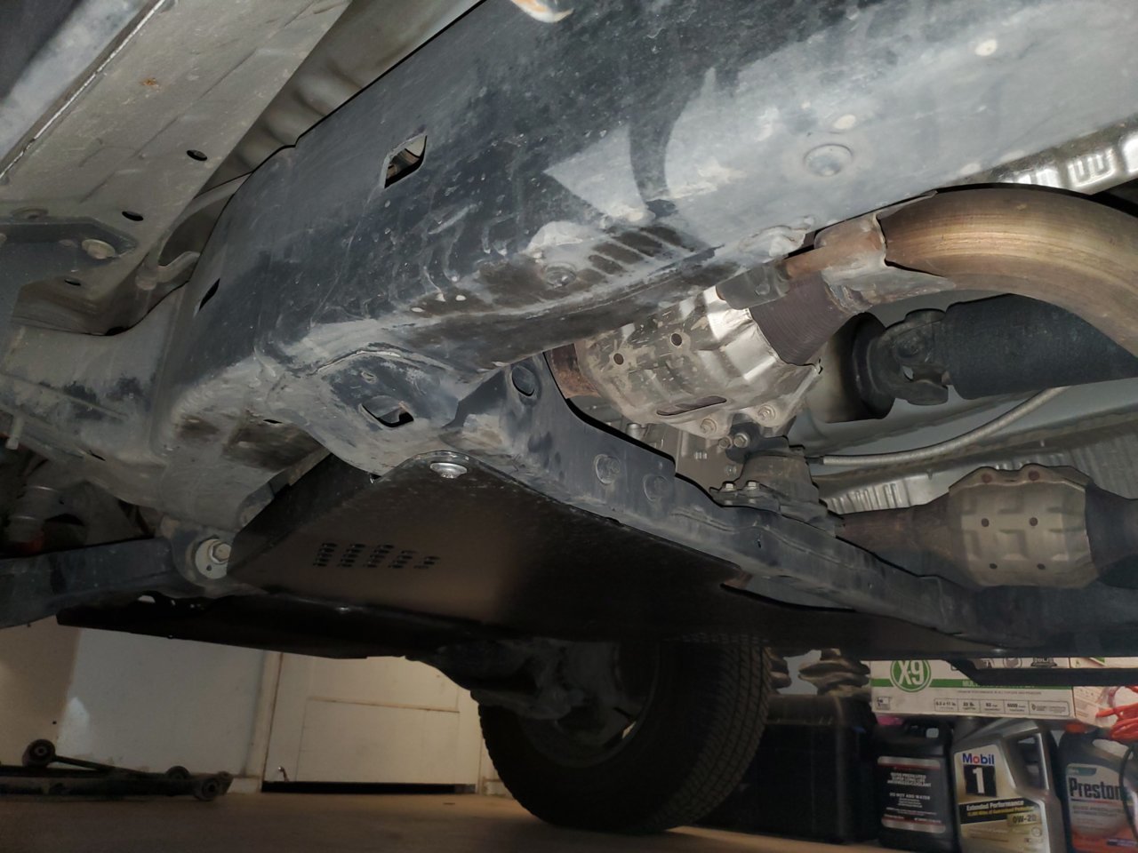

    16125826336631965353448955707516.jpgI only have this pic right now

    So I take it that the rear cats can't be removed due to the crossmember being in the way?

    Right almost no room.
