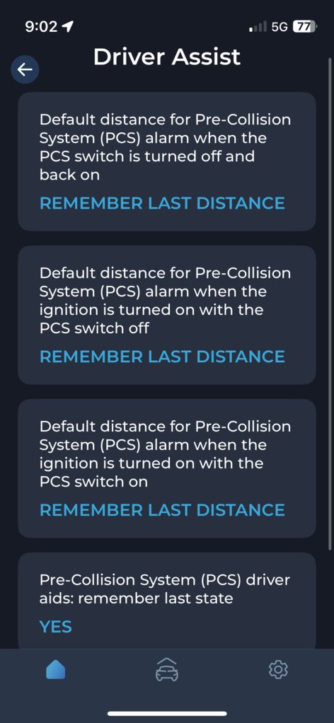

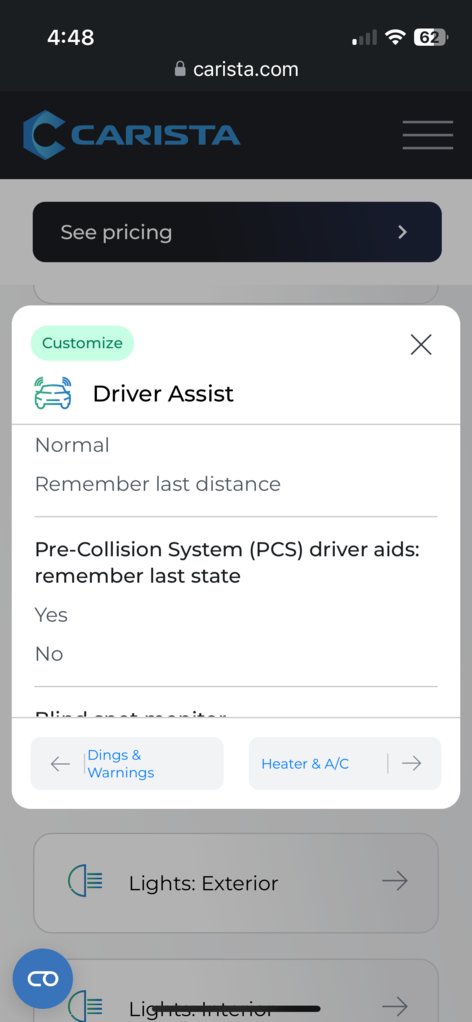

  21. Mar 4, 2025 at 4:52 PM
    #51
    akira
    akira 25 Tundra Limited TRD OffRoad
    Jan 8, 2023
    #90002
    97
    San Diego
    Already turned off engine sound, seatbelt chimes, updated blinkers….but just saw this one on the Carista website to “remember last state for Pre-Collision System PCS”. I manually turn this one off every time I get in the truck because I don’t want it to ever flash the BRAKE light on dash and auto apply brakes.
    Going to toggle this setting to Yes.

  22. Mar 4, 2025 at 5:53 PM
    #52
    kirkb
    kirkb Lurking Member
    Oct 8, 2023
    #105077
    508
    DFW
    2024 Tundra Limited 4x4 WCP Nightshade
    It says remember last distance. Let us know if it remembers on/off state
    akira[QUOTED] likes this.

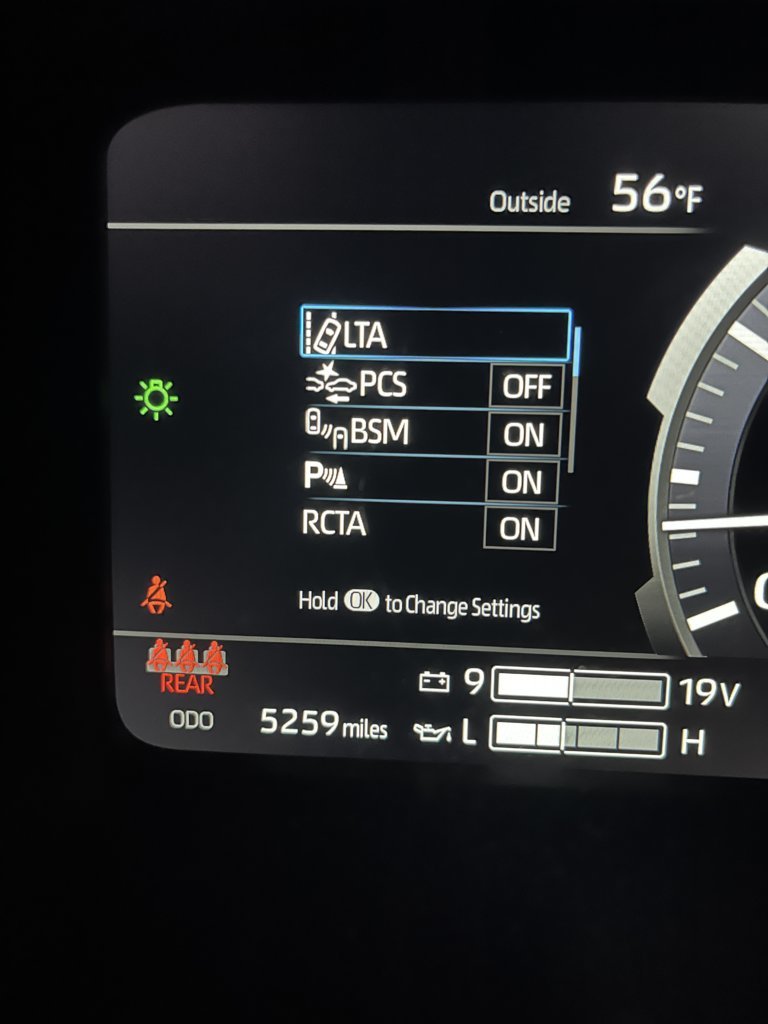

  23. Mar 4, 2025 at 9:58 PM
    #53
    akira
    Jan 8, 2023
    #90002
    97
    San Diego
    Updated this setting from No to Yes.
    “Pre-Collision System (PCS) driver aids: remember last state = YES”
    Turned off PCS, drove the highway and turned truck off for 10 minutes. Restarted the truck and PCS was still turned off. It worked. Now I don’t have to manually turn off PCS each time I get in the truck.
    Tundrastruck91 and kirkb[QUOTED] like this.
  24. Mar 5, 2025 at 6:51 AM
    #54
    kirkb
    Oct 8, 2023
    #105077
    508
    DFW
    Thanks for the confirmation :thumbsup:
