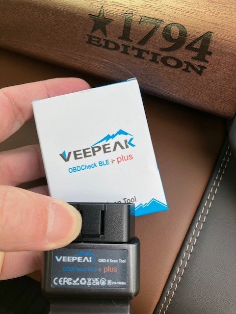

  29. Nov 24, 2024 at 11:53 AM
    #29
    Jodster71
    Jodster71 New Member
    Aug 24, 2022
    #82353
    32
    Awaiting 2022 Mesquite 1794
    None yet ;-)
    confirming veepeak and Carista work together just fine. Carista is on sale BTW. I'm located Ottawa/Gatineau area...
