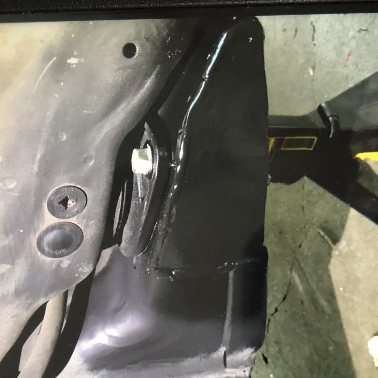

    Pinch weld, fender liner sheet metal as well at that 90 degree point may become an issue. I tagged a few other guys who may have better details.

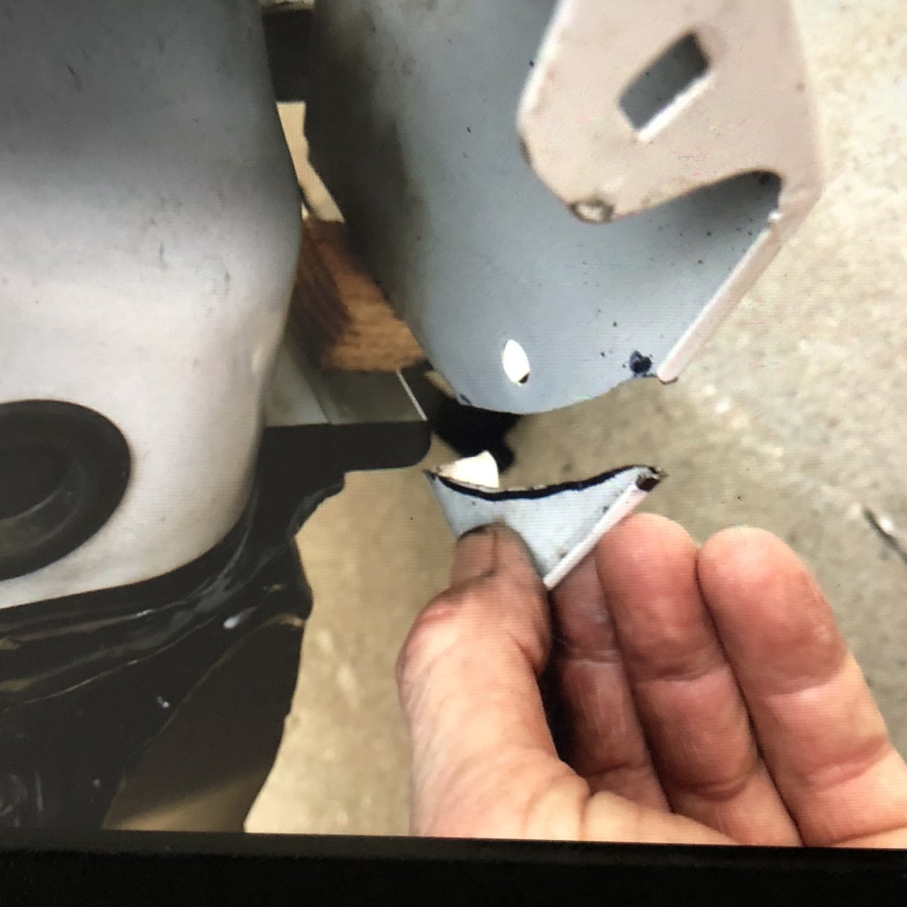

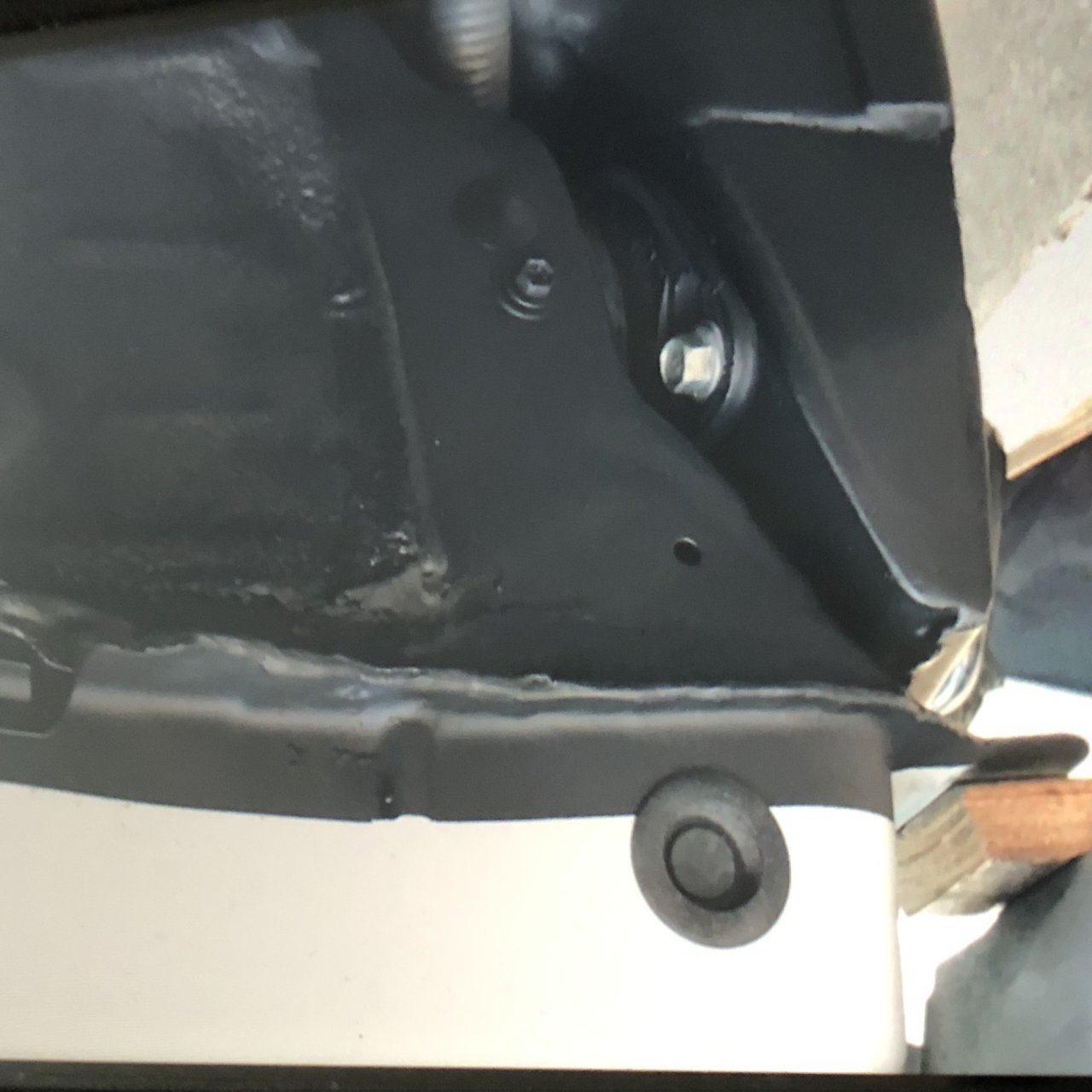

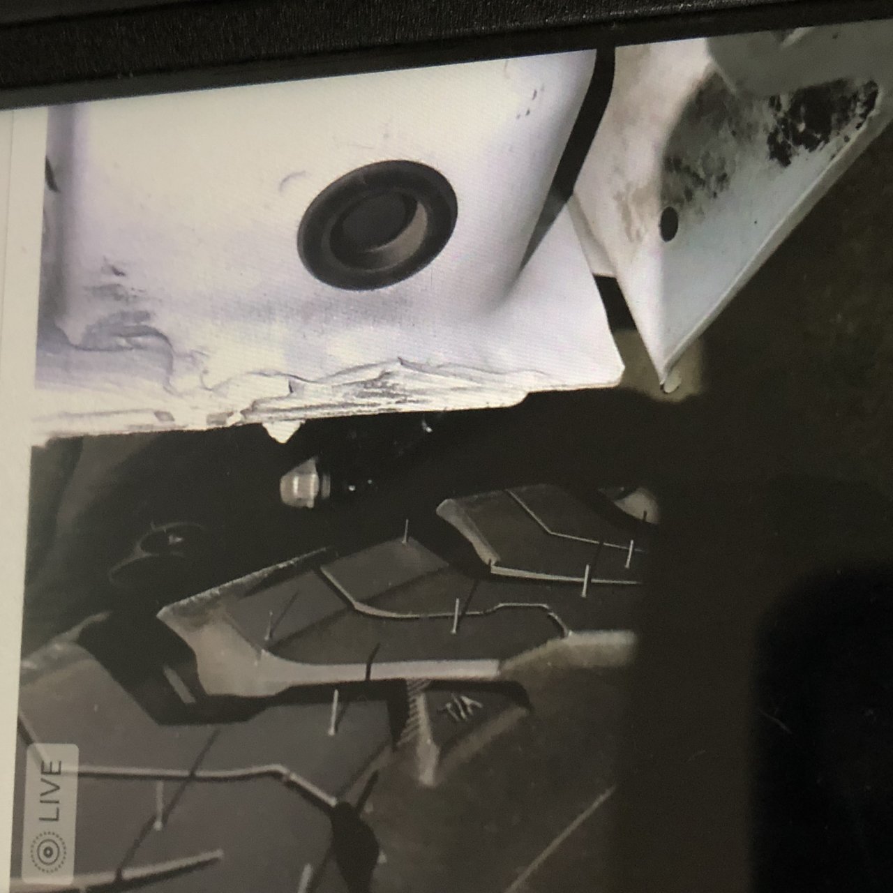

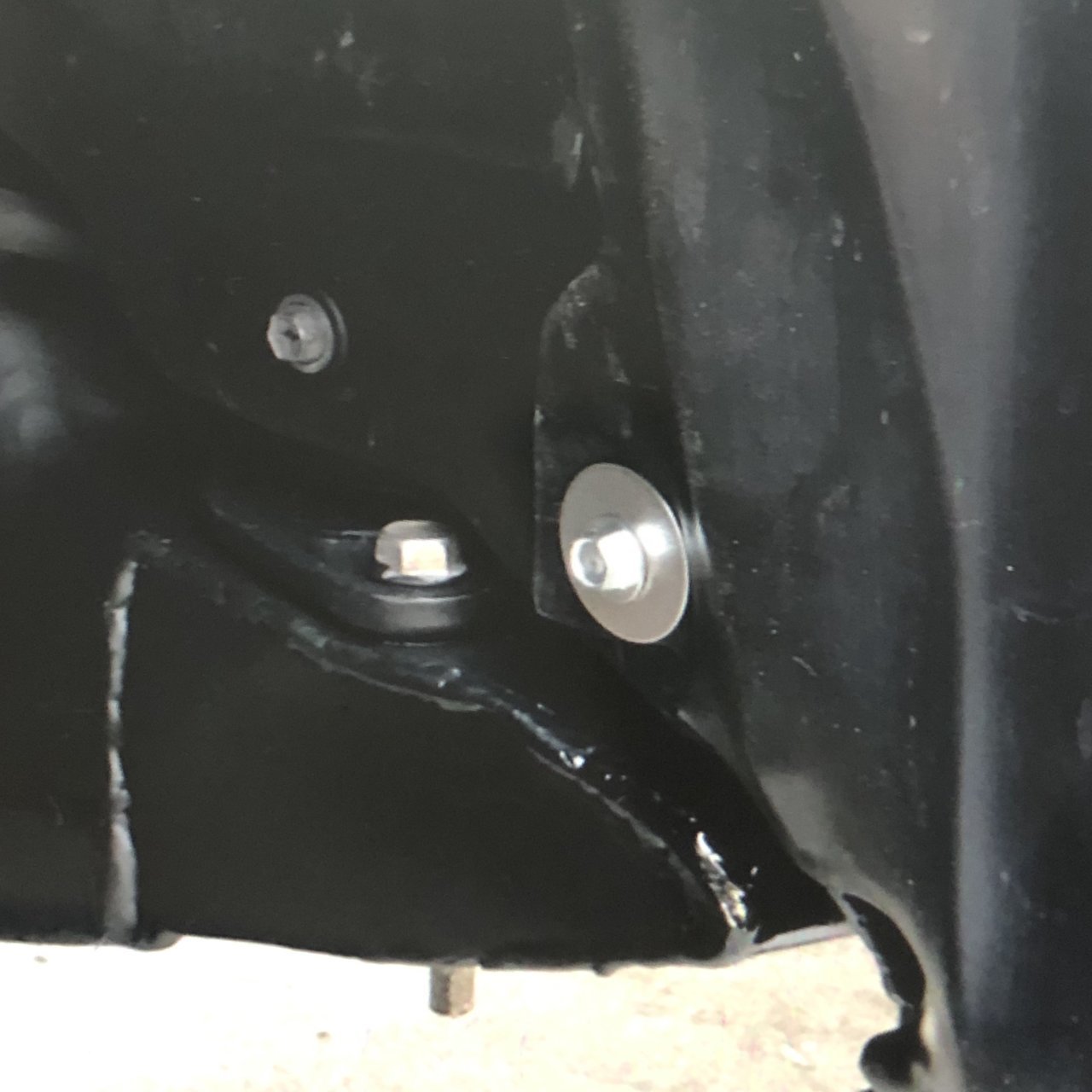

    Here’s some photos on possible mods to help fit tires. That can be done a few different ways...
    Good luck fixing any rubbing issues
