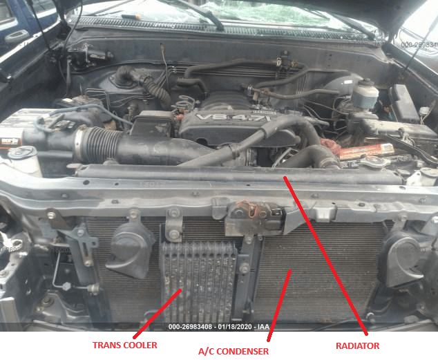

    FYI. It'll have both the radiator cooler and a separate trans cooler with the tow package.

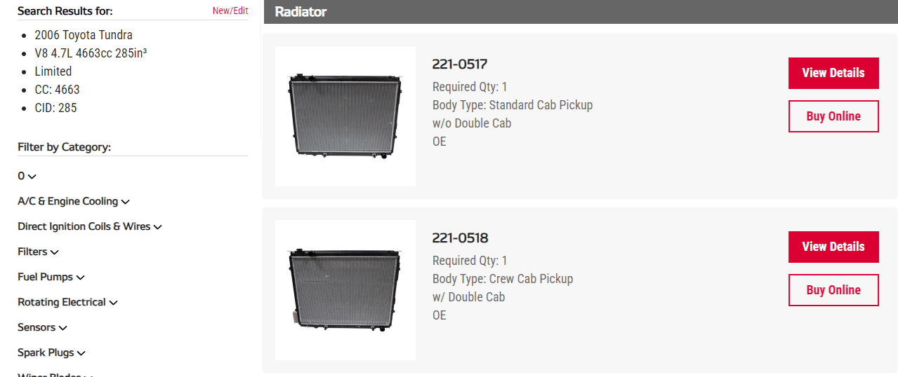

    Is this the unit from Denso?
    So all I need then is a new radiator and not a tranny cooler?

    And I'd add to that, it's almost like a sandwich. Trans cooler farthest forward. Radiator closest to the engine. A/C condenser sandwiched in between.
    Yes, Rock Auto will know if you get them on the phone. But that said, I'd always go to www.densoautoparts.com to look up your part number directly, Denso is OEM manufacturer on a number of critical parts (Denso, Aisin, Advics, etc). I'm putting a screencap from Denso's site below with their 7-digit hyphenated part numbers. Note: If you are a double cab (i.e. 4 doors that open independently in the same direction), you want the part number ending "0518"
