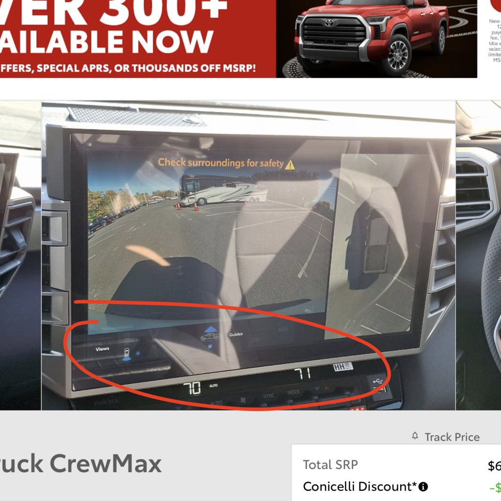

    Ops.. looks like even brand new trucks in dealers' inventory already have this problem. This is an example from the pics they are showing on the website (image looks exactly like the one first posted on this thread):
