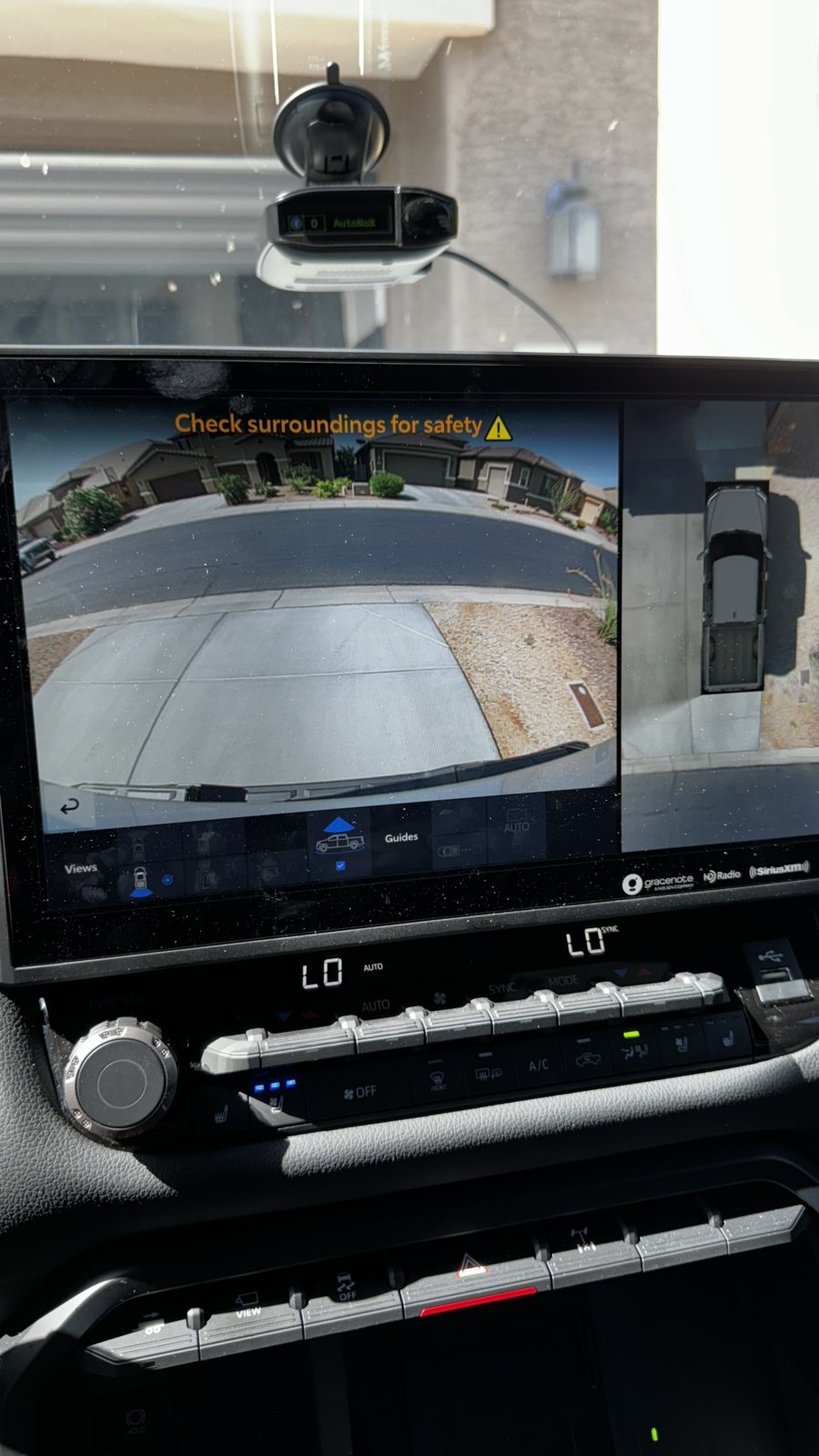

    It took about 2 weeks for the dealer to receive the parking/camera ECU. They installed it within a few hours and had to recalibrate all the cameras. Everything seems to be working now. The ECU itself cost 1200. Estimating the labor cost, the total repair would likely be around 2500 if out of warranty.

    mine doesnt have the one on the lower right side. what does that view look like?

    I had that on my first 3 Gen with TRD Off-Road, it stitches images together to represent the ground view under the truck with 2 rectangles representing the tires. Pretty cool.

    Yes, that’s the trail cam that uses the front camera. I have it on my TRD OR. I would assume it’s an OR or Pro thing.
