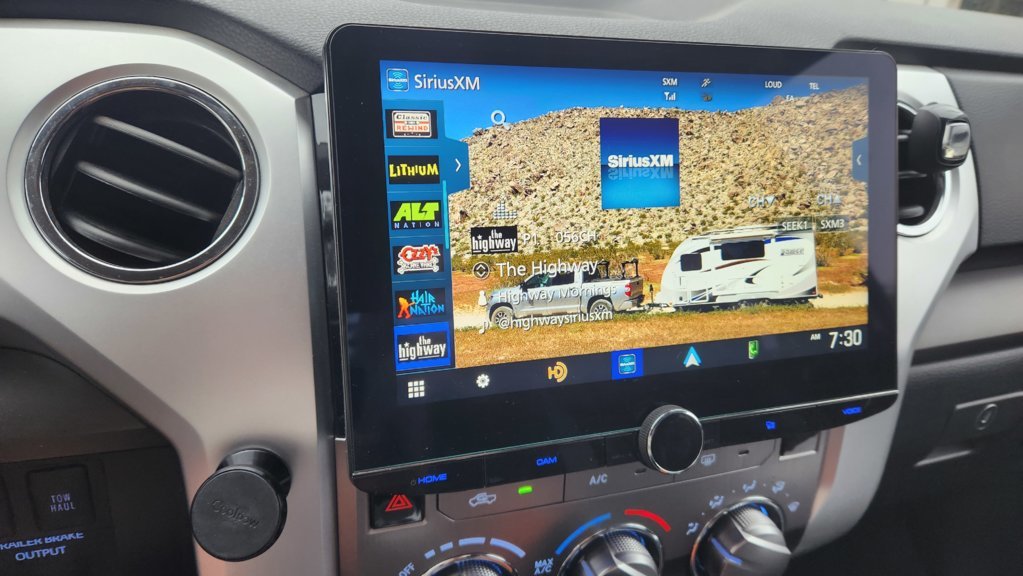

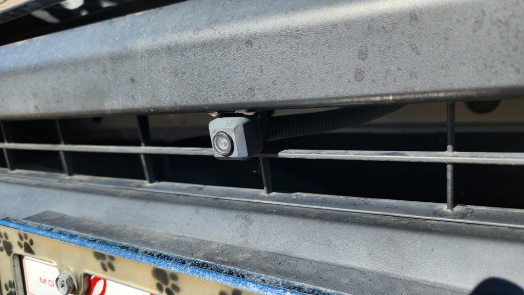

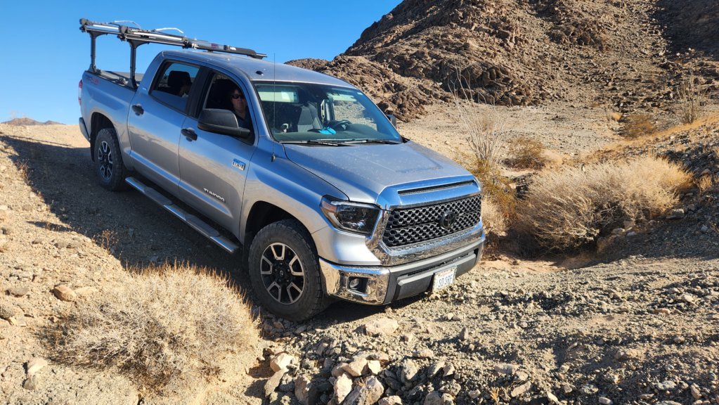

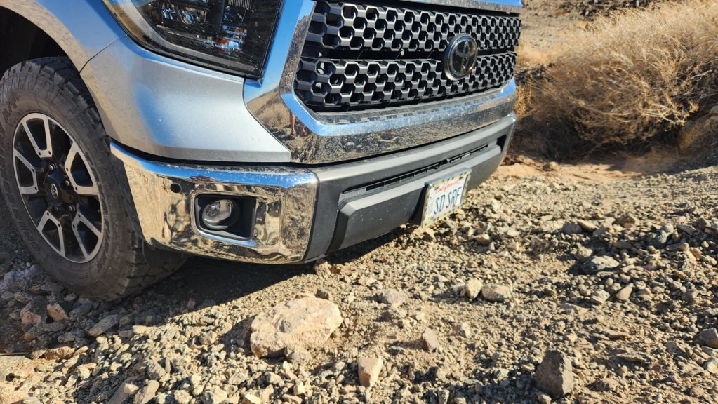

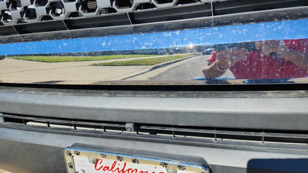

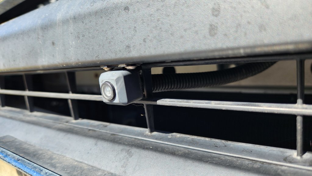

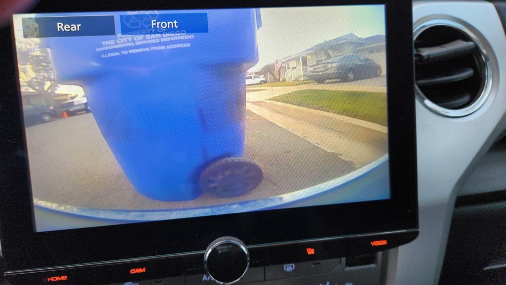

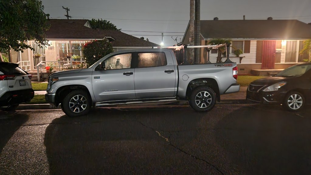

    So this really doesn't specifically answer either of your questions, just food for thought on camera placement.
    I recently added a front camera when I upgraded to an aftermarket head unit and love it, makes life so much easier. One of the most useful mods I've done to my Tundra.
    My camera is mounted down in the valance, much lower view than if it were up in the grill and (while I have no proof of this since I've only ever seen the view I currently have) I think down low provides a better perspective for my intended use, which is primarily for parking this big beautiful pig. (Though it's also helpful for the little bit of off-roading I get to do)
    Mounted where it is, I can actually just barely see the top of my license plate frame in the picture, so as long as I can see daylight between that and the object in front of me (car, wall, dumpster, shopping cart, pole) then I know I'm good, and can easily get within a couple of inches.
    If it were mounted higher I'd see the back of the car in front of me, but not sure if I'd see the bumper of said car, which is what I'd contact first.
    The camera has a little bracket on it and is attached with a couple of small self tapping screws.
    I had it done at a stereo shop and they put it where they put it. I had no input on placement, but I like it.
    If you can maybe connect it before mounting and tape it in a couple different spots to see what view you like best?
    Just an idea based on my limited experience.

    So your camera is (I think) considerably higher than mine.
    Do you have any shots of camera view on your screen by chance? I'd be curious to see the comparison.

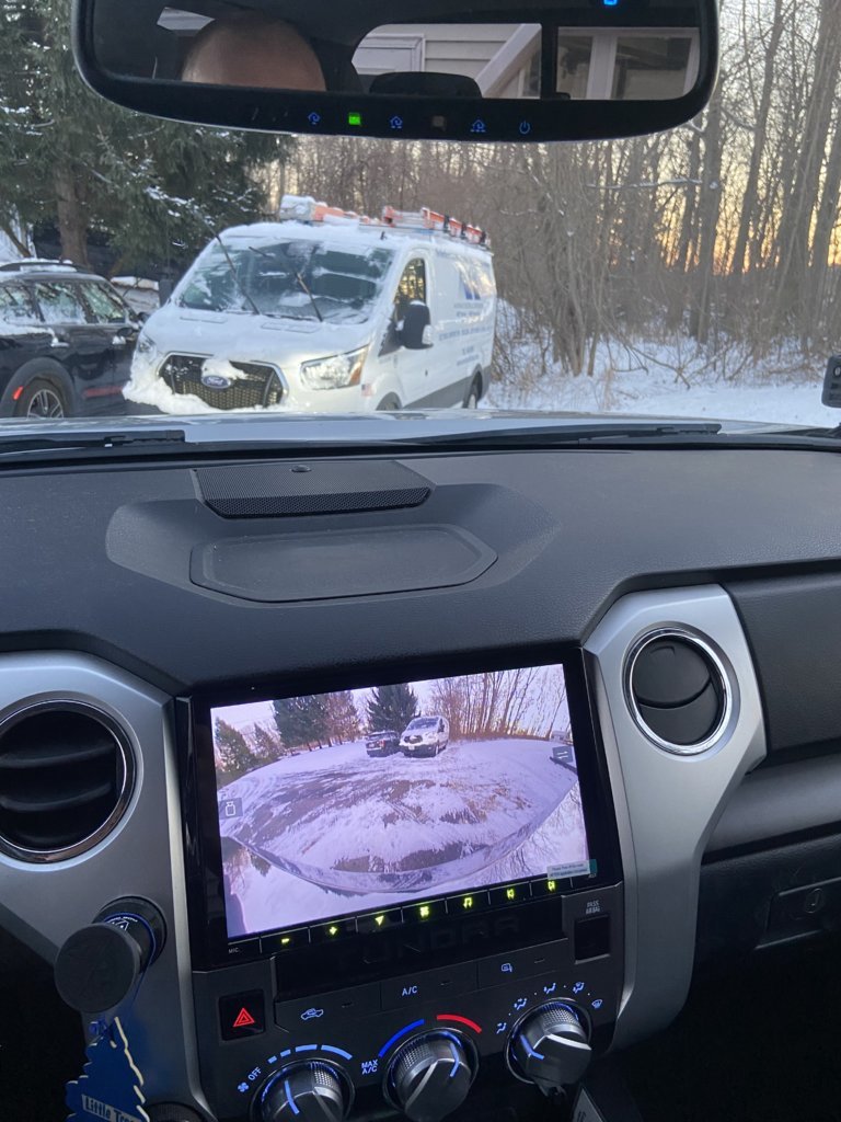

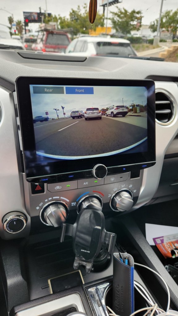

    I don't have the FRAC harness but I connected a front cam to an aftermarket head unit. I'm happy with the camera location. In the pics you can see my vantage point vs the camera.upload_2025-1-15_10-35-15.jpg

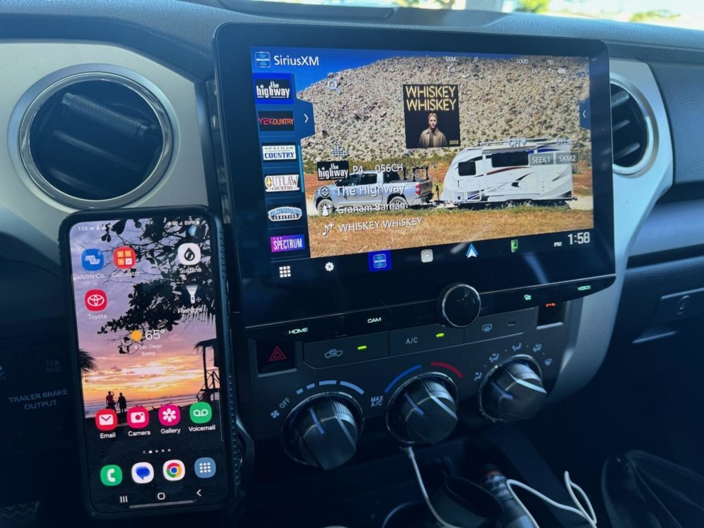

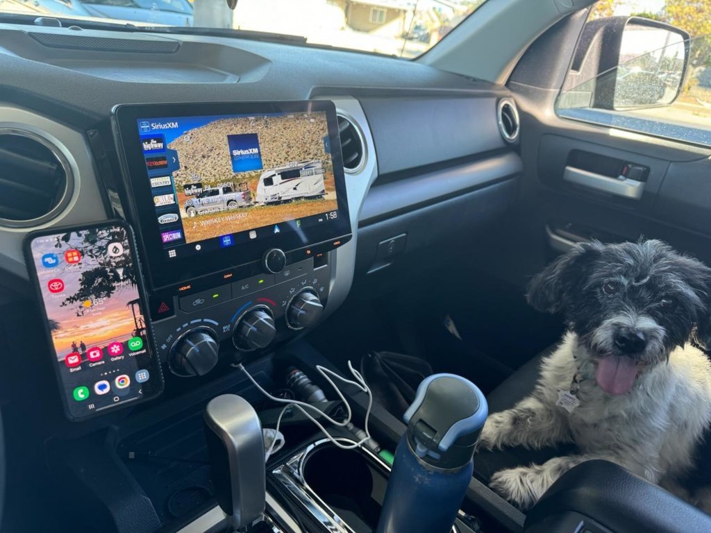

    I have the same (or similar) phone mount,,, love it! I tried a few different phone holders and there was something that bugged me about all of them till I got this one.

    Yes, the magnetic phone mount is great! I bought one made by Mob Armor, seems to be great quality and is super strong

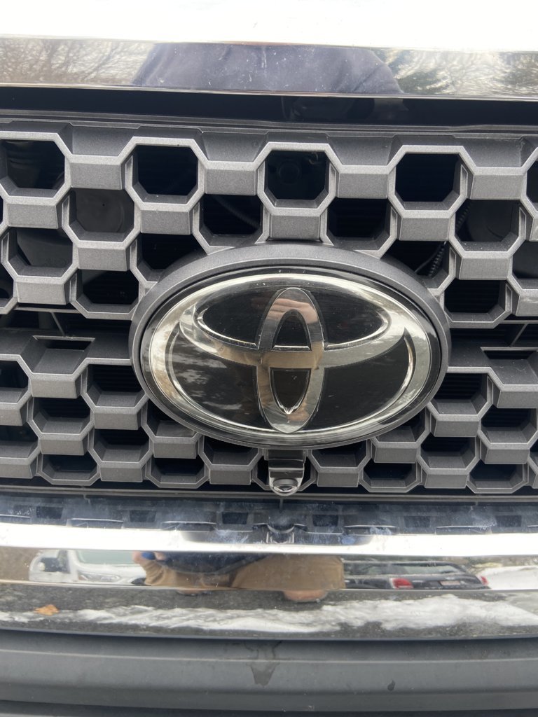

    I’ve actually just made my own custom camera mount to fit under the Toyota symbol in the center slot of the honeycomb. It’s a rough first try but it snaps in tight and is easily removable with no need to drill. Going to clean it up on the second or third attempt and get dimensions perfect. I’ll post a photo when it’s finalized.
    I went with the Offroam mount. Working good for me.
