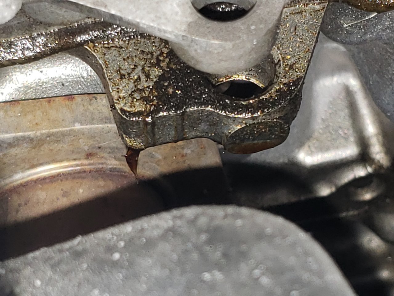

    Well you can add me to the list of victims. Took my truck in today to have a 30k service done and they found it. Covered under warranty and they gave me a free rental due to two day eta

    Flyinryank , are they ripping open your engine to fix it? Are they going to fix both sides while they're there?

    Good question. He mentioned them having to take it apart. Well see

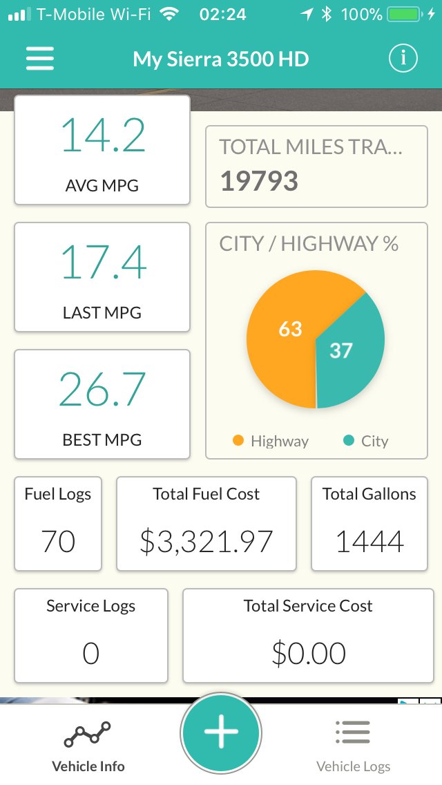

    Here is a snapshot of my 3500 fully. My average for the life of the truck is 14.2 mpg on a diesel? Again, most of those miles had 8500 lbs or more behind it running 75 mph in CC. I wouldn’t pay attention to the 26.7 mpg, it’s the exception to the rule. When I am actually empty and running only partial 4wd, I get 20-22 mpg. That is rare that I do run empty though. Most of the time, 14-17 is the normal. Hell, I have been down to 9.7 mpg in nasty wind.

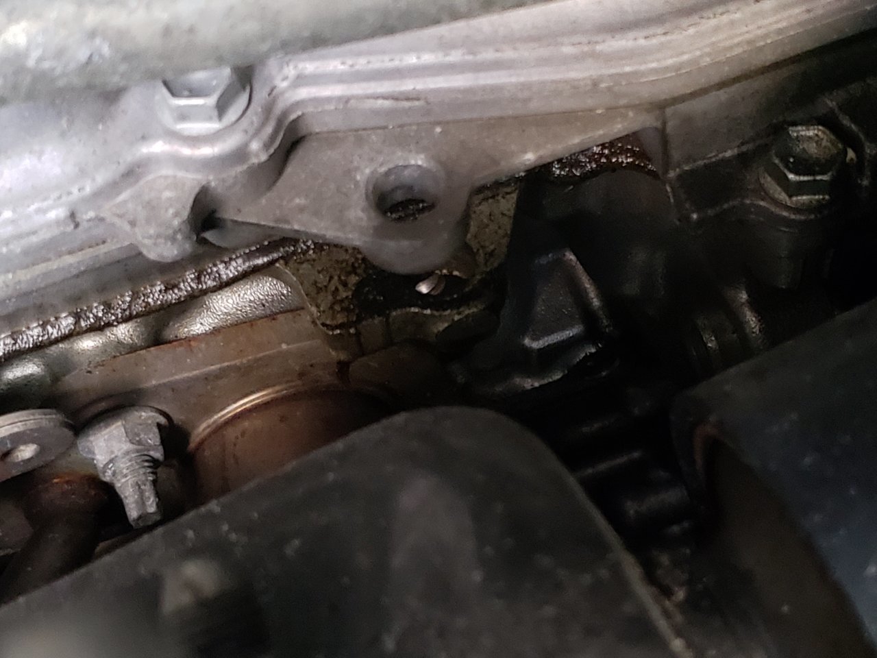

    7150 miles and I found my passenger side cam tower is leaking. DO any of the phoenix Tundra owners have a recommendation for a good dealer to take my truck to for the repair?

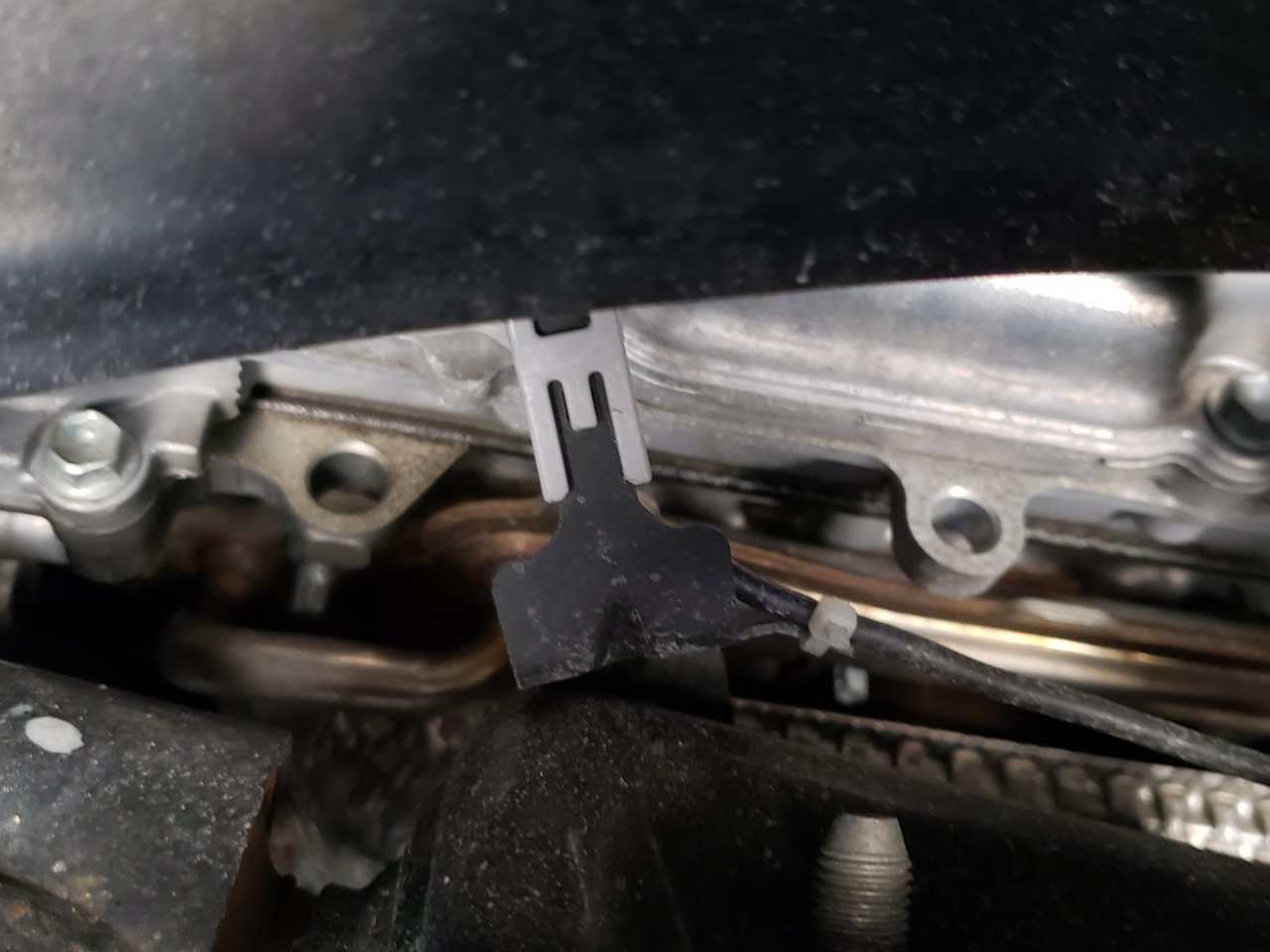

    Tundra SR5 DC 2016 Upgrade: pro wheels, headlights retrofit, head unit Kenwood 694s, bed cover, lineX, Viper security and starter system, pro grille, tinted windows, LED lighting, black wrap on all end chrome corners, ceramic coating

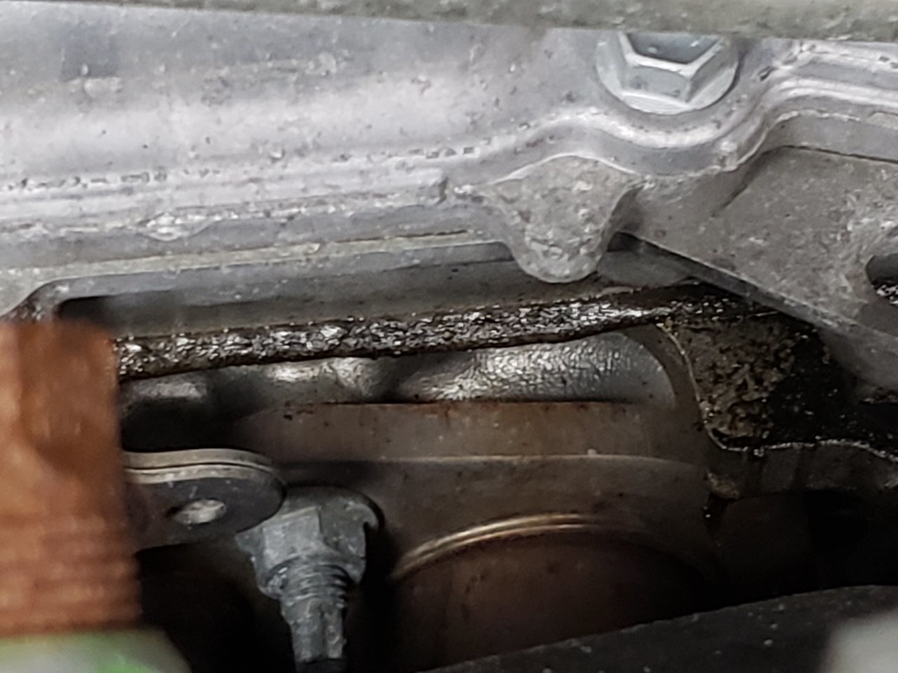

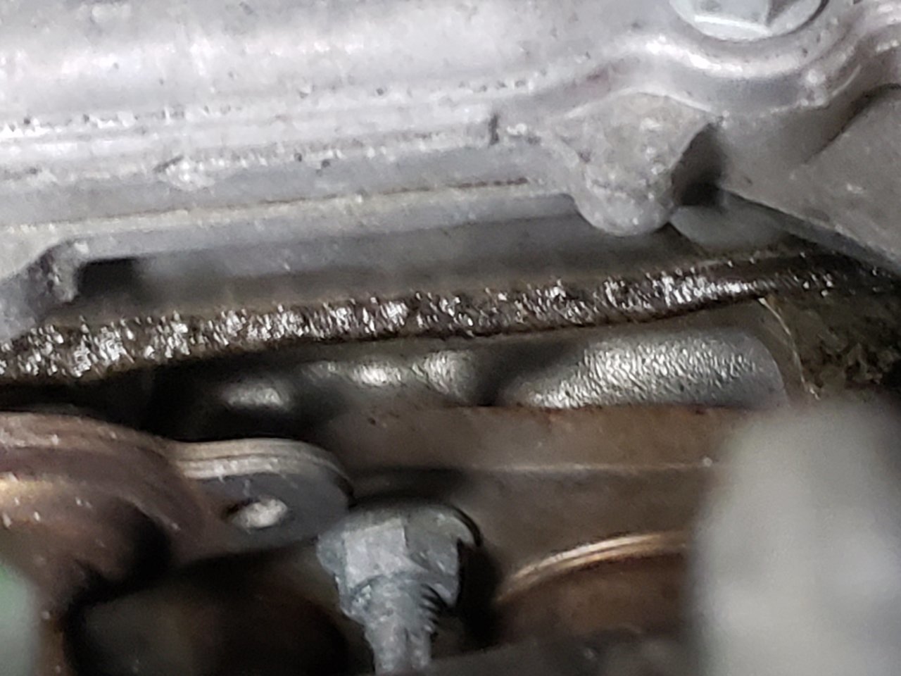

    2016 SR5 28000 miles. I guess I'm now to the group with the leak issues. Both sides appear to be leaking and passanger side is worse.
    Do any of the Chicago Tundra owners have a recommendation for good dealer to take my truck to for the repair?
    Would these be the right angle for pictures.
    Y0TA PR0 and TheBeast like this.
  21. Apr 8, 2018 at 5:11 PM

    yep that's it. Yours is pretty bad.

  24. Apr 8, 2018 at 8:08 PM

    @LKSR5-14 how did you notice it ? did you happen to look there or was it this thread on the forum that made you look there ?

  26. Apr 8, 2018 at 8:52 PM
    #536
    LKSR5-14
    LKSR5-14 New Member
    Feb 8, 2017
    #6265
    318
    Chicago Northwest suburbs, Illinois
    2016 Tundra SR5 DC
    Actually looking on this thread I decided to take a look like many of us on here. Very disappointed and frustrated that this happened and now need deal with service guys that always play stupid around me here in IL
    TheBeast[QUOTED] likes this.
  27. Apr 8, 2018 at 8:55 PM
    #537
    LKSR5-14
    LKSR5-14 New Member
    Feb 8, 2017
    #6265
    318
    2016 Tundra SR5 DC
    Yap very disappointed, passenger side is worse. I just scheduled appointment online with local toyota dealer service. I hope they would have mechanic with good knowledge what he is doing and I'm afraid how he will do the job. Ufff

  29. Apr 9, 2018 at 3:34 PM
    #539
    TheBeast
    TheBeast The Beach
    Apr 27, 2016
    #3246
    12,576
    SoCal
    2012
    make sure they don't just do the valve covers. They need to do the cam towers. I would think the Master Tech will tackle the issue.
    LKSR5-14 and Y0TA PR0 like this.
  30. Apr 9, 2018 at 3:46 PM
    #540
    LKSR5-14
    LKSR5-14 New Member
    Feb 8, 2017
    #6265
    318
    2016 Tundra SR5 DC
    I hope they will do it tundra is left at service. Also at description of the ticket is mentioned cam shaft tower seal leak so I assume they will know what to look for
