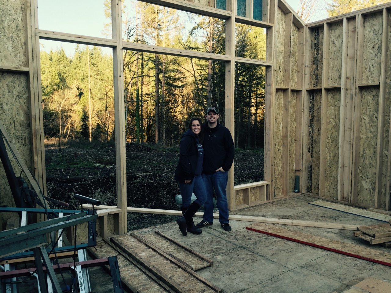

    One of my favorite things was putting in a garage door - on the back side of the garage. Kids can access all sorts of things in the garage - and I can move very freely from front to back.
    Dinning room was designed for a 13ft table - and the Kitchen island is 12ftx5ft.
    Super nice for serving at parties.
    Did a wood fire in the kitchen/dinning as well. Ambience lol
    The wood stove in the great room is a FPX44 Elite (holds 3ft logs) heats the entire house in the winter with 3 loads/stocks per day. Highly recommend a good wood stove in the colder regions.
    I did every ounce of landscape/grading - with a 53hp turbo diesel Kubota. Took 100 dump truck loads to bring up the back yard :)
    Oh!!!! One other thing! Every piece of exterior board, we did in Hardie Plank so it will never rot. All of the trim boards and everything - all cement Hardie.
    Oh! The wife let me do OD Green for base color and Flat Black for trim LOL!!!’
    Kids bath - separate sinks for getting ready, with a door between shower/toilet. So when they get ready in the AM one can be in shower while other doing hair/brushing teeth.
    Nearly every closet has an area for a broom/vacuum/long item.

    Thanks! There are much more nicer, but we are very thankful and grateful we were able to build our dream. My wife and I are high school sweethearts - took 15 years of hell, but it was worth it :)
    We built it Exactly the way we wanted.
