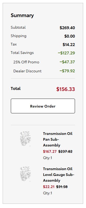

    I just wish the 2005-2006 with sealed transmission could be retrofitted with a dipstick to make that possible :D

    Ooof. Gotta change the pan :(
    I know it's not a lot of work. And MSRP on the pan isn't bad (~$272, but goes on sale for ~$170 periodically).
    You'd also want the gasket or proper FIPG.
    Weagle likes this.

    Yup, just edited my post to that effect while you were replying.
    But one snag: It appears the Tube part is no longer available in USA. It also appears at the time of this reply, Amayama would have it in-stock as an assembly using the updated part number below, ~$55 with part and shipping. (Here's a reference from EPC)
    All-in you could pull this off during a sale for less than $400. Maybe less than $250 with the 25% off sale. Parts, through my preferred vendor that doesn't charge tax or shipping for non-AL residents:
    Pan: 35106-60160
    Tube: 35013-60150
    Dipstick: 35103-60220
    Or you could just pilfer the parts from a 2002 Land Cruiser or LX 470 if the door sticker shows it's a A750F on the driver door sticker.
    Pricing update on the two domestically-available parts, during the current national sale:
