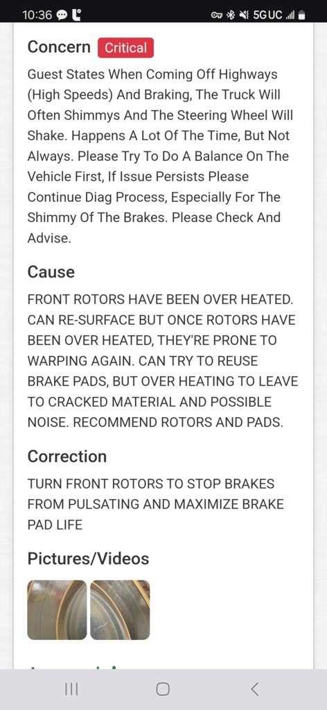

    Just brought my truck in for its last free service with 15,000 miles on it. Been having some shimmy issues when I get off the highway and would skweak when I come to a stop. I was just told that my rotors are warped and the pads need replaced.
    Service manager refused to warranty out the breaks. Looking at over 700 to replace.

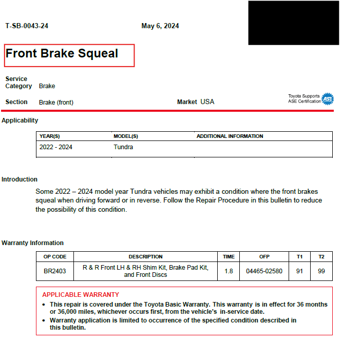

    So was able to get my pads and rotos replaced under the TSB T-SB-0043-24 but I had to really fight with the dealership to accept it. When I first reported the issue to the service tech I told them that the breaks were squeaking when backing up and when coming to stops periodically. The service tech wrote down the wrong description and said that the truck was shimmying. Basically my local dealership was not going to replace because they claimed that I said shimmy and not squeak so that's why they didn't bother to look up the TSB.
    Luckily the original service tech that checked me in told the service manager that they had entered the wrong description and that I did say squeak and not shimmy. They made it right in the end but it was a fight.
    If your breaks are squeaking when coming to a stop or backing up, make sure to use the following TSB and tell them that they are Squeaking or Squealing. Those are the magic words. The TSB covers your breaks up to 3 years or 36K.

    My dealer had no problem with my description and after a tech verified the squeaking they ordered the kit and are replacing everything next Thursday.
    I had the fuel line recall done and mentioned the brakes.
    Having the TSB printed out and on the passenger seat may have helped. :)

    Did this fix the squeal? My dealer said Toyota stopped replacing because it wasn't fixing the squeal and they are looking at other options.

    I would dispute this with your dealership. This is an active open TSB that affects 2022-2024 model Tundras. If they are refusing to repair or replace then you may need to take it to another dealership.

    As an FYI, T-SB-0043-24 is now OBSOLETE and T-SB-0022-25 has replaced it. The only change is that the 2025 model year is now included.
