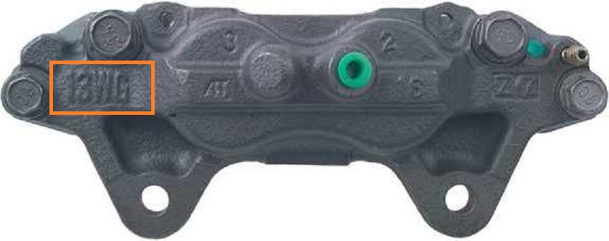

    I know you did and appreciated the line of thought, but the hiss was definitely coming from the pedal area, we weren't hearing pad noise. Maybe the stuck piston is causing the booster pressure/hiss issue.
    So now what should I do? Would the Sequoia benefit from the 14WA conversion... looking in the thread now for purchase source and info? Looks like a new oem caliper from Sparks is $250, vs conversion cost. I did just put new rotors and pads on in July so I hate to eat the rotors but if the upgrade is worth it I will?

    Or fluid boil, building pressure, and it's hissing past the MC cap. Check for signs of blow-by on around the perimeter of the cap?
    Does it currently have 13WLs or 13WEs or other?

    Honestly I'm not sure, how do I check, by VIN I'm assuming?

    It's stamped on the side of the caliper

    Going out the look for caliper model now. He also said the brakes shimmied will going down on of our big bridges the other day.

    Look on brake line side of the caliper, what's embossed?
    If 13WE, 13WL is an easy, no-machine (thus cheaper) solution to really improve braking and I think the only "aha!" is you'll need to trim the dust shield a hair.
    Going to 14s is a bit more cost intensive, need to pick who to machine them to make them bolt up square, and they need to know how to do it right. I don't think it's worth it, but I've got 13WLs... and they're better performing than any other brakes on a truck I've owned, so I'm biased.
