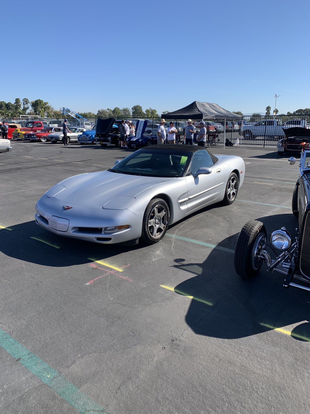

    She's a 2002 C5 Base.
    What year is your Tacoma and Corvette?

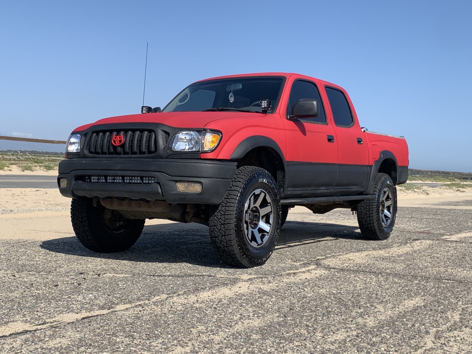

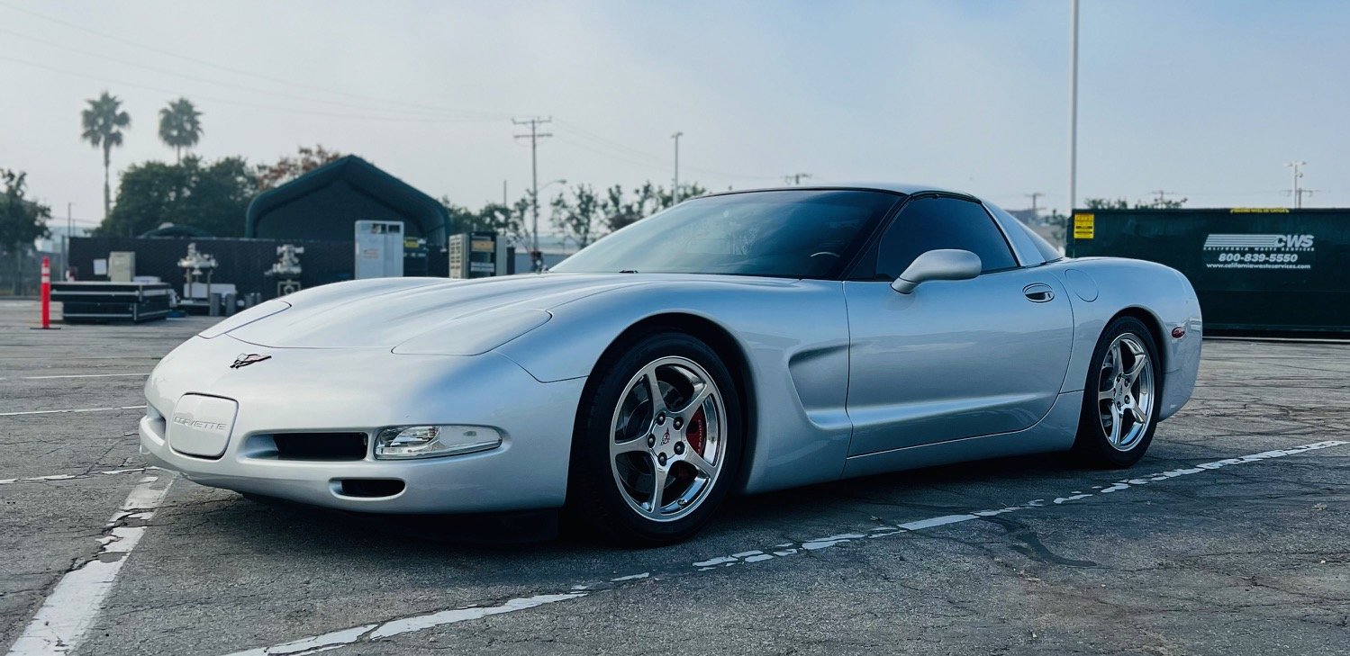

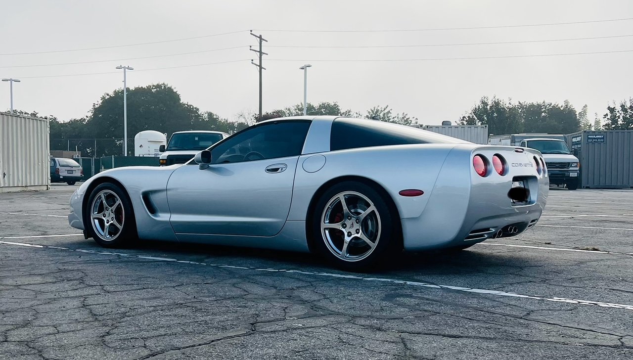

    01 Taco, sold that after getting the tundra recently
    Hell yeaaaa for the C5. Mine’s a base too, 1998 with 43k miles. I’m jealous of your hard top and those wheels
