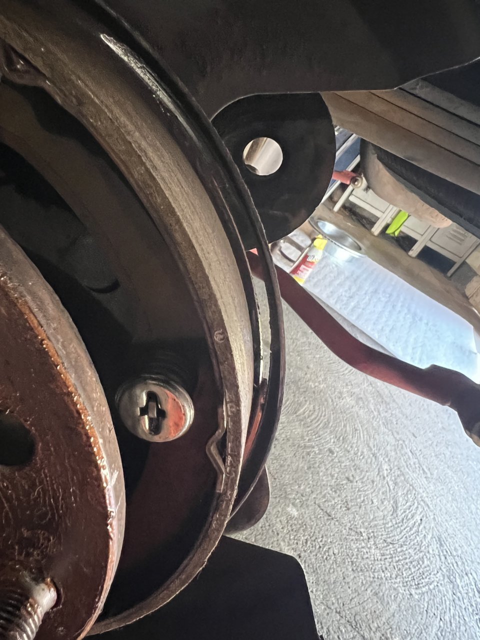

  7. Aug 9, 2022 at 3:02 PM
    #37
    chaosbooboogunner
    chaosbooboogunner New Member
    Oct 17, 2021
    #69479
    27
    Dennis
    2012 Tundra Crewmax White
  8. Aug 9, 2022 at 3:35 PM
    #38
    chaosbooboogunner
    Oct 17, 2021
    #69479
    27
    Dennis
    That’s the drivers side, passenger side looks the same. Wish I would have checked the forum first.
  9. Aug 9, 2022 at 6:38 PM
    #39
    Bucks04
    Bucks04 New Member
    Jan 27, 2018
    #12467
    508
    2013 TRD Tundra
    Working on it
    Just check rims on drums for large rust build up and grind them smooth. And then all you should have to do is bend the backing plate outward, for clearance. Usually the drums get large rust deposits around the rim that will cause this. Or if you drive on gravel , rocks can get caught there. Also make sure the axle is clean all around studs, before sliding drum back on .
