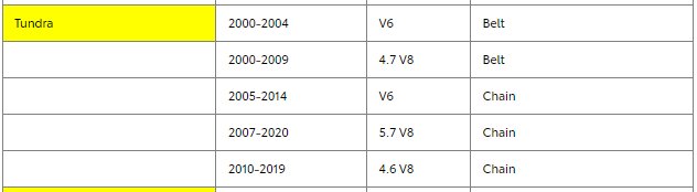

    The default assumption by many on here is "V8" (2UZ-FE) which had a timing belt. And the earlier model 00-04 with 3.4L V6 (5VZ-FE) also had a timing belt. I don't think as many are familiar with the VVTi 4.0L V6 in the '05-'06 (1GR-FE) have a chain. I'd prefer the VVTi V6, quite frankly, if I had to have one. Wonder if they made the 05-'06 with the 4.0L in a manual 4WD?

    It's only an issue if it breaks. I assumed V8. Sorry.
