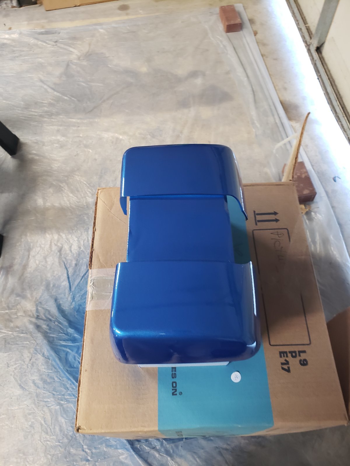

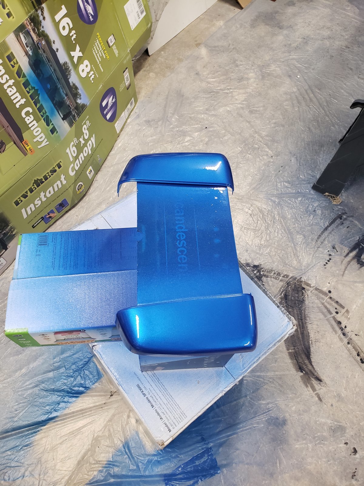

    The caps for the paintable version came un-installed in separate packaging. So it would be easy to just take those to get painted. They just snap into place so if you install them and then get them painted, it would be easy to pull the caps off. I've had no issue with them coming off and its been 2 years (I think, its a blurr). I love the mirrors and like that it puts a turn signal on the front of the mirror and in the glass, and the added wide angle lense really helps with your blind spots. I have soo much more awareness with these mirrors. Love them.
    I painted my caps in my garage.
