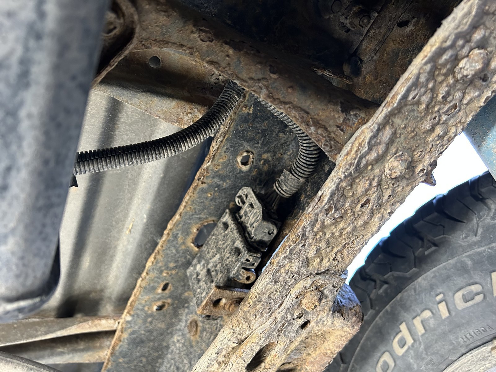

    Yeah, that made me chuckle. My Gen2 has been a good truck but had it’s fair share of issues that come to mind:
    • Brakes gone at 5k
    • Electronic Shift controller
    • ABS Sensor mounts decoupled
    • Electronic Shift Controller (Yes, again)
    • Rear axle assembly/seal/bearing
    • I don’t recall what it was, related to distributor but on left rear frame, see pic. This one left me stranded far from pavement and nice long walk.
    She is generally still solid however. I think gen3 will fare just fine over time. Especially against the big 3.

    Fuel pump control module?

    I think you’re right. ‘module’ was one of the words. When first diagnosed I thought, “shouldn’t that be under the hood?”

    This is a PWM amplifier basically. It's purpose is to be close to the fuel pump and amplify a weak EPA-friendly signal from ECU to a strong 12v PWM required by the pump. Could be a generator, if the communication is more advanced, like LIN, I2C or SMBus.
    Gen3 has a similar one, too. Don't know where it is located.
    But you gave me a good hint what I need to carry in my offroad zip kit. Non-Toyota branded once are like $50.

    I wouldn’t call it an amplifier as my understanding is it provides the 12v from a separate wire/source.
    You can jump wires and completely bypass the module that dials down the fuel pump. A plug-n-play bypass module is what I’m referring to.
    https://www.tundras.com/threads/fuel-pump-control-module-ground-side-circuit-voltage-drop.63638/
