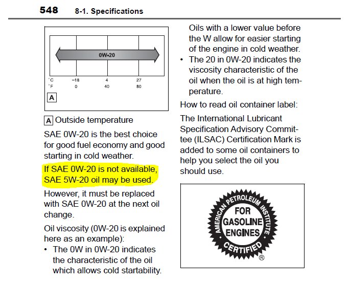

    I live in SoCal, so I use 5w30. 5w30 is still good enough for winters though, down to below zero. I like 5w30 over 0w30 due to the 5w30 being cheap for one thing and also having much lower NOACK volatility.

    You are looking at the Tundra US manual. I posted the manual for 2023 Land Cruiser, outside of the US.

    I know. I was merely pointing out that the difference between the two is interesting. Sheesh. :rofl:

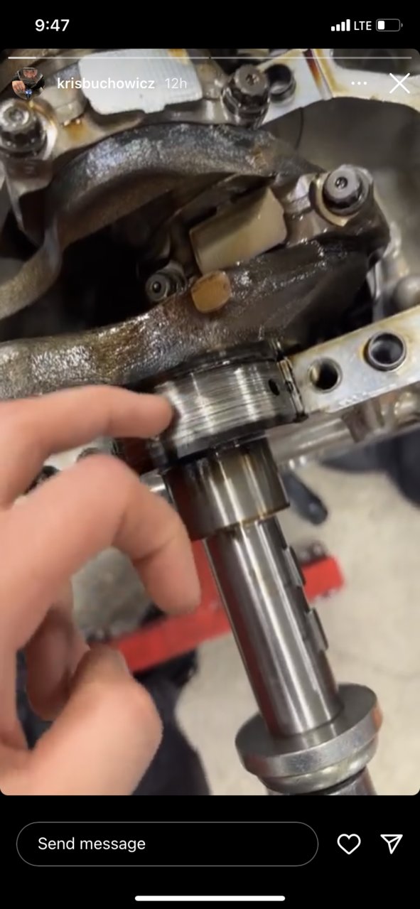

    Here is another one on Instagram a guy who works on a Toyota dealership and is working on a 2023 tundra with a bad main bearing.

    Closer screenshot

    The other side

    At mileages this low a 10K OCI vs a 5K OCI shouldn’t be making a difference. That kind of service interval difference should show results for long term owners past say 150K miles, maybe sooner on a turbo engine but not in under 50K miles. Plus a difference in OCI shouldn’t manifest in spun main bearings as the first sign of trouble. An engine that is neglected with overly long OCI’s will probably start consuming oil before anything else as the oil control ring and other piston rings coke up and no longer make a good seal.
    Same for 0W-20 vs 5W-20, or 0W-30 etc. A look at oil film shear strength between those weights as well as viscosity at operating temps, they’re not as drastically different as we all might think. Maybe past 100K miles you would see a difference, probably with indifferent maintenance, but not under 50K.
    If those assumptions are wrong, and the engine is on the bleeding edge of reliability vs catastrophic failure due to oil breakdown due to 5K vs 10K OCI, or a slight difference in oil film shear strength or viscosity; then the engine has no place in a mass production vehicle.
    Being a truck engine, and not a high strung race engine I have to assume there is plenty of safety margin built in to allow for somewhat varied oil viscosity, and additive package breakdown over a 10K OCI.
    Spun main bearings are usually either bad bearings that are materially out of spec, or an oiling issue where oil is not reaching the bearing surface. There is a slim possibility that the engine is so unbalanced that the crankshaft at one end is flexing and hammering the dog piss out of the bearing (usually the very front or rear most bearing). If it’s that out of balance though I can’t imagine the driver wouldn’t notice it, but maybe the motor mounts soak up vibrations so well a guy might not.
    I still suspect a bad batch of main bearings, or flawed block castings with obstructed oil passages.
    Either way some pretty unacceptable QC/QA these days.

    I have in my time opened quite a few engines - mostly machines built pre-85 thanks to ever improving techniques meaning it's not something that one usually has to concern oneself with nowadays, motorcycles being the most common due to the much higher stress factors involved.
    The thing I find crazy about that pic isn't so much the damaged shell but the fact that the other three look as one would expect for a low mileage engine. Usually when you open up an engine if you are going to see one wrecked shell you'll be seeing all wrecked shells. Oil starvation across the board wasn't too uncommon back then but to my eye that looks suspiciously like you have a tolerance issue. Either way, with the way stuff is machined today if you have either oil or tolerance issues then it's almost certain that so do x number of other blocks or cranks that were produced in that same run

    Yes, repeatability is both the beauty and the curse of modern manufacturing. Also, why these forums are valuable.

    On a 2023? Crap. I was hoping this was an early batch of bad bearings.

    I noticed that too. The other bearings look totally normal. Not what you would see if all the oil was breaking down, or all the bearings were defective or parts were dimensionally incorrect.
