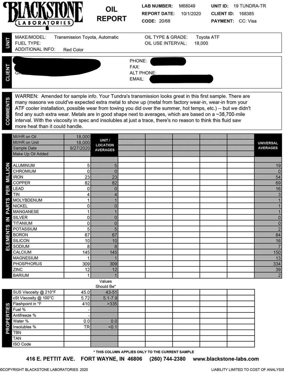

    Here's Blackstone's revised report based on more details about my Tundra... Even better than the original...?

    Damn @Greg Marmalard - Mandy would be proud of your ATF! Excellent report.

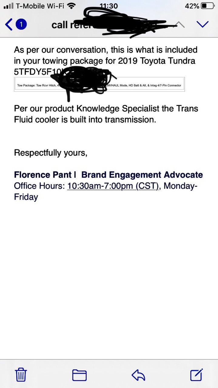

    I called toyota corp in plano tx, this is what they told me.

    It has one.
    Once the ATF is higher temp than the coolant, heat is removed from the ATF into the coolant.
    The puck is dual function based off temp.
    They, the sticker, etc in reality did not lie. Just because you, the user, have a different "view" or definition is not Toyotas fault.

    Thanks for the info, kinda makes you wonder about the head mechanics knowledge. Seems he better re-read his manual.

    Flash point is at 410?

    This is great news, thanks OP for submitting your fluid for analysis. Seems we will need a bunch more heavy tows here with higher mileages to do this before we either relax, or continue the panic. Thanks again for the test.

    Wow , I just checked one sticker online for 2021 and they no longer mention engine and transmission coolers.

    Great test results. Scientific proof the new method of cooling is effective.
