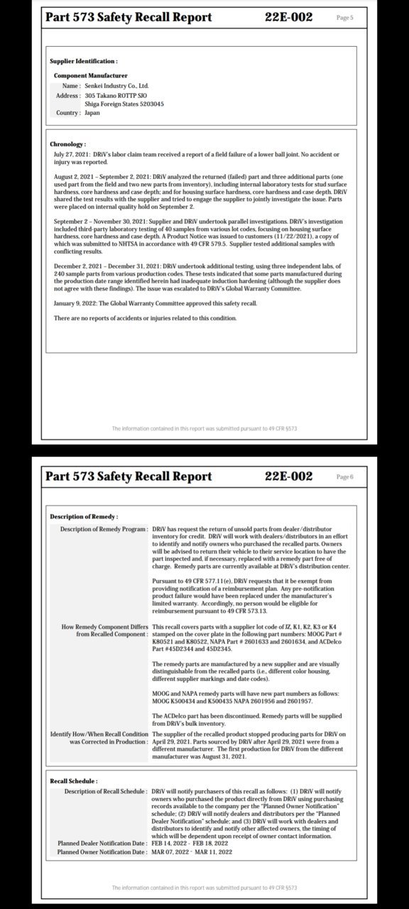

    https://www.tundras.com/threads/fyi-moog-recall.101454/

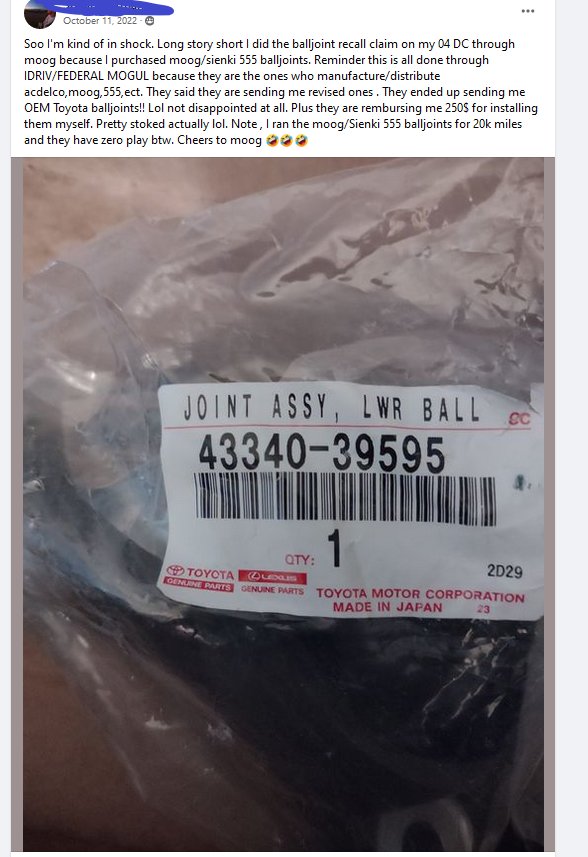

    Moog isn't what it used to be, they outsource their parts to smaller warehouses in China mainland now. The end result is what @des2mtn just showed you with the recent massive recall on Moog LBJ. Note it's a Moog part, but wasn't made by Moog - here's a link, make sure you aren't affected: https://static.nhtsa.gov/odi/rcl/2022/RCONL-22E002-1411.pdf
    One of these guys was using Moog LBJs also, you want to take a guess which one it was?: , , link, link, link, link, link, link, link
    But hey. Live your life however you wanna live. If less than $200 is stopping you from swapping in OEM LBJs and fresh bolts for another 10-20 years of failure-free service, then bless you brother. I'm sorry you're stuck using non-OEM when it's been proven, exhaustively, that you should avoid 3rd party for this specific part, which is arguably the Achilles heel of these trucks.

    I think they're actually sending out OEM ball joints for those that are affected so if you have Moogs you're really doing yourself an additional disservice by not looking into it.

    Ha!! Even Moog realized their parts can't stack up to OEM, and OEM is probably about as cheap if you buy the Toyota OEM LBJ recall package part# vs. buying each OEM LBJ separately.

    I'm using Moog part # K90262 and K90263. They are not part of the recall. Gen 1 Tundras had 3 different part numbers. My truck is from 2001. They were the originals when I took them in for the recall the boots were already torn
