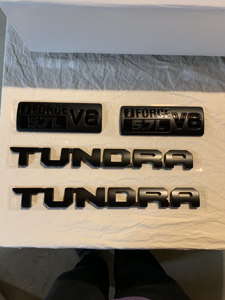

    Just picked up these 5 black emblems/badges (not overlays) and the tailgate insert badge from the dealer. See Oem part numbers in pictures if you need them.
    I got the dealer to include them when I bought the truck and they just came in. Now I just need to find a heated garage where I can attempt to install them or I’ll have to wait for warmer weather in the spring. I don’t think I want to mess with removing the chrome ones in below freezing temps.
    300709A9-21D5-4574-8427-140FBB179AFB.jpg 15258175-303A-4DF0-B944-EDE9AD6247B5.jpg
    One reason I went with the OEM emblems and not overlays is that I don't like how the overlays fill in the "holes" in some of the letters or other gaps with more black so you can't see the paint through them and the badge looks a little blurry to me and not as sharp as seeing the factory paint through all the spaces in the badge.

    Finally finished removing the chrome emblems and replacing with the OEM Black ones. Removed using heat gun on low and fishing line method, followed with rolling the remaining glue off with my fingers (while warm) and then finishing with goo gone and a final clean of rubbing alcohol before reapplying the new badges.
    I’m happy with the result and I like the look better than the overlays.
    I decided to just remove the SR5 badge for now, I might replace it with a black one off ebay, or maybe a black TRD badge or I might just leave it off, I kind of like it now with nothing there.
    Also got my new Lomax cover installed.
    Now if I can just find a way to replace my chrome tube steps, front grill surround and front bumper caps without my wife noticing I'll be done with all the chrome!
    PT948-34150-20 Tailgate Insert Badge- Black
    75471-0C160 TUNDRA Black Right
    75471-0C170 TUNDRA Black Left
    75472-0C070 IFORCE Black Right
    75474-0C050 IFORCE Black Left
    75473-0C050 4x4 Black
