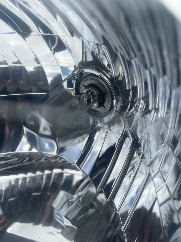

    These are the same ones I’m using and they have been on the truck for more than a year. Light output is great and they don’t blind oncoming drivers. They DO have fans but the fan is inside the headlight assembly which helps warm the outside headlight housing to keep headlights clear of snow similar to a halogen headlight bulb. Installing them is the same as a halogen bulb.

    You won’t be disappointed in those LED bulbs. The pattern is the same as stock with vast improvement in light output annd absolutely do not blind oncoming drivers. I’ve never been flashed once. Easy to install and nothing to modify. I live in a rural area and these have been a great upgrade and the best bang for the buck.

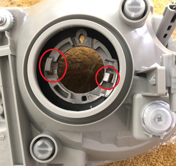

    All right I finally decided to complete this project. The halogens are just so bad, I cannot see pot holes at night to avoid them whenever there's oncoming traffic (even with the upgraded Silverstars), so I'm going to do the mini projector upgrade.
    Here is the kit I ordered. Basically all of the links in all of the threads are broken. I guess they decided to quit Amazon. With the 15% coupon, it was just under $50. I figure might as well order it before tariffs hit...
    Will take great care not to break off the plastic tabs. It seems you must put something in there to break scrunch up the reflector housing. Hope I'm not biting off something too big here.

    This has been an absolute bear of a project. I couldn't get the blinkers off. Broke the lens off of both of them. One cracked when it hit the floor. Currently have them resting with some super glue. Extremely hard to get off. Had to use a screwdriver and pad it to protect the paint. They laughed at me when I tried the slap push.
    @shifty` - do you just skip the dust boot?? There's no way to thread it back on. The hole is way too small to go over the back end of the bulb.
  27. Aug 14, 2025 at 3:12 PM

    I think the old CO lights Shifty and I use had finless heat sinks which unscrewed from the rest of the bulb.

    Yeah there's no way I could get the dust boot onto the light. There's a big fan in the back, and I think even the bulb wouldn't fit if I tried. The hole in the boot is really just meant for a halogen bulb to go through.
    At least I did get the reflector cups out without breaking that damn little tab off. Once I got the blinkers off (absolute bear, breaking both lenses off), the rest went ok.
    I'm thinking about cutting the dust boot so I can wrap it around then just taping the slit at the bottom?? Any ideas from the big brains here?
