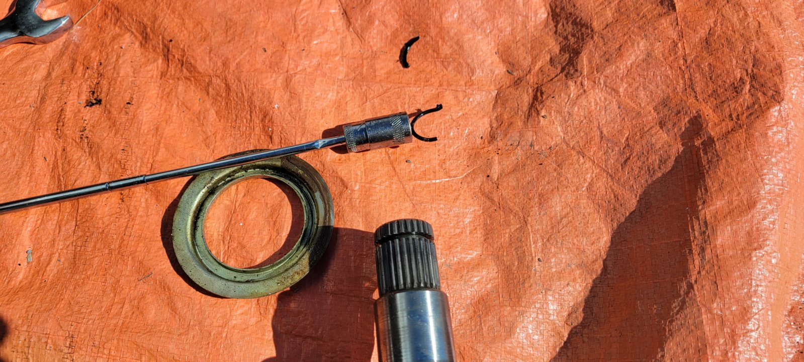

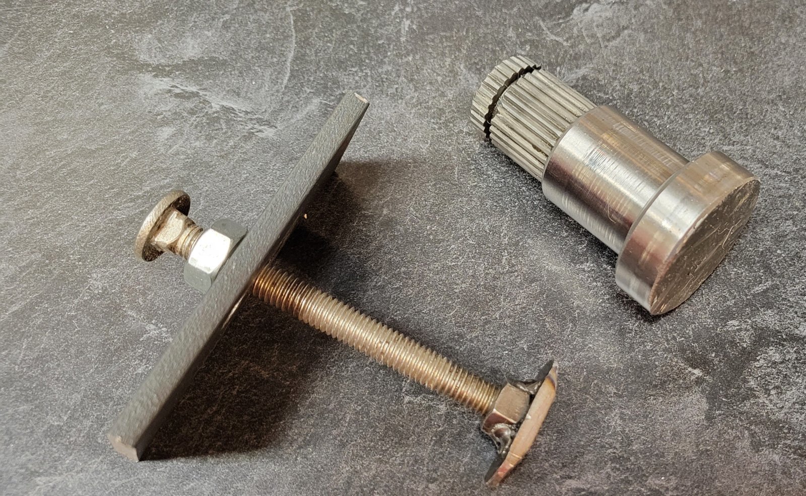

    Caridge bolt is just temp, I need to get a hardened thrd rod for it, the originals threads got a little mangled. Fishing for the ring was a bonus the PO left for me.

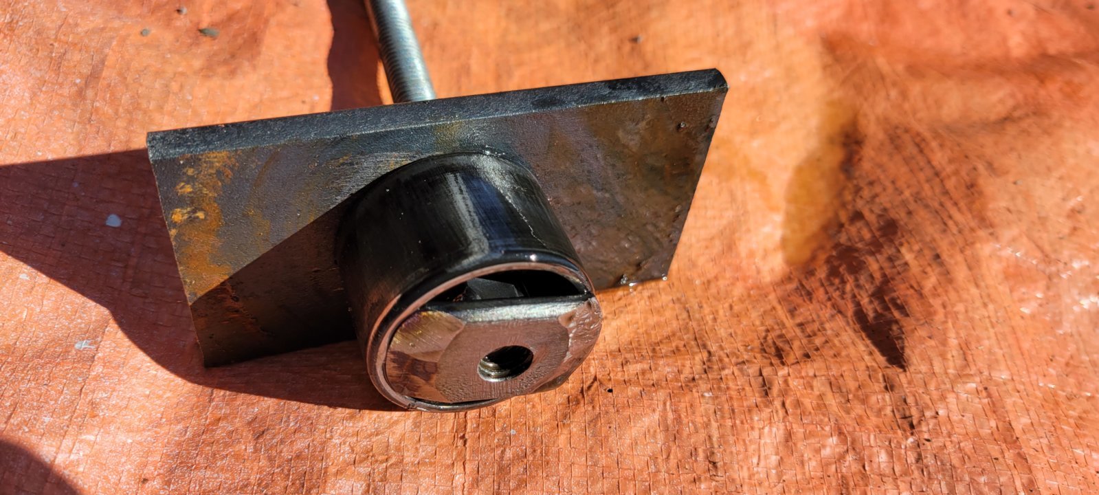

    After about 30 minutes of gently massaging the end piece I was actually able to insert it with the rod attached instead of fishing in there to thread it... bonus. That CV stub aligned the bushing dead on, no guessing, and provided a nice striking surface for the 3lb sledge.

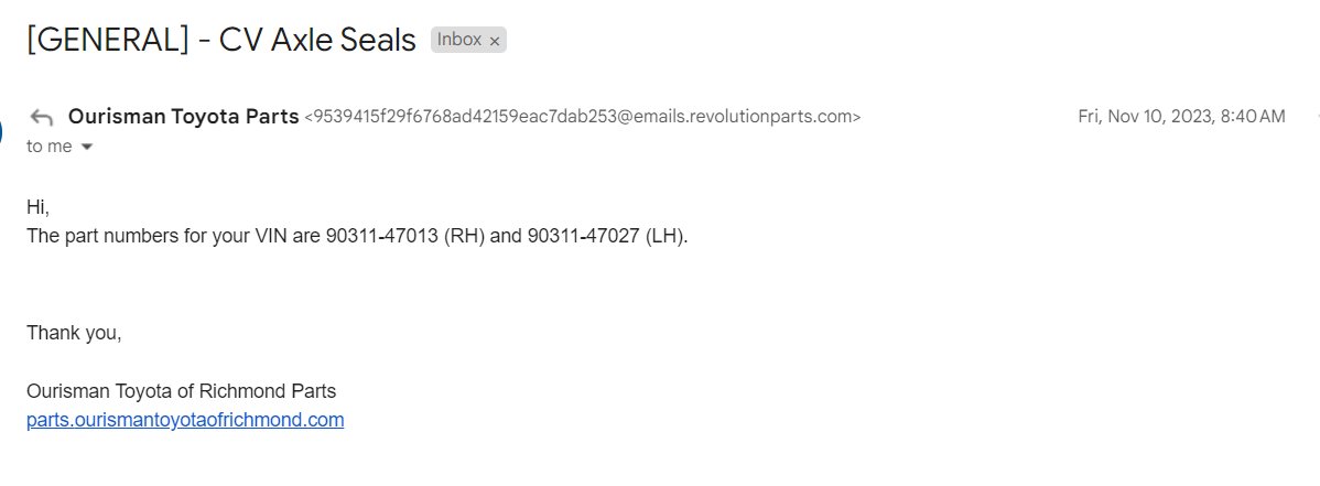

    Ask Ourisman! For my 2004 the answer is:

    That is correct for the oil seals in the front differential side. These part numbers are labeled as 41304P(LH) and 41304P(RH) in this diagram:
    https://eparts-images.toyota.com/431952D.SVG
    41304P (LH) = 90311-47027
    41304P (RH) = 90311-47013
    But I think he was asking about the seals in the knuckle where the CVs mate?
