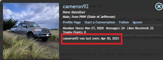

    @cameron92 hasn't logged in for almost 18 months. No clue where he may be...
