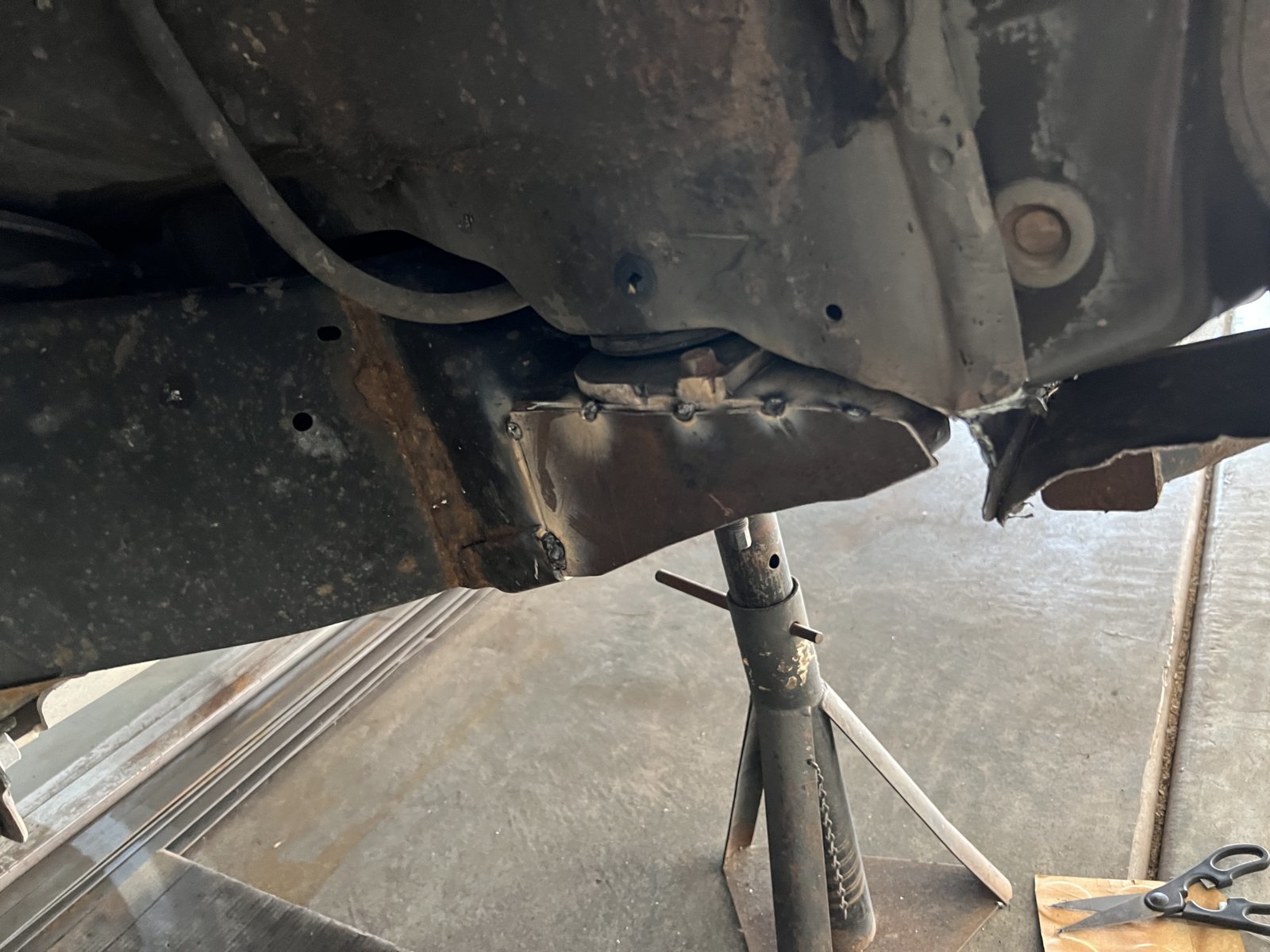

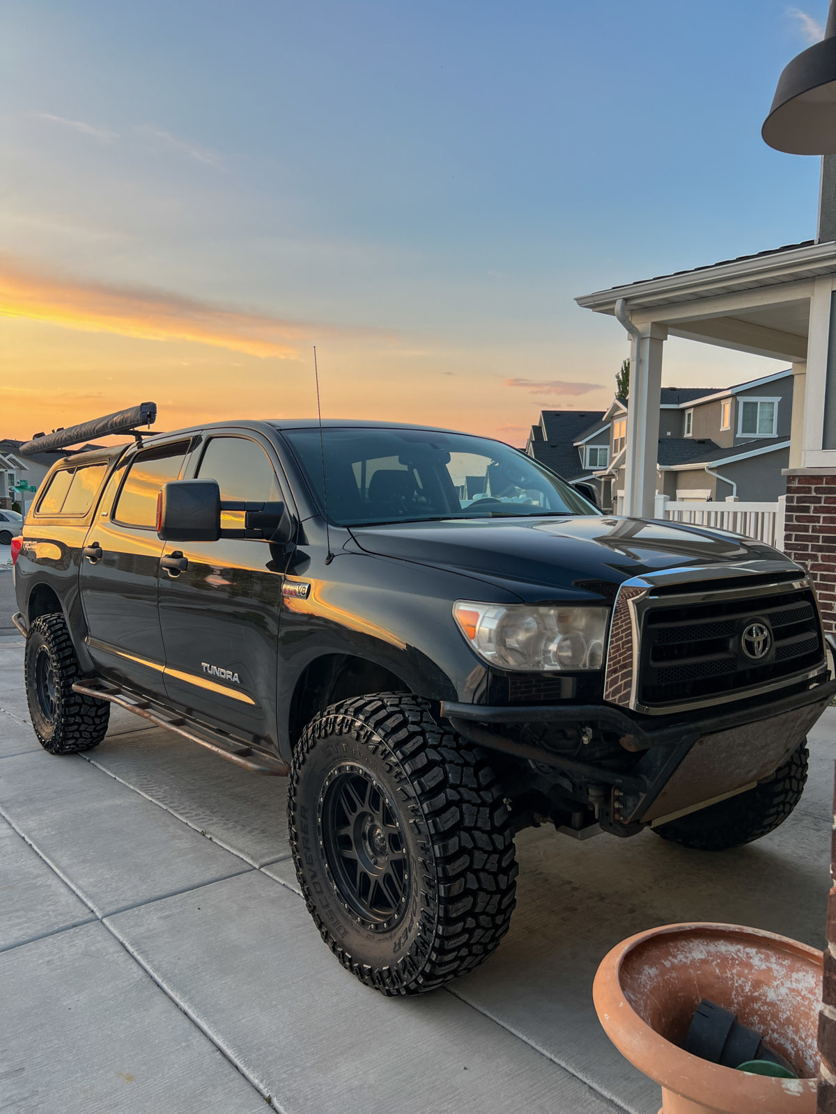

    Earlier this month I got a sidewall tear in one of my tires, but with the tread too worn Discount tire wouldn’t honor the road hazard. So I bit the bullet and bought a new set of tires. Considered 40’s for a long minute but ultimately settled on 38’s.
    Once mounted, I had rubbing issues on my rear body mount, which goes to show how much bigger 38’s truly are compared to 37’s since I never had rubbing issues on 37’s off road.
    With that said, I got to work cutting away a good chunk more off my body mount and making a new cover plate for it with the help of a friend. Got it burned in and it is just barely not enough when I stuff the tire up and turn it. So the next order of business is upgrading my UCA’s to SPC’s and seeing if that gives me the extra bit of adjustment I need in my alignment to clear. If it doesn’t, then I’ll be doing a body mount relocation and for that matter may as well tub the firewall for 40’s
