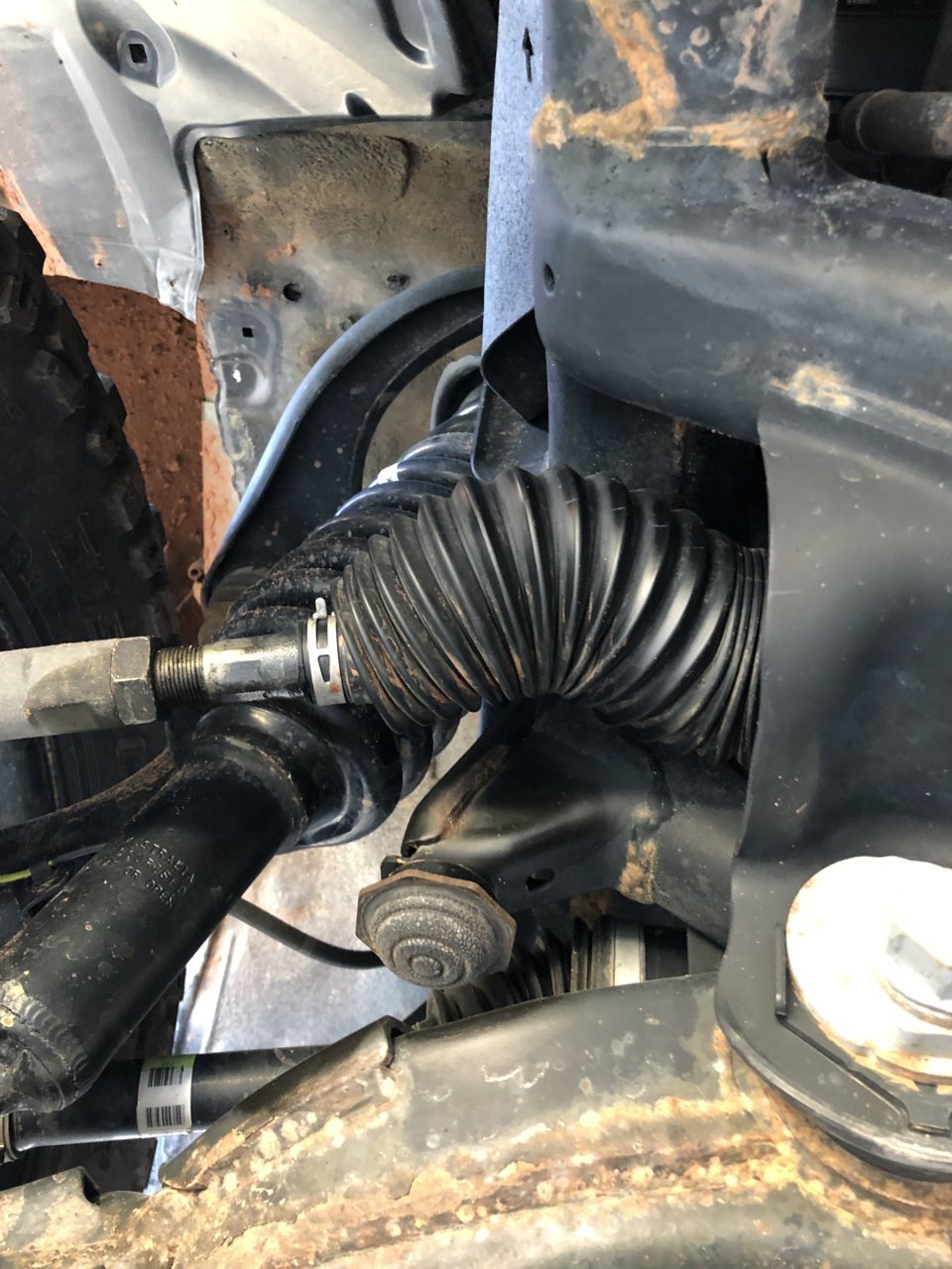

    When I got back home I ordered a steering rack from Rack Doctor as there was countless positive reviews on their warranty and the racks themselves, figured this could happen again so I thought why not. The rack was suppose to ship out within 3 days. That was a total mistake, after I ordered and processed my payment, it was about 4 weeks of back and forth phone calls with the owner as to why my rack hadn't gone out. After two promises of a refund I got my money back and I purchased an OEM rack from the dealership the same day and installed it over the weekend. At the same time, I upgraded to coachbuilder outer tie rods.

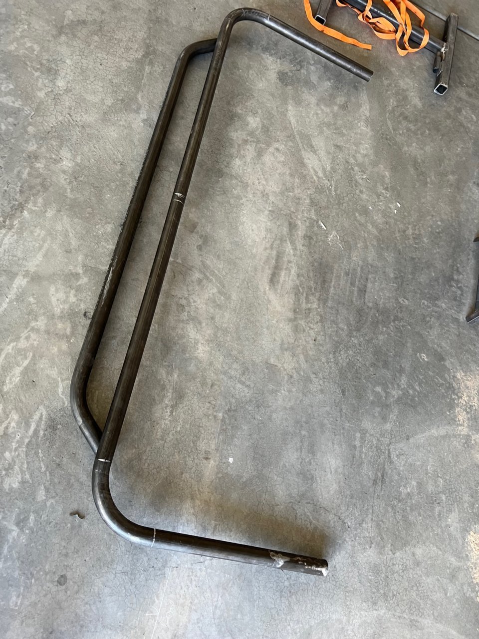

    I always had the intention of building my own bumper because I've not been happy with the offerings for the 2nd Gen Tundra, but I tried to get away with running the stock one as long as I could, but enough was enough. So as soon as I returned back home I took off the factory piece and began building my own design. I call it the Beehive Bumper. trademarked ;) lol

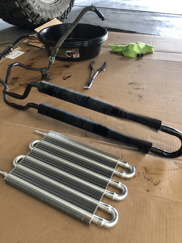

    In addition to the bumper, I had also experienced symptoms of my power steering acting up while on the trail, and realized that going 2 mph for 4 hours, aired down, and continous movement of the steering was overheating my PS fluid. So in addition to the bumper I replaced the factory power steering cooler that sits behind the bumper. I upgraded it to a larger unit with larger surface area and I mounted it directly in front of the condenser. This way it will have air drawn in from the engine fan and also have more direct air access behind the grill.

    I've been wanting to add a bigger PS cooler. You're gonna have to hook me up with the same treatment :D

    I am changing mine out to a heat sink, its a bigger cooling element than stock but still just a dual pass but after seeing beehives setup, I'm second guessing if I made the right choice

    Let’s do it! It was a night and day difference in consistency, especially noticeable when you gotta Austin powers a turn on the rocks.

    You’ll have to let me know how that works out. I wanted the largest surface area to cool down and it also increased my capacity by nearly an additional quart of PS fluid.

    Had some down time after a recent trip to Moab and decided it was time to remove the factory bumper and hitch and make a high clearance bumper.
    Started out with removing the factory bumper cover and my bumper support would be the factory setup, laid out a straight piece of DOM to get an idea of how high it would sit then bent the two top hoops with a full wrap around the bedsides. There was never a question about cutting the bedsides for more clearance, so I chopped off about 8 inches of sheet metal, possibly more. I gave the bumper a dovetail look for a sportier look in my opinion. I added support legs to the wrap around pieces that connect into the bumper supports so the entire bumper is removable and rigid as hell.
    I still need to add side guards that will go above the wrap around pieces but I've not yet been satisfied with my templates, but it gets inspiration from the old Marlin Crawler bumpers but won't be exactly the same. All in all, I've gained a substantial amount of ground clearance and it does not stick out any further than the factory one did, I made sure of that. Will be going back to the testing grounds in Moab later this month for new action shots and R&D.
