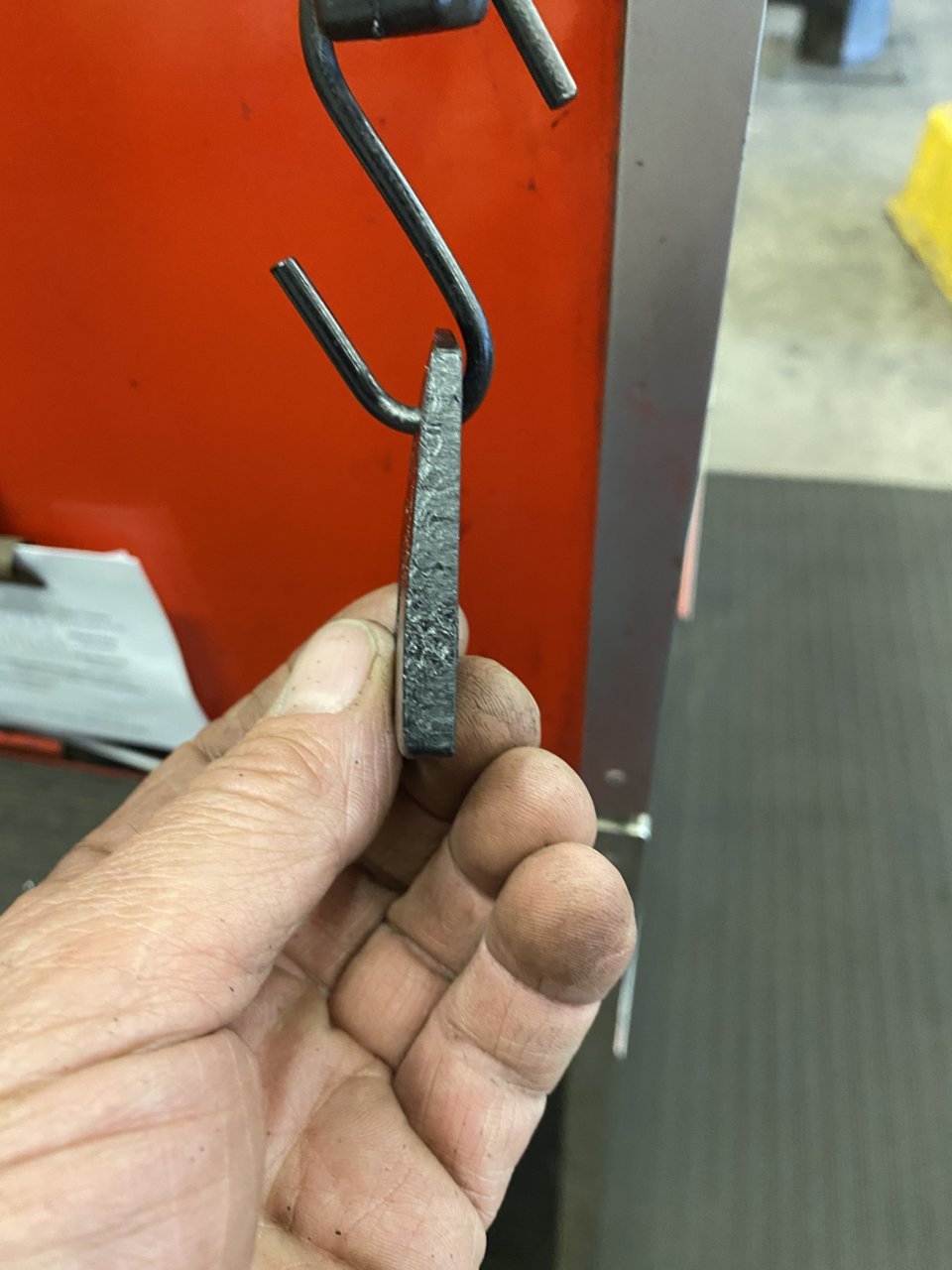

    Ok so I installed the amp bed step and when tucked up it very crooked and I’m OCD so I used the shim they give you and grind it down to a 45 degree and when installed looks a hell of a lot better. Before and after pics.
    clarkritchie likes this.
  9. Apr 2, 2021 at 2:10 AM
    #39
    upsmech
    upsmech New Member
    Dec 5, 2020
    #55718
    35
    I went down to almost nothing on the thin side after this pic but you get the idea.

    Hey man what shim is that ? I got the same issue
