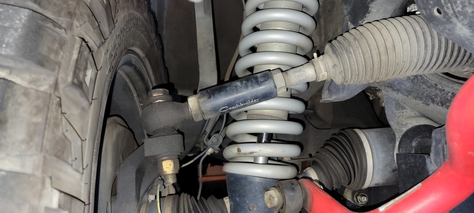

    Hey everyone, I've been looking on this forum for a while for info from time to time and this one hits home for me. I have a 2014 Tundra with the BDS 7 inch lift with Fox coilovers and the Coachbuilders outer tie rod ends. I also have excessive outer tire wear and my tires are shot. I have had it aligned multiple times and it never seems to help. My wheel size is 22x10 -18. Does anyone know if a different brand knuckle for a 7 inch lift will work and maybe that's the main issue of the outer tire wear? I had a Readylift 4 inch lift before this and never had an issue with tire wear...

    I am running a BDS upper control arm with Coachbuilders outer tie rods. I was told today to get my outer tie rods even and not to have a droop and that will help with the toe and should help with the outer tire wear. I have to measure this weekend and get some polyurethane bushings to level the outer tie rods.

    Is that picture with the truck wheels on the ground? Maybe just me, but that CV angle looks steep....

    The truck is flat on the ground and I noticed that as well when I took the pictures last night. I'm not a fan of BDS and I should have went with the Readylift 8 inch in the beginning.
