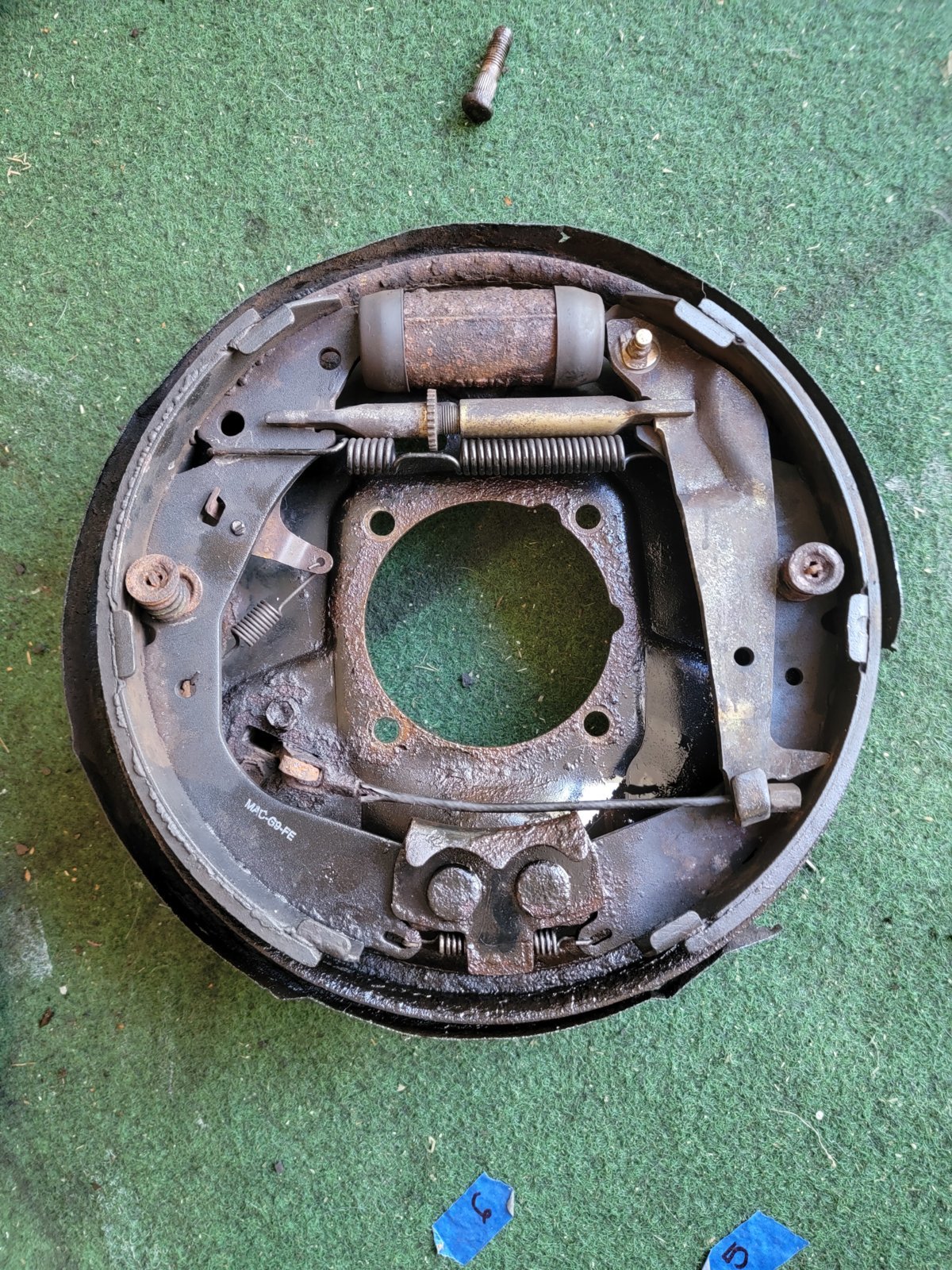

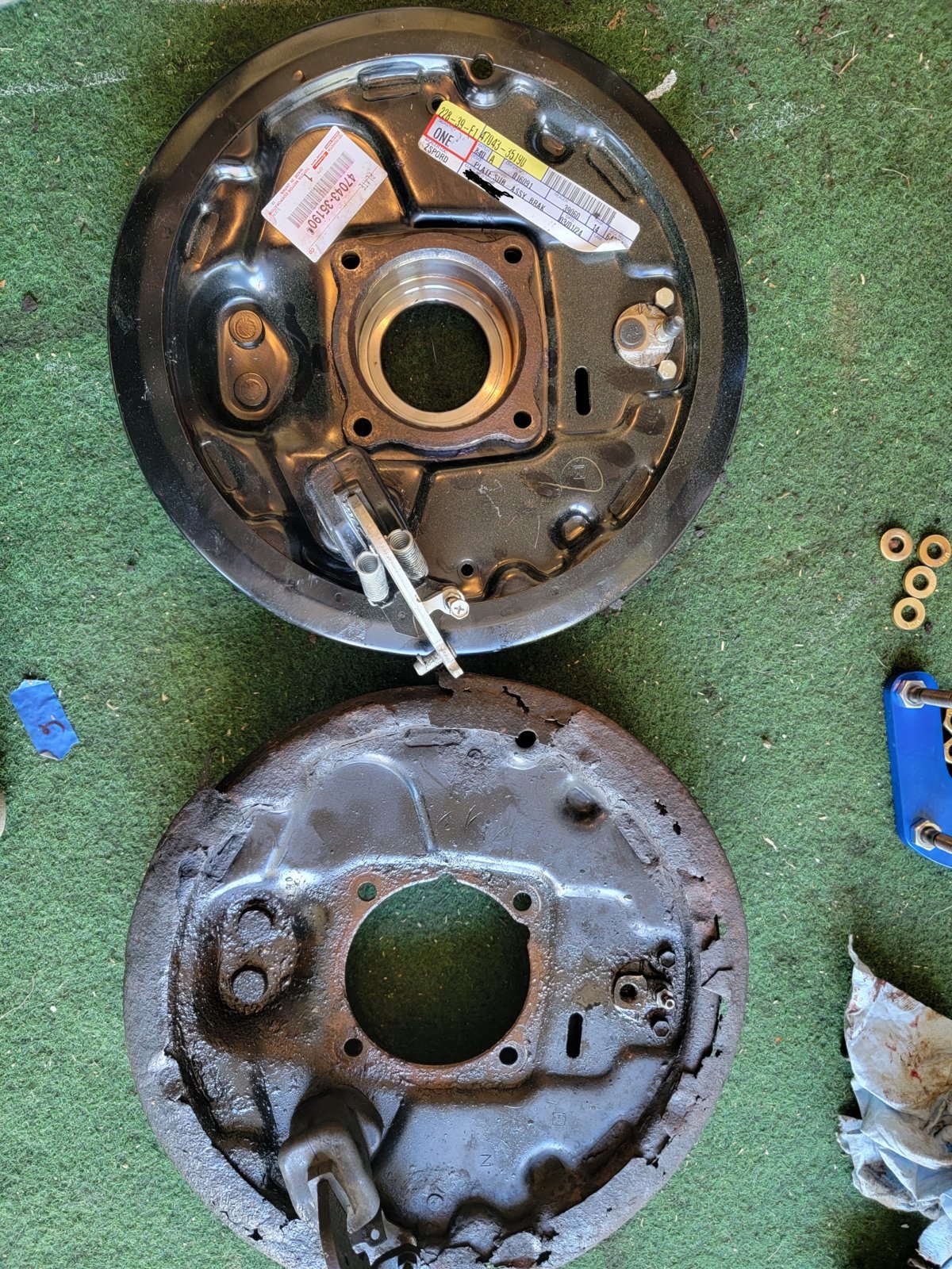

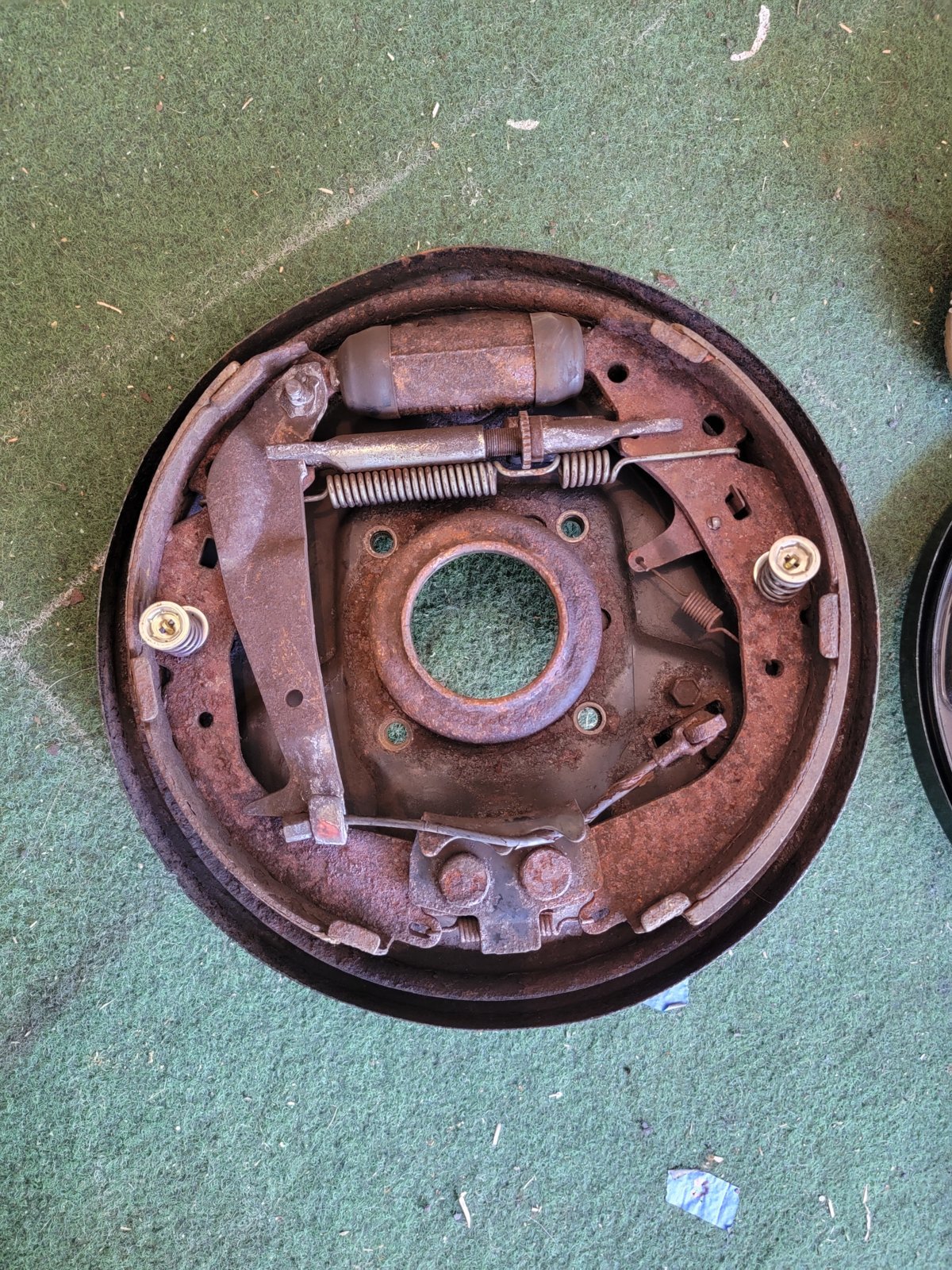

    I finally got to it a week or so ago. Definitely not bad to change out, just didn't want to walk into any sneaky issues if I could help it so I started this thread. Maybe this will help someone in the future or at least answer some questions.

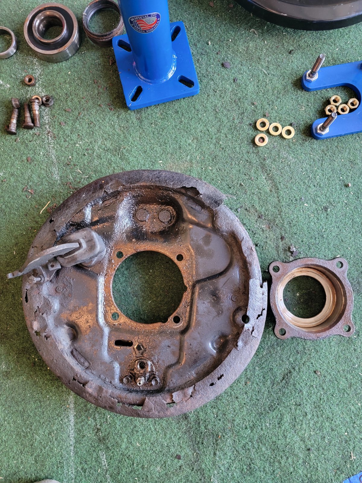

    To change the backing plate, obviously you have to do a number of things; drain the diff, remove the axle shaft, have a press and special adapter or make an adapter to take off the ABS Wheel, remove the spacer, remove the C clamp, press the shaft through to seperate it from the backing plate, remove the other spacer, remove the bearing from the bearing housing then you're pretty much there. Most videos end here online then start the rebuild with a new bearing and seals. If you're replacing the backing plate, this is the final couple steps. The studs that are in the wheel bearing are holding it to the backing plate. Thread a nut onto each of the studs only far enough to get it flush with the top of the bolt inorder to not mushroom the threads. Take a hammer and a brass dowel (preferably) and tap out the bolts. They're grooved or splined, however you'd like to name it, so it'll take some whacks. Onces the bolts are out you should be able to knock out the bearing housing or it might just fall out. Then reverse for install.
    Wayyy easy. I started this project with fixing my parking break and ended up replacing all axle seals, break hardware, shoes, plates, drums and of course some fresh 85w-90 gear oil. Took two days from start to finish working most of the day on it.
